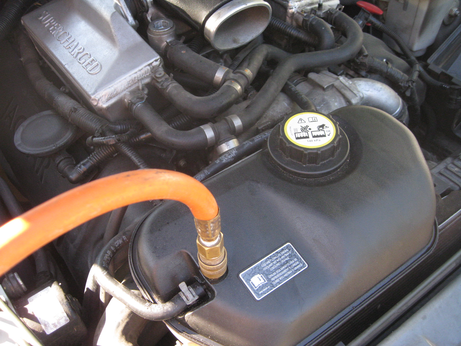

Then I pressurized the water system by removing the threaded bleed plug in the top of the header tank and installed a threaded hose disconnect. I pressurized the coolant system, and the coolant started dripping again. I looked up close with a light and mirror, all around the area above and around the water pump. There is so much crap in the area that there is not very good visibility.

I used a standard pneumatic male x male quick disconnect fitting wrapped with Teflon tape.
I was careful to tighten it by hand so I wouldn't strip the plastic threads in the header tank. (Threads are different pitch, the fitting being NPT). It leaked a little air, but my compressor supplies way more than leaks. Be careful not to put in too much pressure.
