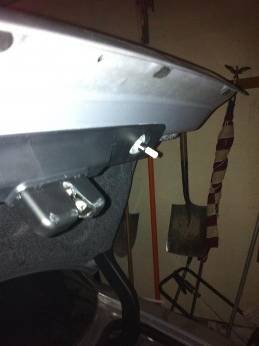

Originally Posted by Kapitan1975
Hi George
i have this problem, just pop up this afternoon.
my trunk warning light kept on lighting up (mentioning open trunk) is there a sensor somewhere? or where the pin switch is at.
thanks
Pin switch is on the trunk lid itself, on the right side of the bottom edge. It will be fairly obvious when you open the trunk, but here's a pic. It shows ground when trunk is open, open circuit when it's not.
HI George
i dont think My 05 STR have this pin by the trunk latch.
could it be a different model?
According to the wiring diagrams, it has a rear trunk ajar switch which connect to the rear electronics module. Look around the trunk edge they may have moved the pin switch in the later years.
