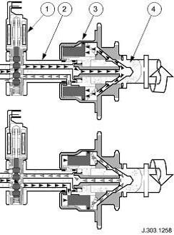

If one assumes camshaft timing is correct, based on DTCs P1386 and P1388, it would appear the VVT mechanisms may be clogged, or not operating correctly.
A diagram of the mechanism is below along with an explanation of how it functions.

Thank you NBCat!!! I printed it and will give it to my dad during intermission
