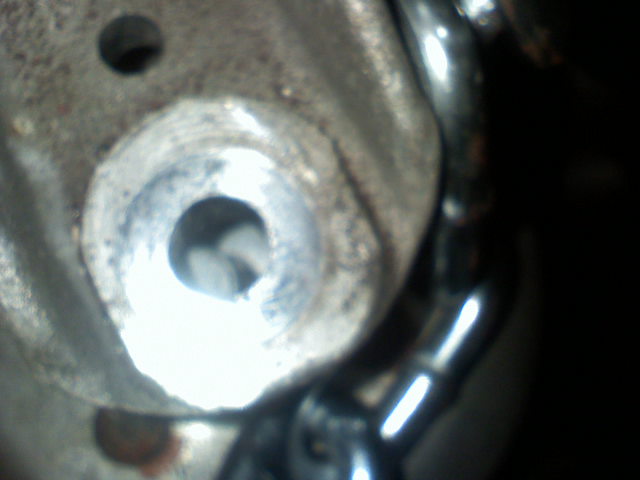

ok guys so I lifted the engine up but now I cant realine one of the engine mounting brackets on the stud. the bracket is resting on top ot the stud but I can see half of the stud through the bracket hole. Can any body give me an idea how I can get it down? I lifted it back up but still having a hard time getting it right on.
The mountings are flexible, you will need to use a lever of some kind to pull it into line.

Use a pry bar to push it over and do not get your hands or fingers anywhere close to it no matter how much you think you can just reach up and push it over...youll loose a finger
