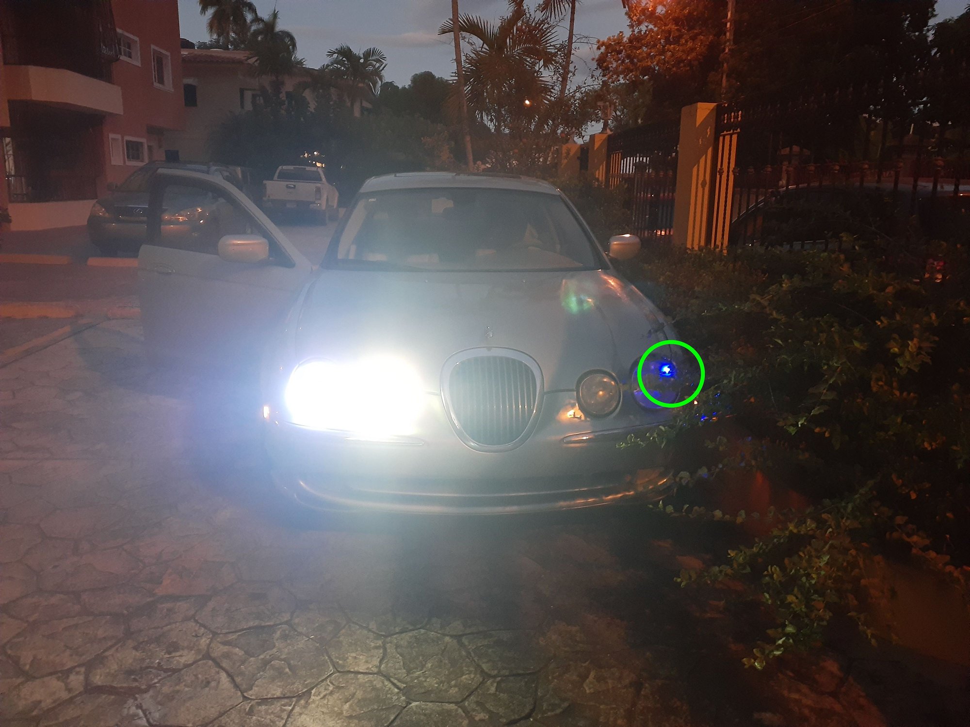

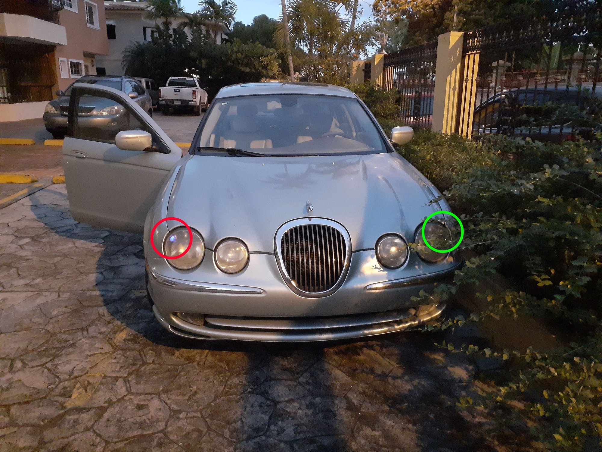

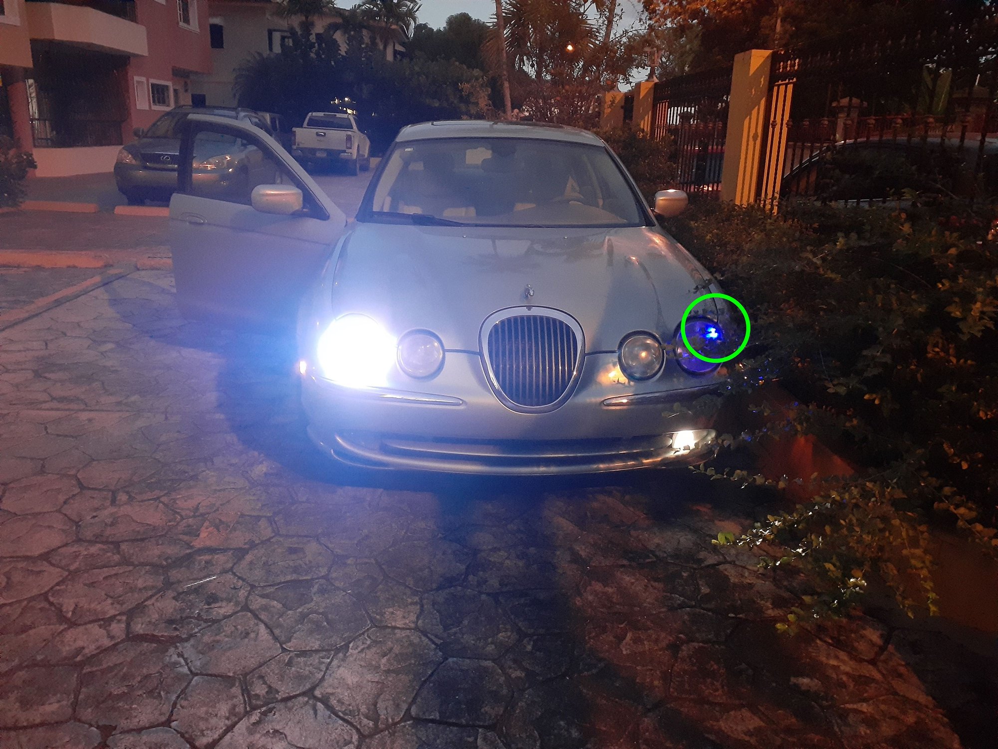

3- There's a little bulb in both low headlamps, when i turn on the low ligh and fog light that little bulb turns on (Green circle) that's normal (left side lamps not working)
Turn on low and high light, fog lights turn off and little bulb still on (green circle) still normal
when i turn all lights off, the little bulb on the green circle turns off too but the one on the red circle stays on and does not shut off unless i disconect the battery.

those are parking lights. Access them on top of the headlights. When lights are on, they are supposed to be on.
these cars had been provided halogen regular bulbs and when you put leds there and switch off the car, the electrical system is still alive for like an hour, and you can see them glow, cause leds are using very little energy, so whats left, is visible.
now the green led isnt glowing because it's most likely broken and has formed an electrical resistance on its circuit and eats the energy..
Put new w5w halogens or leds. I personally use leds cause i like the modern look

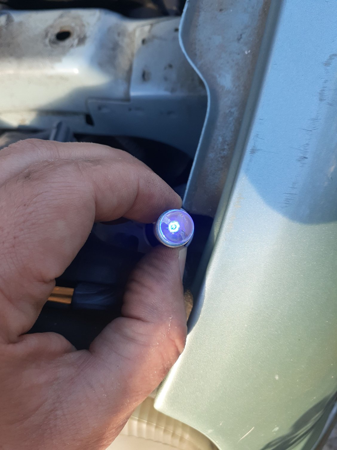

I will check them to see if they are LEDs, makes sense what you are telling me and the blue ligh in them give it away. From what i remember my dad didn't change any bulbs to LED, just high and low bulbs to xenon, so this will surprise me if he did change those parking bulbs to LED
Thanks, let you know later

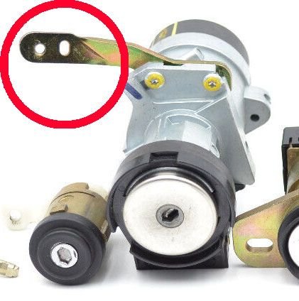

https://drive.google.com/file/d/1dWq...4H&ts=63b84dd1. This tsb shows how to get the key barrel out and back in. I have done this myself. You still have to get the ignition switch out to work with. Is your ignition switch in the column or dash. Dash is harder but i know a shortcut

the easy way to get the switch free is remove the lower cowl cover on the column. Then reach your hand in there on the top of the ignition switch and pull down sharply to release it from the clips. From there you can wiggle it out enough to unplug the big eletrical connector. Then you can bring it out some more and follow the tsb. No need to mess with the interlock cable. Oh yeah. Disconnect the neg battery cable and gently remove the plastic cover ring around the switch. When you reinstall the switch get it oriented with the key slot vertical. You will feel the bottom line up with the holding tabs and the snap it in at the top. It will only go in one way

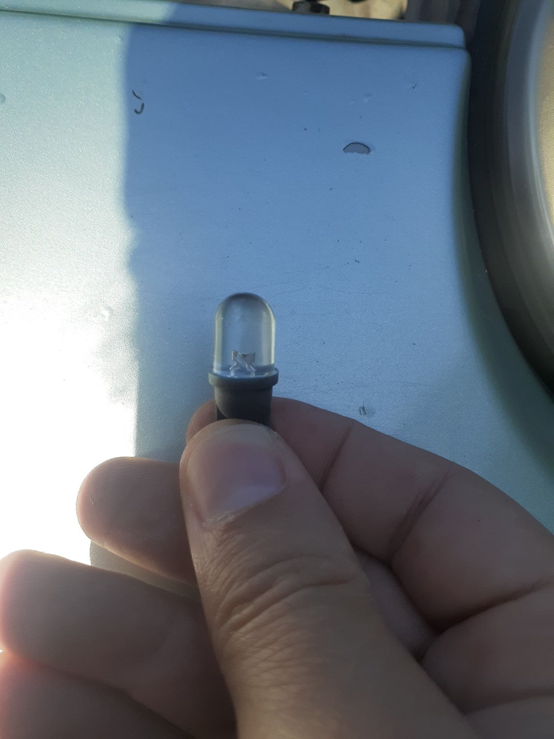

well, they are defenitly LED bulbs, change them from there original position and the "problem" follows the bulb, so, the bulb that was shutting off is not working as @eldariusvargas mention. i see that the contacts of the bulb are a bit dirty, don't know if that makes a diference but i will clean it and see what happens, if the problem is the same i will change them.
While i was checking that bulb, i try to find if there was something disconnet from the low and high Xenon light (everything looks normal) i moved both bulbs trying to take them out and the chrome reflective part inside both headlamps moved as they where loose or broken. is that normal?

I was practicing taking the key barriel out and in with the one i want to put back in the car (the original one), and i notice that there's a tab (photo stolen from ebay, see red circle) and seems like this part is not hold by clips, i think there's a screw that goes in that tab and hold it in position, correct me if i'm wrong. wanted to check it this weekend but had an emergency with my dog.

Any bulb that has black like yours does is due for replacement!
That bulb has many,many hours on it to turn the glass black like that.

No the glass isn't black as it seems in the first photo, the glass of that bulb is like a magnifier and what you see as burn is a shadow reflecting in the tip of the bulb. but still i will change both
