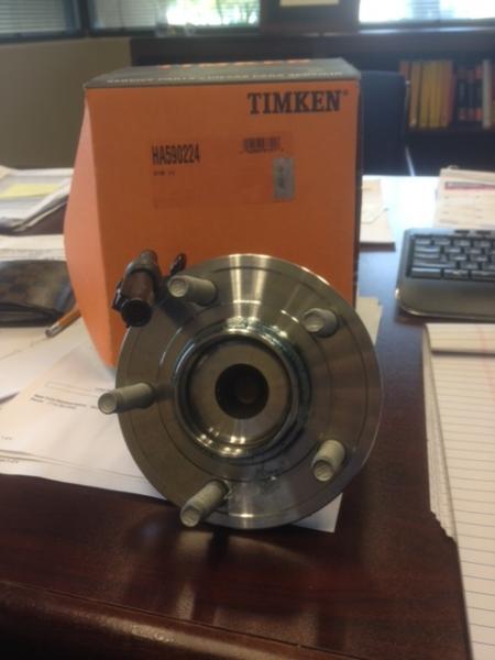

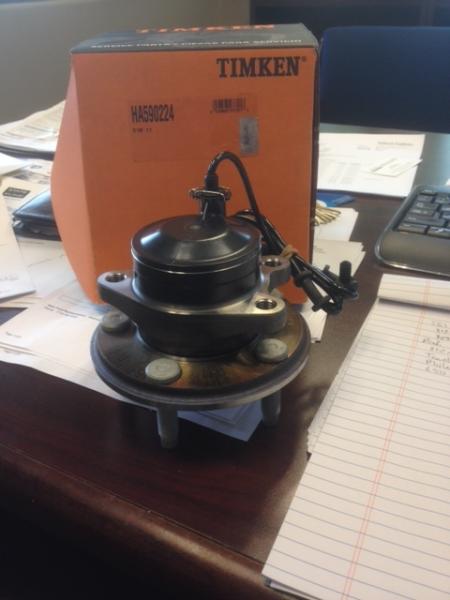

got the parts.... I'm going to try to work on it tonight after work.. Here's the part... BTW, I got the part for $113 shipped from Rock Auto. The local Autozone wanted $180+tax.

I would have bought the Timken bearing one since Timken. Moog, TRW. make high quality suspension and bearing pieces.

yup, I got the timken one. It looks nice.
