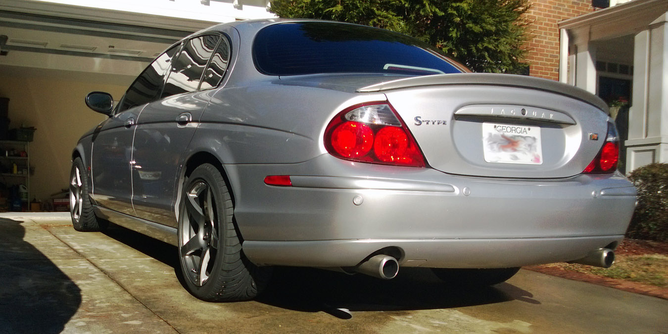

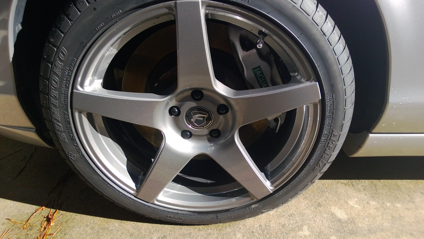

Hey guys,
Purchased my STR in January and it came with some nasty chrome 19" wheels running 235 tires on all 4 corners. I wasn't able to locate stock STR wheels quickly so I went ahead and ordered Forgestars like a few other members have here.
Overall, I am extremely satisfied with the fitment and they really improved the look of the car. No rubbing, flush with the fenders without going past (I think 295 could work on the back). Contact jurrian@modbargains.com and he will be able to get you what you need. From order to arrival was only 4 weeks (I think the norm is 6+ weeks).
I'll throw some real pictures up when work slows down and the car gets a full detail. Unfortunately these are just phone pics during the worst time of day where the sun is glaring. They still should give you a good idea of what to expect with these wheels.
Wheels: Forgestar CF5 Glossy Gunmetal -18x8.5 front and 18x10 rear
Tires: Sumitomo HTRZ II - 245/40/18 and 285/35/18
I'll probably put H&R springs on at some point, but first I've got transmission fluid, fix passenger rear water leak (clogged drain that I can't seem to find!), spark plugs, and less dusty brake pads. Currently it has limo tint...that will go eventually, but I have gotten used to it. I also need to locate an under-shield...my car didn't come with one.
Pictures don't do these justice. If you like a meaty tire, 18's are perfect for this car.

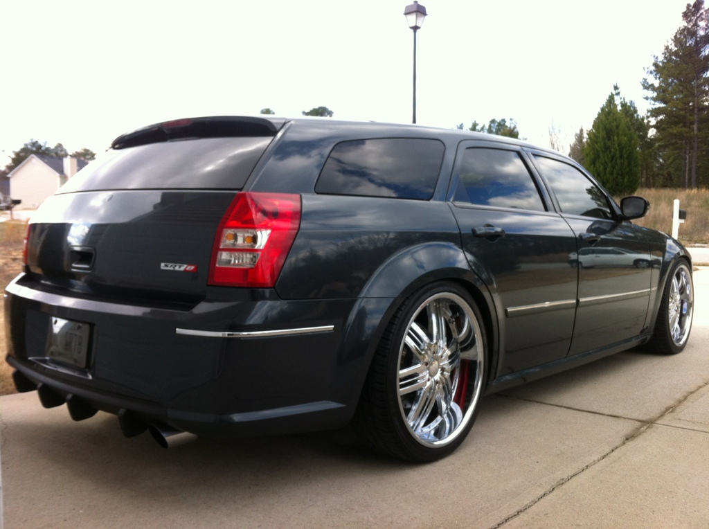

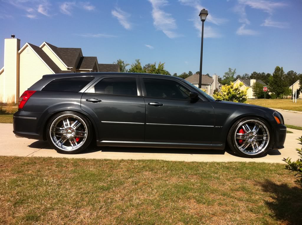

I always check for Eibach first because its a brand i've used on past vehicles and presently on my MSRT8 right now and I just trust the brand. Michael Star, your car looks great and if thats the drop that H&R will produce then that will work fine for me. The photo is of a 3 inch drop on my SRT8, it tucks under the fenders slightly when parked, but much more when driving. Nothing looks better than a lowered stance on an already awesome car and can't wait to pick me up a STR and get started. I found a 03 in my area, but the price was @ $15k and i've seen them much lower than that so i'm still looking.

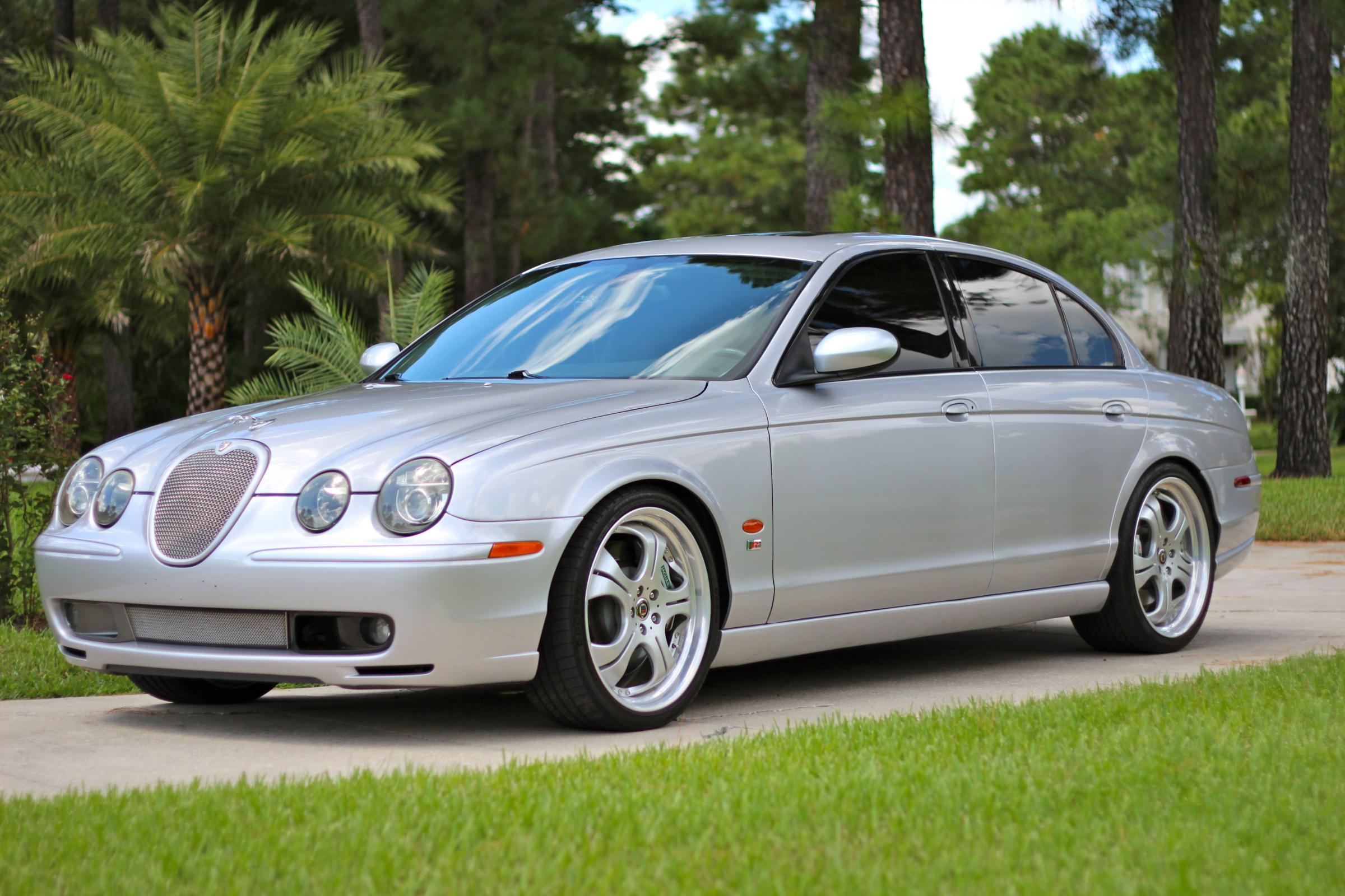

Mine are with Arden springs, and the same goes for me, the ride is not hard at all. Plus I'm running 20's

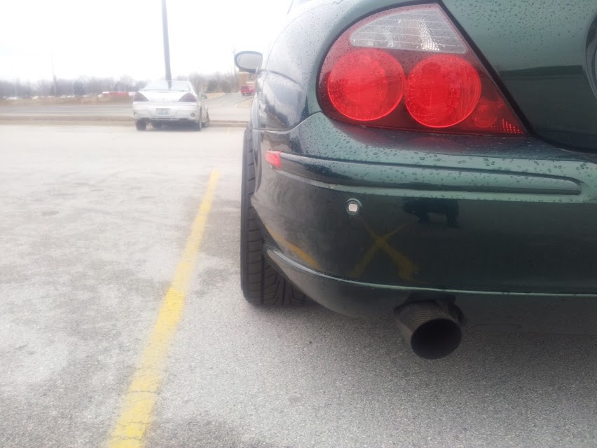

Problem is, the 19x9.5 is ET25, and the 20x10 is ET45, which imo, is not positive enough for an STR in the rear, combined with a spacer, they stick out a lot, I asked michael star about his 20x10 hornets in the rear... fender clearance is not good at all, he reports having to roll and still on going rubbing/damage issues

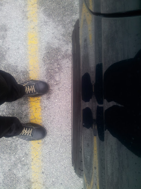

I just took some pics of it.
This is how far it sticks out
Not much clearance for the brakes with the spacers
They do stick out a bit don't they?
