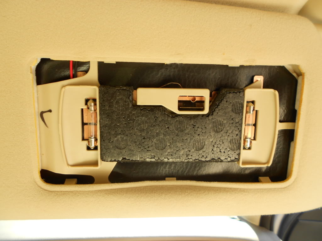

If you need to just change out a vanity light bulb. Gently pry out assembly from visor as shown to gain access to bulbs.

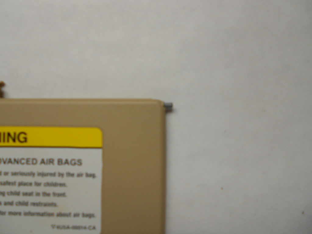

To answer my own question… yes, the 1/8"x3/8" stainless steel dowel pins sold at Amazon are a real timesaver. With all due respect to JoycesJag and John89, I took the lazy route and bought the precut pins, which worked perfectly.
The pins come in a pack of 10 for $8 inc shipping and they're the exact size needed for this job. True, I now have 9 spare dowel pins, but I own 3 S-types and another of them looks like it will need this fix sometime soon, so I don't think they'll go to waste.
I scuffed up one end of the pin with sand paper before gluing it into the hole I drilled where the broken pin had been. And I used the same Devcon epoxy that Rick used, which works on both metal and plastic, sets up quickly and completely cures in 24 hours.
While I had the mirror frame out of the car, I also took the opportunity to repair the crack it had in the same location as Rick's pic #10. Crazy Glue worked great here - I held the frame while my helper dropped a dab of glue in the crack, then I simply squeezed real hard to close the seam for about 2 minutes and...Voila! Crack is fixed.
Many thanks again to JoycesJag for posting the tutorial for this fix, and to Jon89 for his suggestions too. And thanks to RizwanSharp for the original link to the dowel pins on Amazon, which as of this date is still active. Best 8 bucks I ever spent, as my wife is a happy camper again
