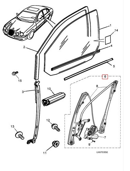

trying to locate the adjusting screw on window regulator for 2006 Stype passenger front door. VIN N58006. youtube video for XK8 show a totally different door panel than mine.
Old Oct 15, 2017 | 09:28 AM
Welcome to the forum epinc,
YES - the XK8/XKR regulator is a completely different design. Here's the diagram for the S-Type regulator from the Parts Catalogue which may help identify the screw you need:

Thank you, GGG, for the diagram of the parts. That is what my 2006 SType regulator does in fact look like. However, I can't find any place for an adjustment to the travel of the window glass, nor an accompanying access hole. I thought there would be some type of tensioner wheel for the wire that runs in the metal channels, but I don't see any. It appears the window glass is seated as far down in the glass holders as is possible. Any further thoughts?

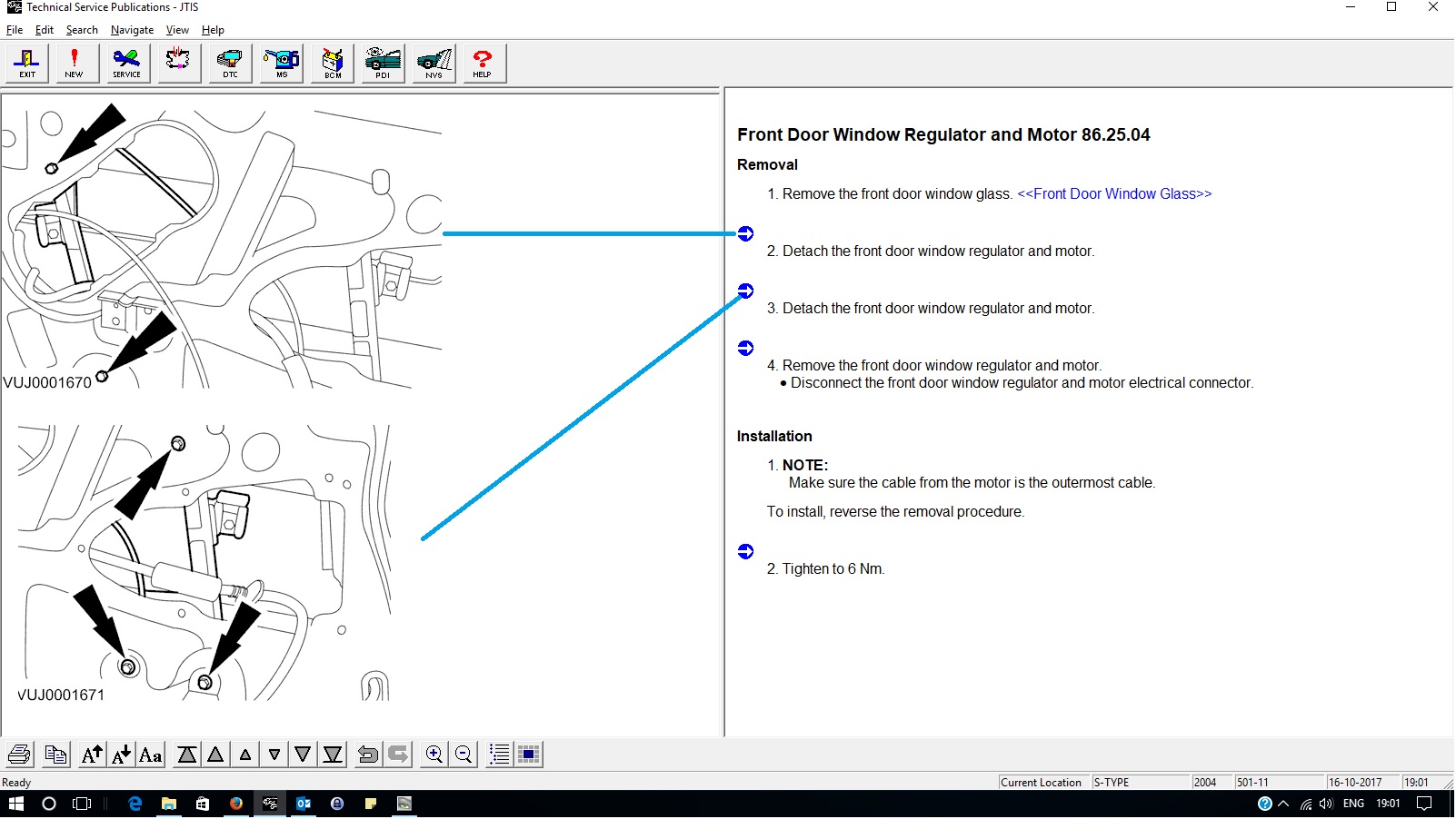

I don't think there is any adjustment, what problem do you have?
Old Oct 16, 2017 | 01:08 PM
The regulator Removal/Installation procedure in JTIS (Jaguar Technical Information System) makes no mention of any adjustment:

There is no adjustment to the mechanism. If the window is not fully closing, or fully opening, the regulator most likely needs to be replaced.
