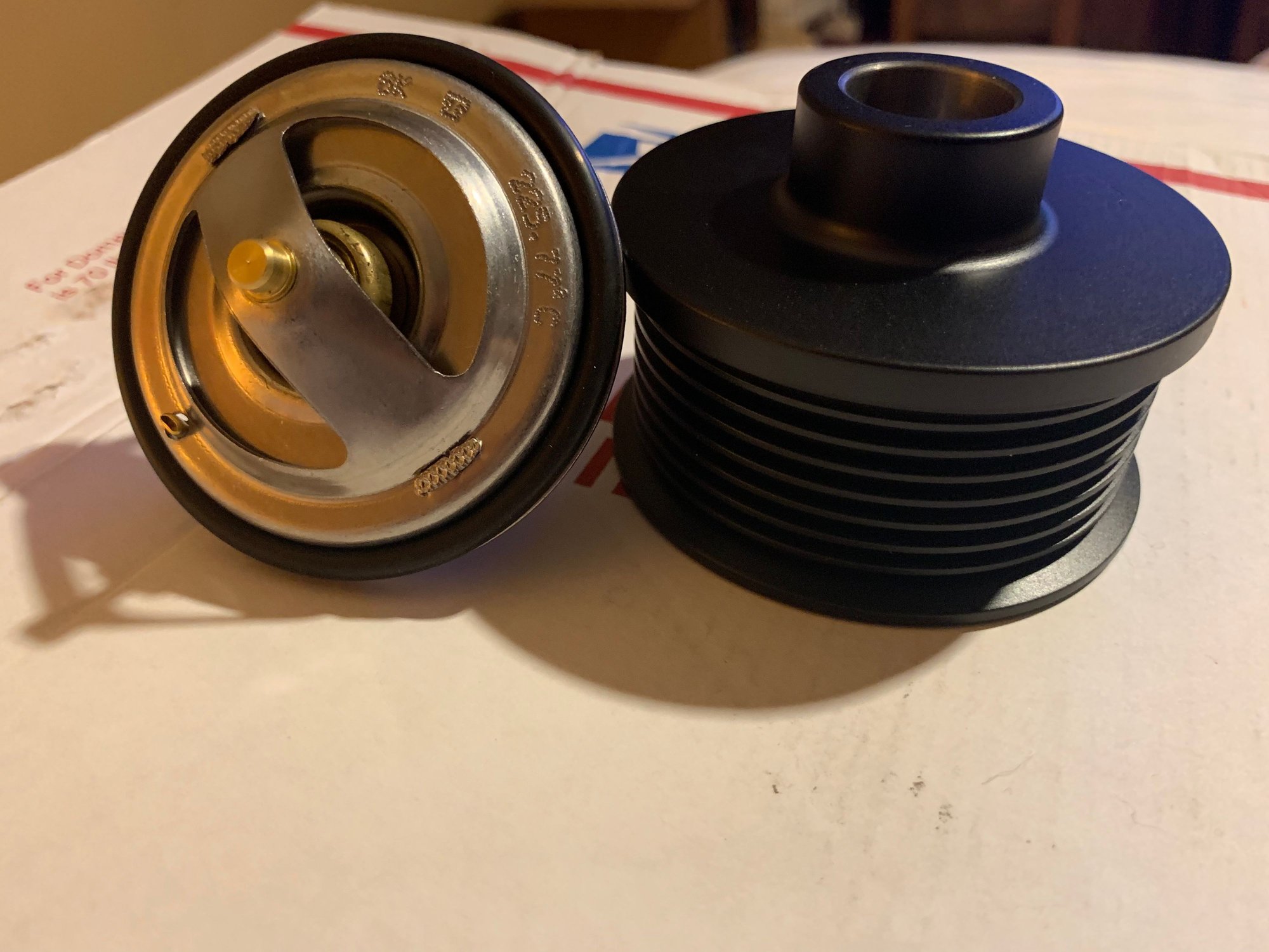

Just got my 1.5 pulley today! Cant wait to install. I will do this as I change out my leaking hose!!
oh ya, I ordered a low temp thermostat to try and keep the heat down. We shall see.

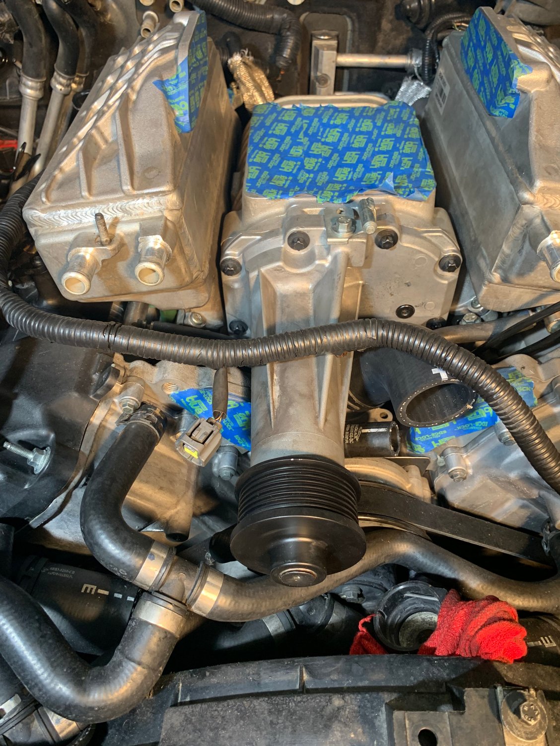

Gotthe pulley installed. Just mounted the blower after changing its oil. Lets hope it runs!
