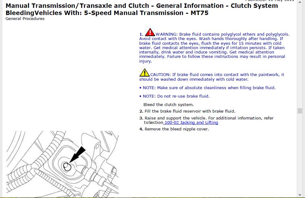

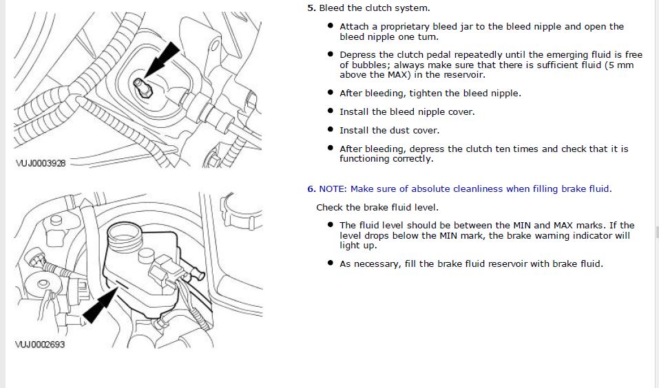

Attached is the bleeding instructions for the 5 speed. Since you had shifting problems before I suspect the master cylinder is on the way out.
