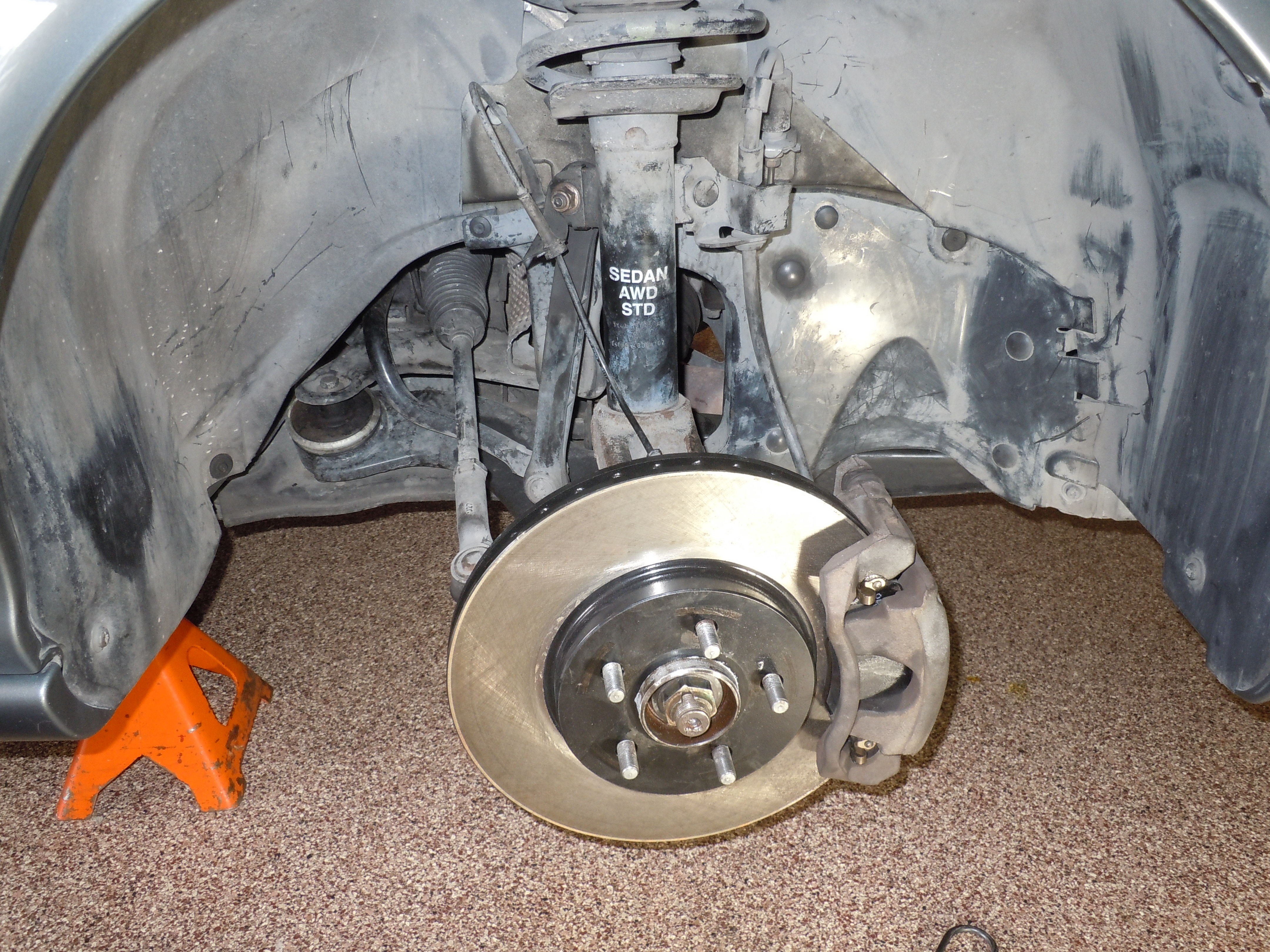

I had nearly the same thing happen to me a month ago, with difference only that engine would not crank. New battery solved my problem. Pull your battery out and take it to Interstate Battery or Sears to have it checked. When you've verified good battery power then get a scan tool to check for OBD codes. Your comment about "some noise from right side" may point to a mechanical problem with the serpentine belt area. To get to that you'll need to put the car up, remove RF wheel, then the access panel in the wheel well. You'll need a special thin serpentine tensioner wrench (Northern Tool, about $20) to get the belt off; there's not enough room for a 3/8" drive ratchet or breaker bar.
