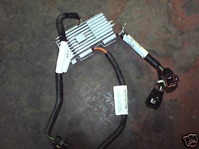

My Problem is comming again, the fan working 10sec and off then 10sec on, the air conditioner doesnt works.
Probably i need this part (cooling fan module) are the fan modules all the same for the x-type 2001-2007 ?:

i hope changing of the cooling fan module fix this problem. What are you think?

of course i did it, jaguar machanics says its probably the fan module....but this people are not always in right

i cannot remove the one fan connector because this hose disturb.
I need to remove this hose or is there a another solution?

whats the part number for the module? Apparently jaguar does not make the module anymore and modified the system so yoiu have to replace the fans also to put in the new fan system. so i found a salvage yard also and need to verify the part number.

i hope i fixed my problem with a 70€ ebay used item. No problems after one Day drive.
