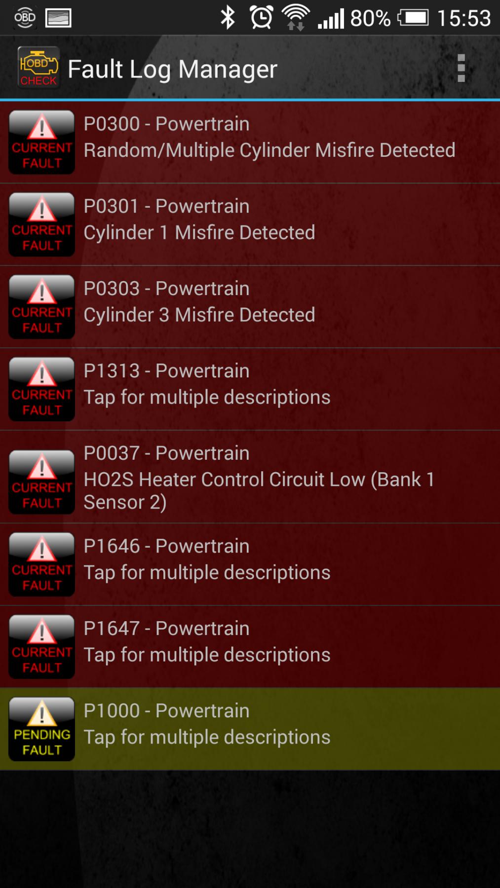

Hi all, lots of fault codes as you can see and a lack of power 0-60 in 15 secs, this is the 2.5 Indianapolis. Also a complete loss off power at 3500rpm, only seems to do this in third and forth gear when the engines hot. I imagine not all these fault codes are the issue but one of them is causing the problem and making them all show up?

Chris, humor me. Access the #1 and #3 coils and check in the plug wells. I am betting you are going to find a little bit of oil down in those plug wells. With the coils removed, spray a little bit of Isopropyl Alcohol into the coil pack (where the plug attaches) and clean off the plug of any oil. Clean out all the oil from the plug well too. I am betting that your problem goes away.
Since you are in that far, probably a good idea to pull the plug out just to look at the end to make sure that nothing else is going on (end of the electrode damaged, wrong gap, etc).
With the plug cleaning, all these problems should go away as they are all related to excessive misfiring of the engine. Clear the codes and see what happens after the plug wells have been cleaned.

I have replaced all the plugs and if I remeber correctly there was oil in a couple of the wells. I didn't check in the coils ,will do it after work tomorrow.

If there is engine oil present in the spark plug wells, the spark plug boss seal and cam cover gasket must be replaced or oil fouling will short the coils.
