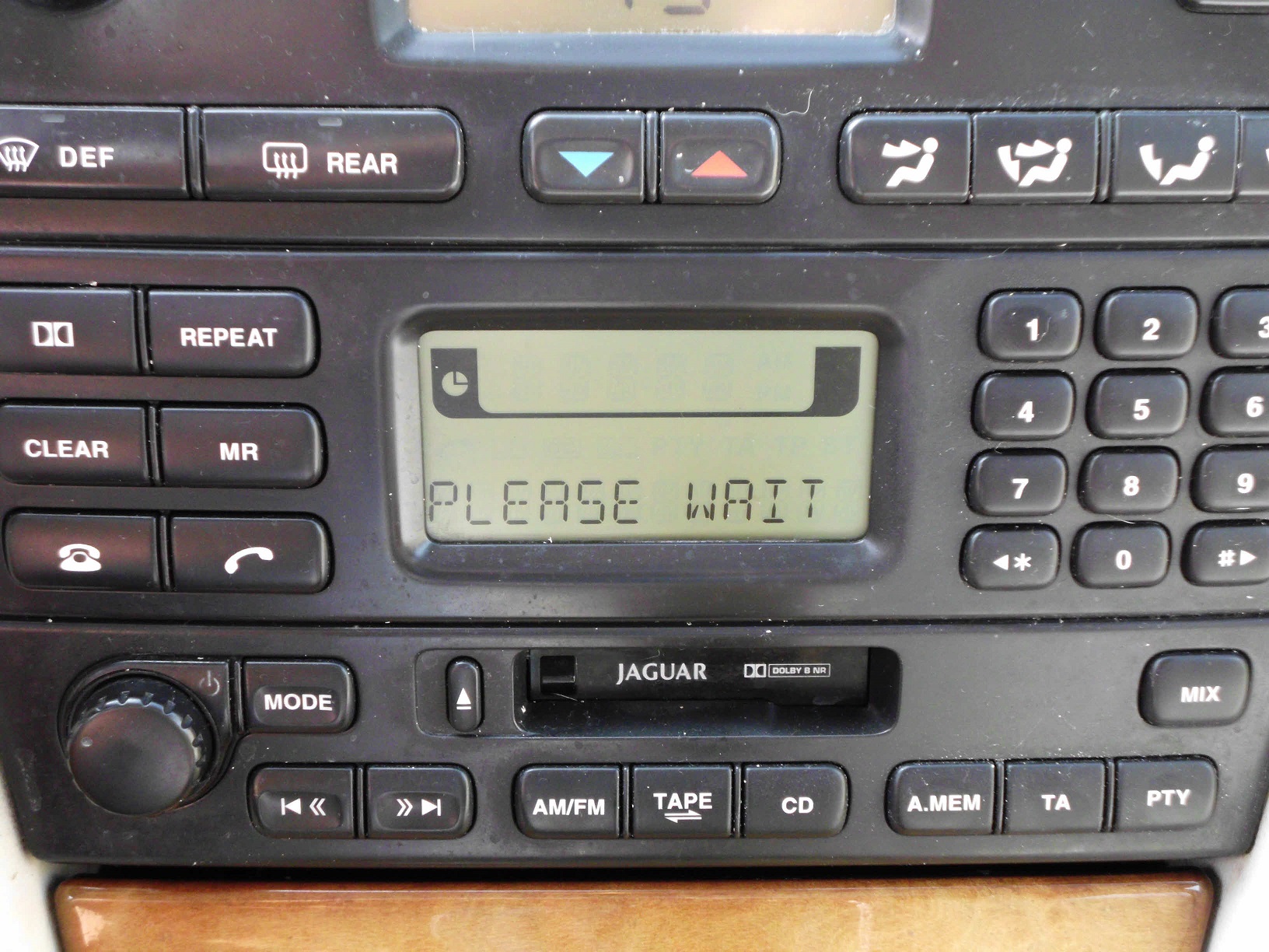

Disconnected Neg(-) terminal on battery to replace front seats. After doing work on one seat reconnected battery, restarted car and turned car around to get to other seat (I have a small garage and could only work one seat at a time - one side too close to garage wall to work) and last time reconnecting battery got "Please Wait" on radio LCD screen. I did not pay attention to radio between seat replacement so it may have asked me for "CODE" after reattaching battery the first time.
Attachment 92242
Waited 10 mins with car running - "Please Wait" does not go away - any ideas here?

Pretty sure this Jag was built for USA and not sure this is the answer - will try leaving on for 30 mins.
Have tried the Press the [A.MEM], [>>] and [PTY] keys simultaneously. This should reset the radio back to factory to no avail, not sure if this only works when the "CODE" entry is displayed on the LCD.
I just bought this Jag a few weeks ago and do not have the radio codes - may have to call a Jag dealer in the end....
*** RESOLVED ****
Restarted car and waited until "CODE" was displayed. Pressed and held down the [A.MEM], [>>] and [PTY] keys simultaneously for a few seconds and display changed to "WELCOME". All presets were back just like nothing had occurred - go figure. :icon_dance-twist:

Strange, but if it happens again:
Reconnect, Enter any 4-digit code 3 times so that the display shows "PLEASE WAIT", like yours does now.
THEN simultaneously press ">>" + "PTY" + "A.MEM" and hold them for 2 or 3 seconds and the radio should turn on.
