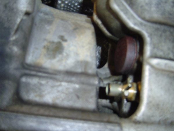

X2004, if I remember right, the 02-03 (and early 04) transfer cases have a bulbous tail where the output shaft for the rear axle is vice having a much narrower tail shaft in the same spot for the 2004.25 and newer vehicles. It seems to me that there is also a difference in the spacing where the drain hole is between the earlier and later style transfer cases.
This picture is of an 03 transfer case. The 04+ as I recall have a bit more open hole there for you to work in.
Attached Thumbnails Transfer case-1-thermo-2759-albums-general-pics-32-picture-transfer-case-valve-upgrade-if-you-havent-done-your.jpg
