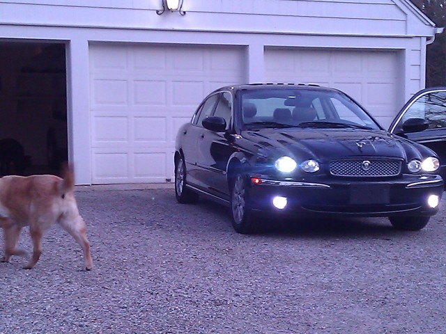

dennis black Jun 8, 2012 06:19 PM
1 Attachment(s)
i run 87 octane since i bought the car ...it runs mint in my x
Attachment 164012
