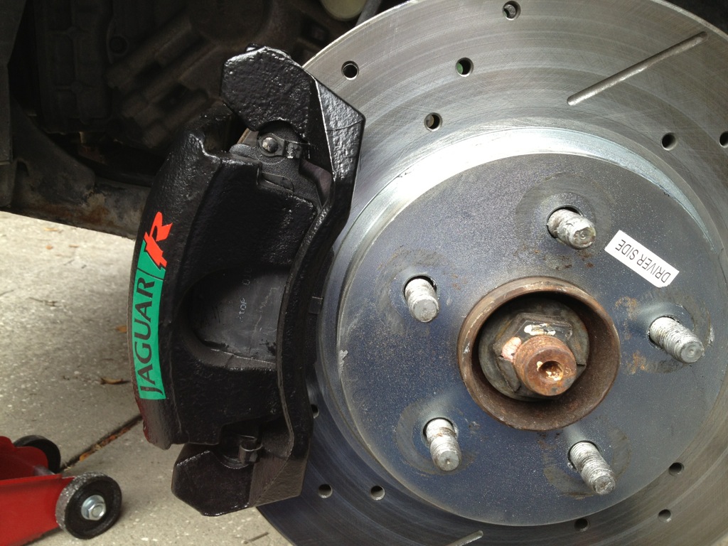

I've posted these before, but this is what mine look like. I pained the calipers with a kit I bough off eBay. If you do the same use a better brush. I was constantly pulling loose pieces of brush off the wet paint! The decals I found on eBay also.

Wow those calipers look good, did you label the rotors yourself? I need to get some for the X Type also, I bought an ebay setup last summer for my Maxima, night and day brake feel.

Here... http://www.ebay.com/itm/Jaguar-Type-...item2c6a6baf83
These are the ones I bought. They go on very easily, and it's been almost 5 months and they are still looking like new.

Just re-read your post. No, the rotors come labeled.

No problem, thanks for the caliper stickers.

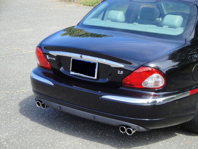

my stock brakes are perfect ...no dust saved my butt a few times\
