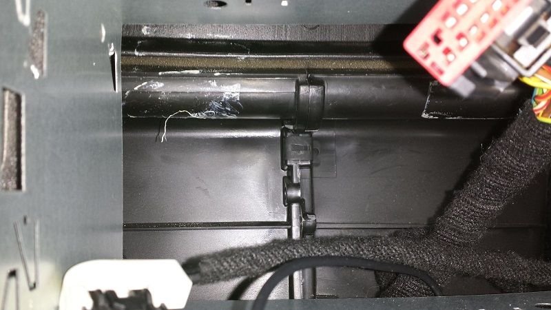

Hi,
I have a 2004 2lt diesel saloon with dials for the aircon, tried to retrofit a double din stereo to find there is a aircon/heater blower duct in the way so the stereo sticks out of the dash by about 2 inches.
Is it posible to modify this duct to accomodate my stereo?
