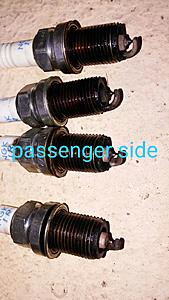

The very first thing I noticed was a misfire. Didn't have a scanner with me at this point. I checked the spark plugs and found them to be dirty and changed them to rule them out. Bought premium Denzo plugs $70 and pocket scanner 100$. Changed plugs. Cleared codes. Started engine.
The problem persisted- p0171 bank 1 lean, P0305 cyl 5 misfire, p0316 misfire within first 1000 revs. + RESTRICTED PERFORMANCE @ 4K RPMS WOT
