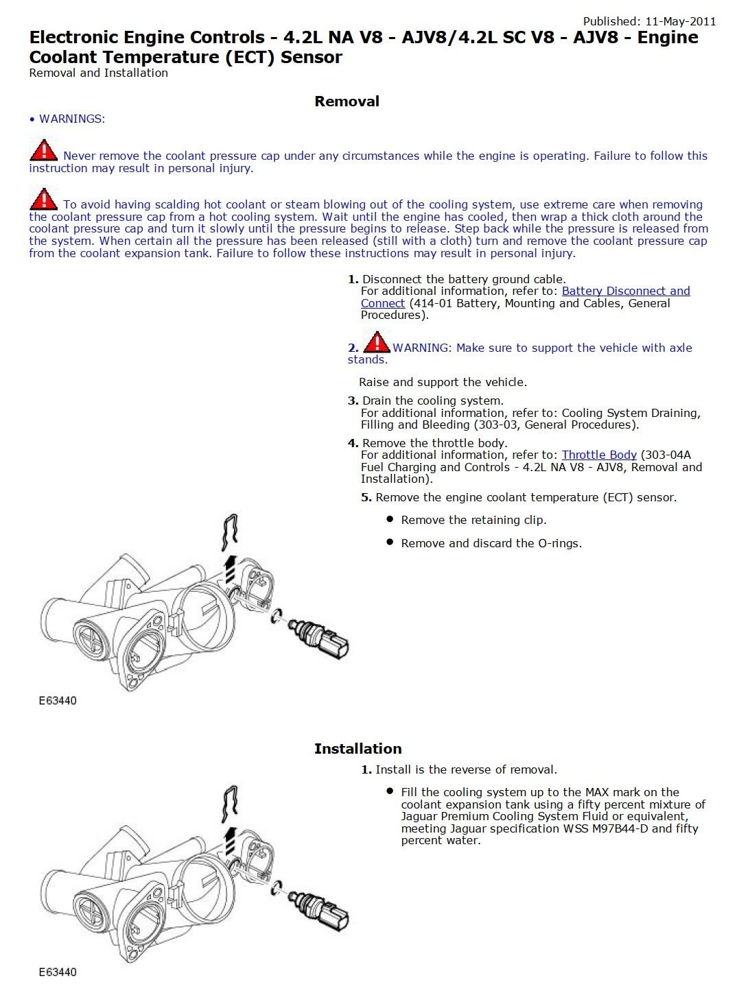

Have you checked for error codes from the ODBII?
A failed engine coolant temperature (ECT) sensor shouldn't cause it overheat immediately, if the ECT fails the ECU reverts to the oil temperature thermostat to manage the engine temperature.
The ECT is on the throttle body.

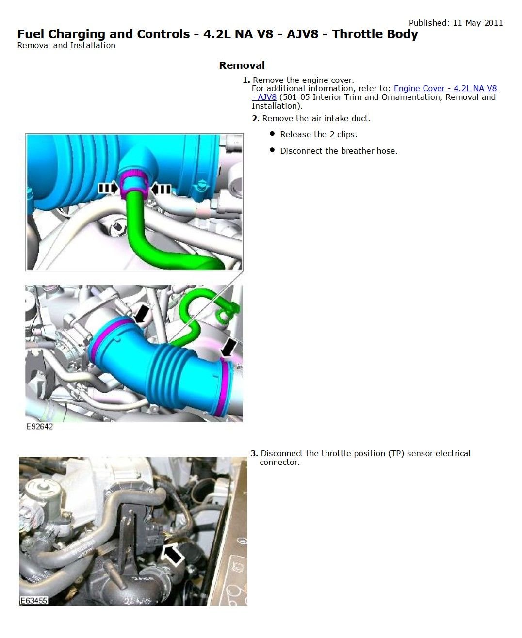

Thanks for response. The drawing does not look like mine. Maybe I'm looking at it wrong. I will double check. Here is pic of top of my engine and throttle body. It appears to me that I have to remove a bunch of stuff on top before I can even get to thermostat? And are there two separate coolant entry pipes? I don't believe both are plastic in my case but again, I'm just getting into this issue.

I think the ECT is under that collection of hoses. It looks like the two hoses you can see in your picture are the ones on the back of the diagram only the diagram is upside down.

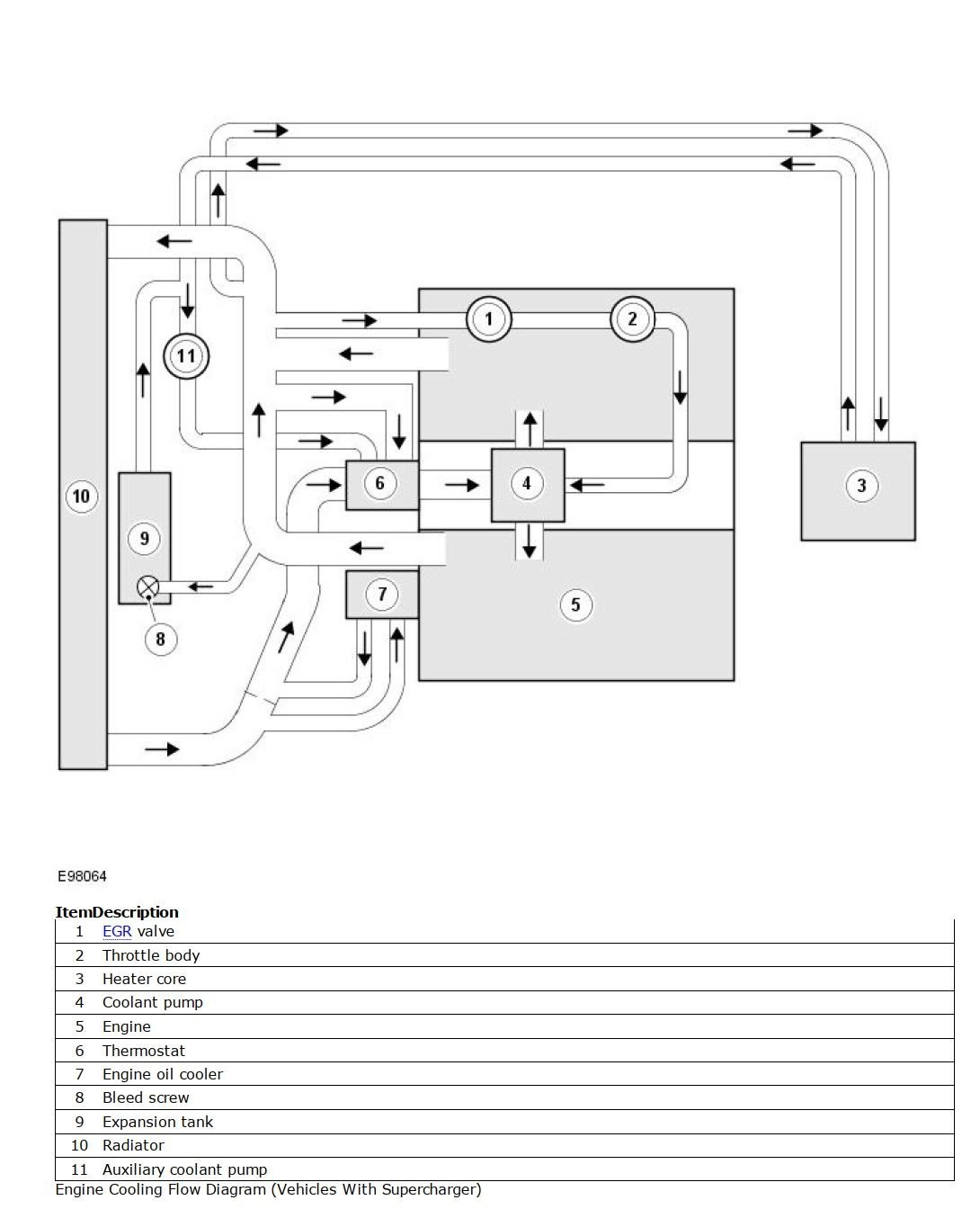

Below is the workshop guide. However given you've blown a hose that doesn't sound like it's the thing. As davetibbs says, likely to have air in the system.
In terms of the climate control there are many things that could be wrong, one being air in the system. The engine coolant pump is driven mechanically by the engine, however the climate control system has its own auxiliary coolant pump and if this fails then little coolant will reach the heater core (the flow diagram is below). There could be a problem with the thermostat, or any number of temperature sensors.
