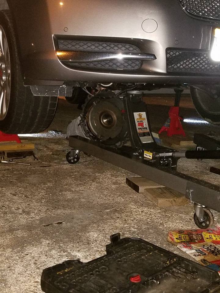

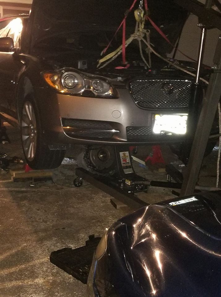

Hi All,
I have bought a used transmission with 90,000 miles, to replace my faulty 136,000 mile trans.
I was wondering, what I may need to replace on the transmission or if I should just throw the new used trans up in there? As I plan on selling the car after it is fixed due to the hole it has already burned in my pocket.
I just want to make sure that this replacement is installed and works. I have the old trans out already. Thanks
