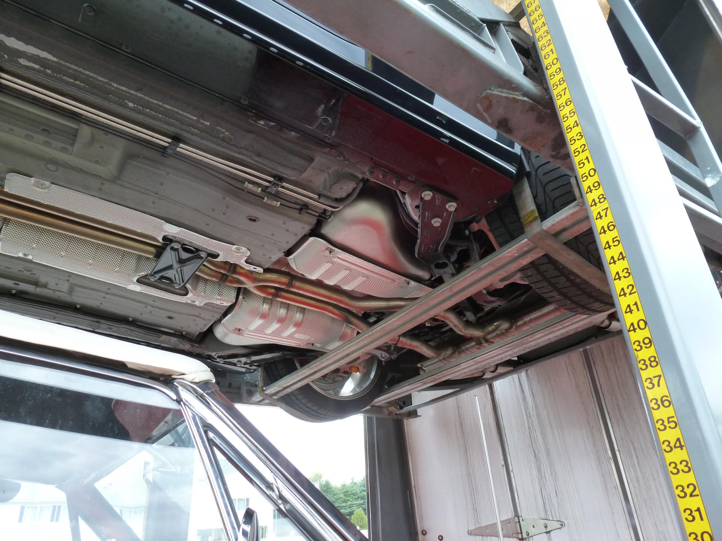

If you make big enough changes to the exhaust that considerably reduce the backpressure, then you will lose power, unless the engine tune is modified to compensate for this.
Regarding the exhaust design, it pays to look at what Jag did on the XFR-S and XKR-S models...
Here's the factory exhaust on the North American spec XFR-S;
2011 Jaguar XFR Magnaflow Exhaust & Muffler Delete= Power Loss??-18951205_10155243225911287_641017464427898144_n.jpg
2011 Jaguar XFR Magnaflow Exhaust & Muffler Delete= Power Loss??-18952576_10155243226316287_117128263593916610_n.jpg
And here's the factory exhaust on the XKR-S (and XKR's with the PAE);
2011 Jaguar XFR Magnaflow Exhaust & Muffler Delete= Power Loss??-p1010816.jpg
See the x-pipe? It's there for a reason...
