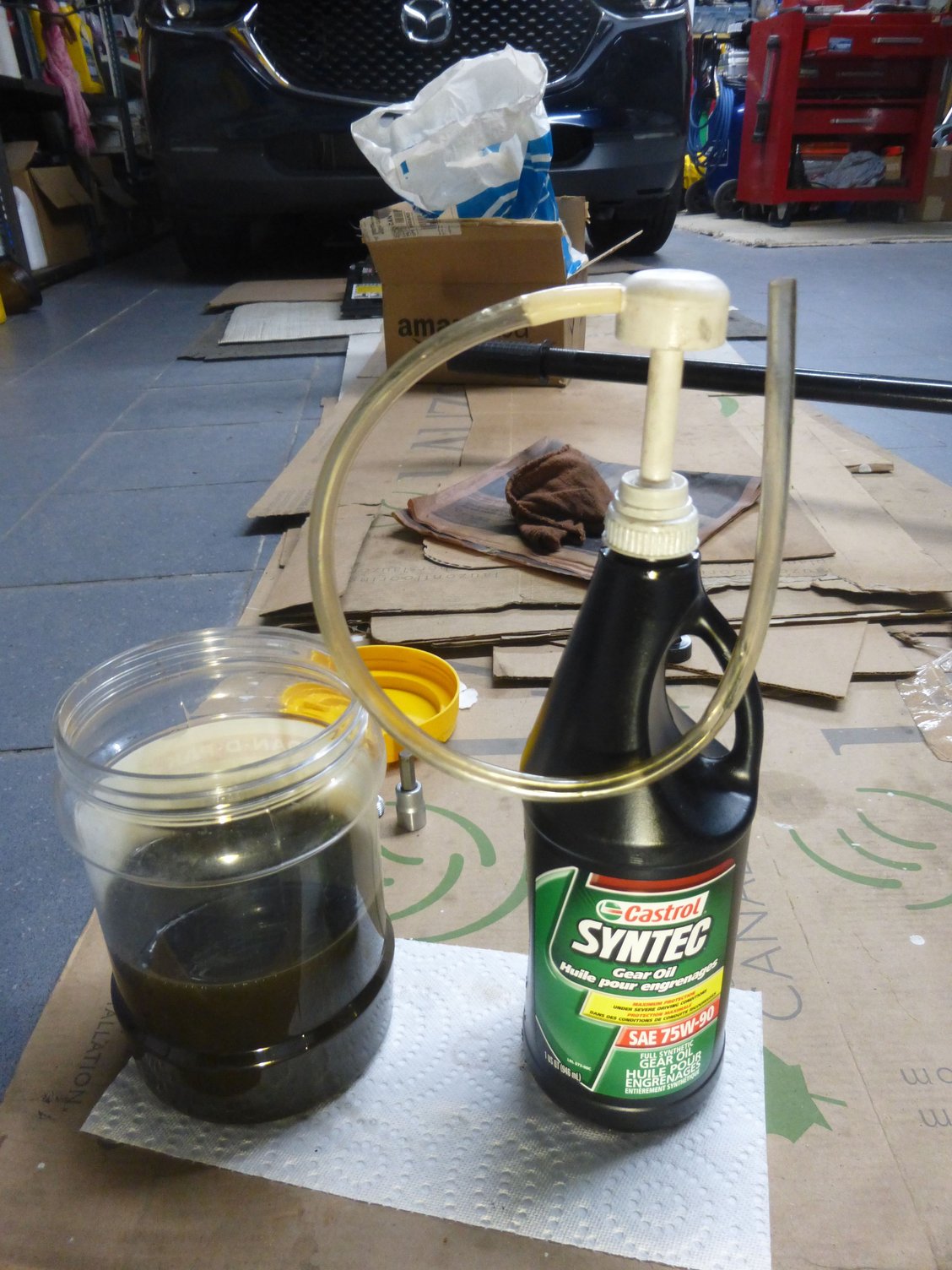

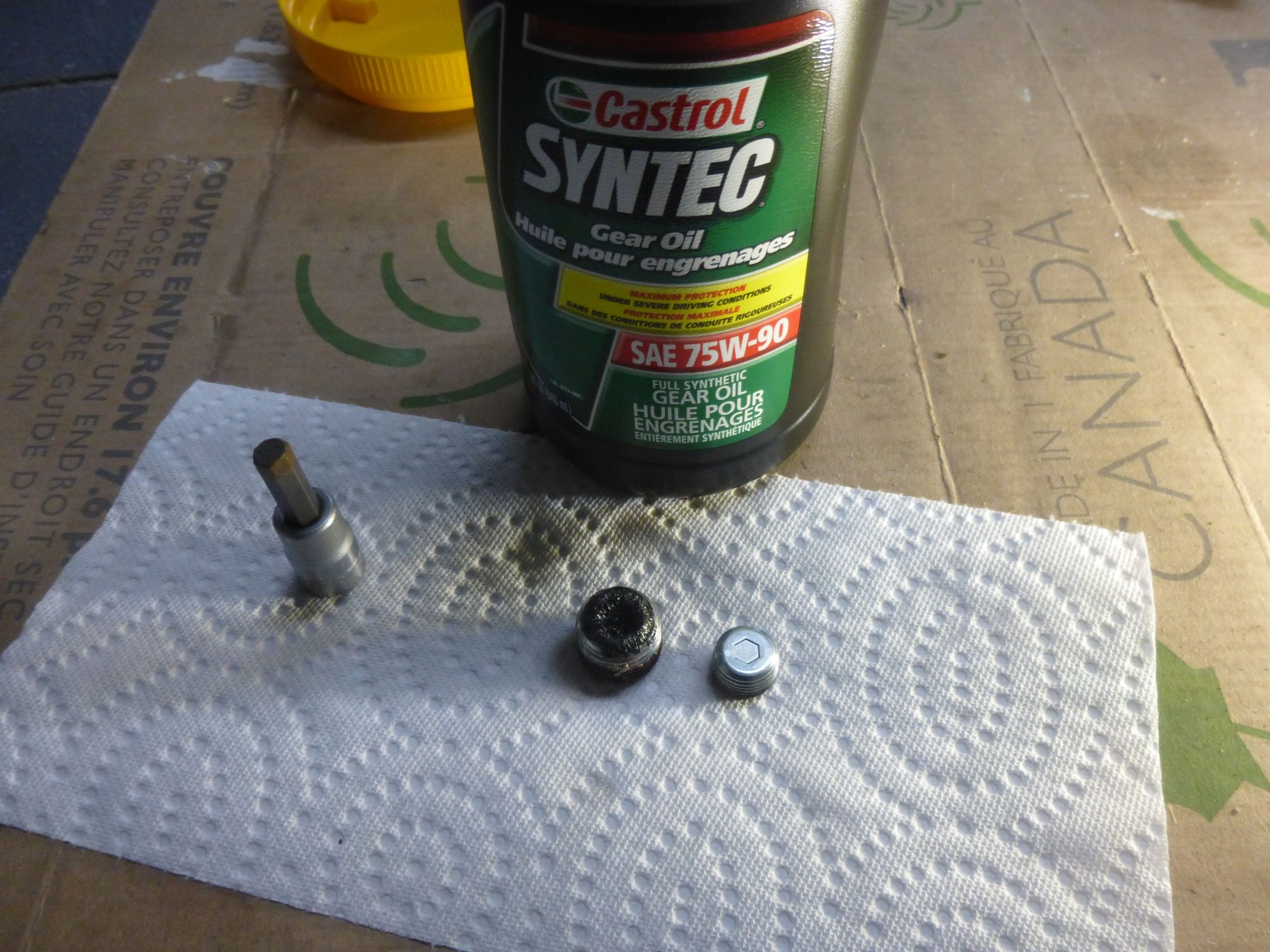

Changed the oil in the differential of my 2012 XF Portfolio this morning. This is an easy driveway job, although I did it in my garage. You need an 8mm hex key for the fill plug, a 3/8in square drive key for the drain plug and a container to collect the old oil, and new 70W90 gear oil --I used Castrol Syntec Synthetic Gear Oil for the new fill.
Make sure the fill plug is free before you drain the old oil.
Remove fill plug using 8mm hex key.

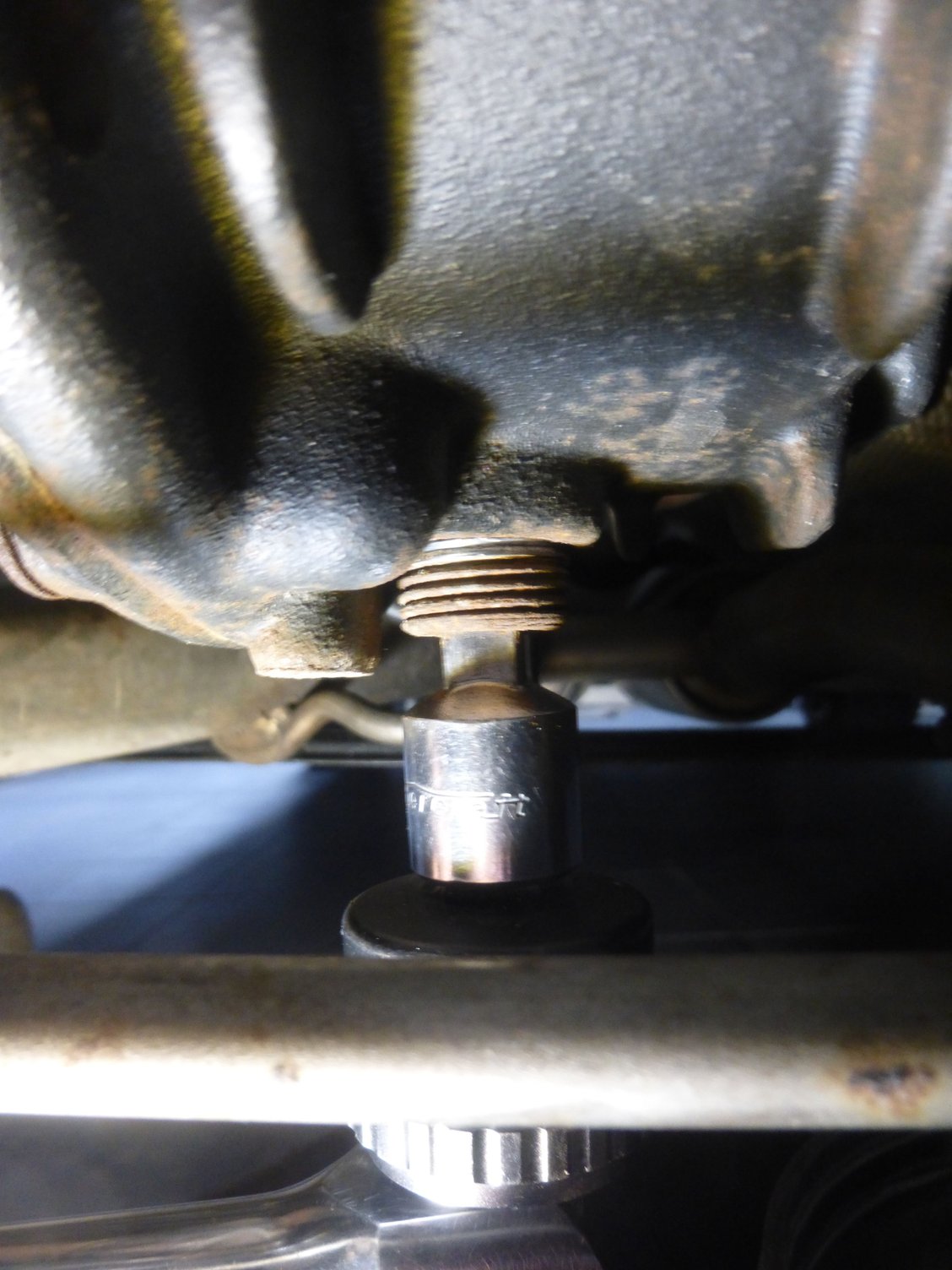

Remove drain plug with 3/8 square drive key. Make sure you have a container handy to collect approx 850ml of old oil.
8mm hex key, drain and fill plugs and new oil. Clean and replace drain plug before adding new oil.

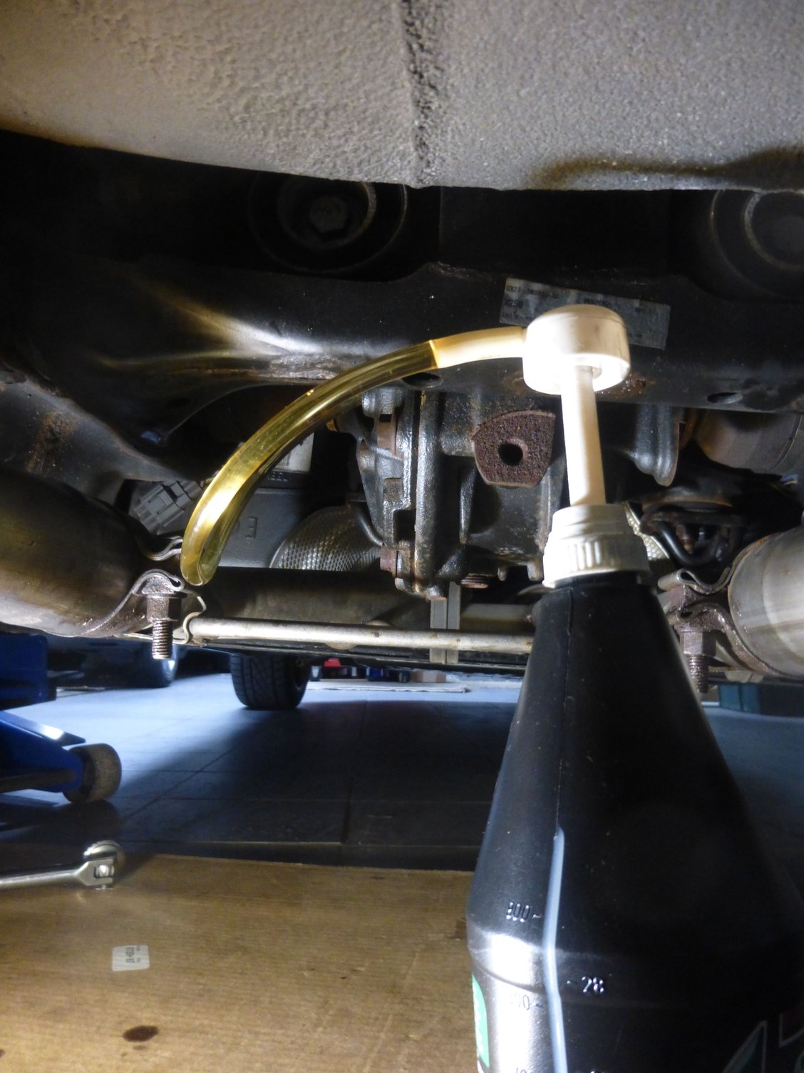

Pumping 850 ml of new oil into differential. Then replace fill plug.
Old oil ready for disposal.

Absolutely not. You have to measure out 850ml and put it in----it is below the the bottom of the fill plug hole. According to the Service Manual filling from dry requires 900ml but refilling after draining you only require 850ml. I actually measured what drained out and it was about 850ml. I used the scale on the bottle to measure the correct amount.
