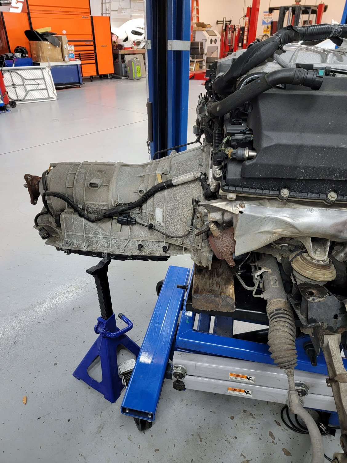

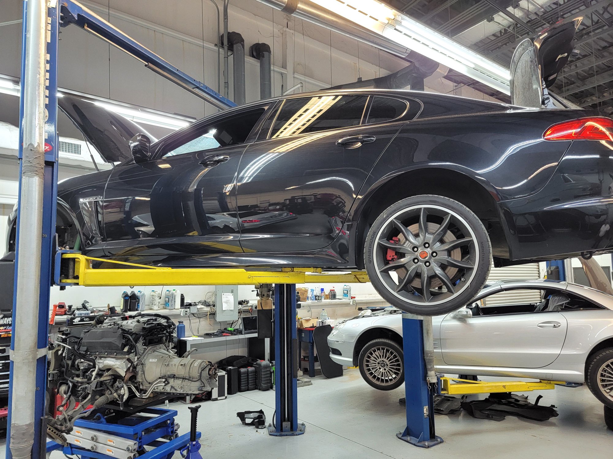

Current state of my car. Waiting on new engine to come in.

Looking at that engine you have the "older" version before the 2012 update (I can tell by the alloy cross-over pipe), One way to check is the gearbox - if you have the 6 speed ZF6HP28 it is the old version, if you have the 8 speed ZF8HP70 it is the new version. For the first year of the "facelift" XFR (from 2012) Jag stuck with the 6 speed box and the Denso ECU and it wasn't until 2013 they gave it the 8 speed box and Bosch ECU (and the crappy plastic coolant pipes!). It is important to know which ECU and gearbox you have when it comes to tuning etc.

@OzXFR thank you. Yep... I ordered the updated metal crossover pipes that don't fit on this engine. No big deal they were not that expensive. I am hoping the other metal cooling parts I ordered fit. I should get the car back at the end of next week. Then I will do the Bosch pump upgrade, add the wheel spacers, carbon fiber bits, and tune. I am sure Alex at Alpha will know tuning the older Denso I told him what year my car was.
