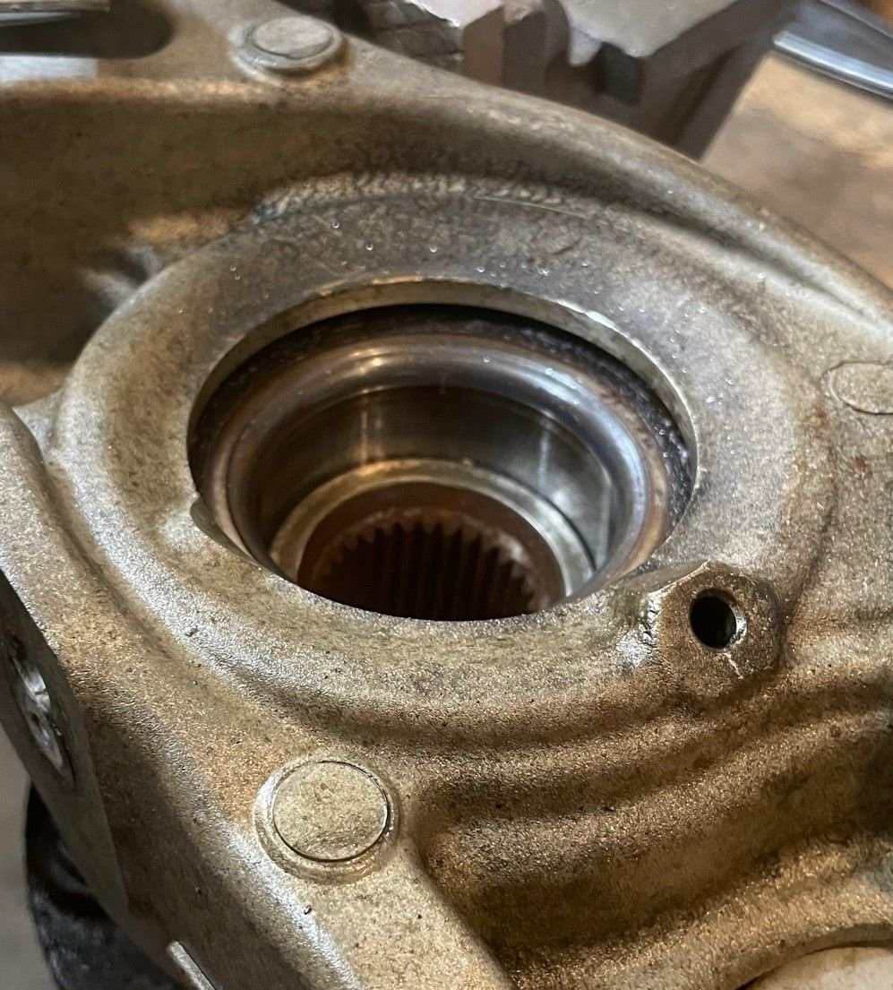

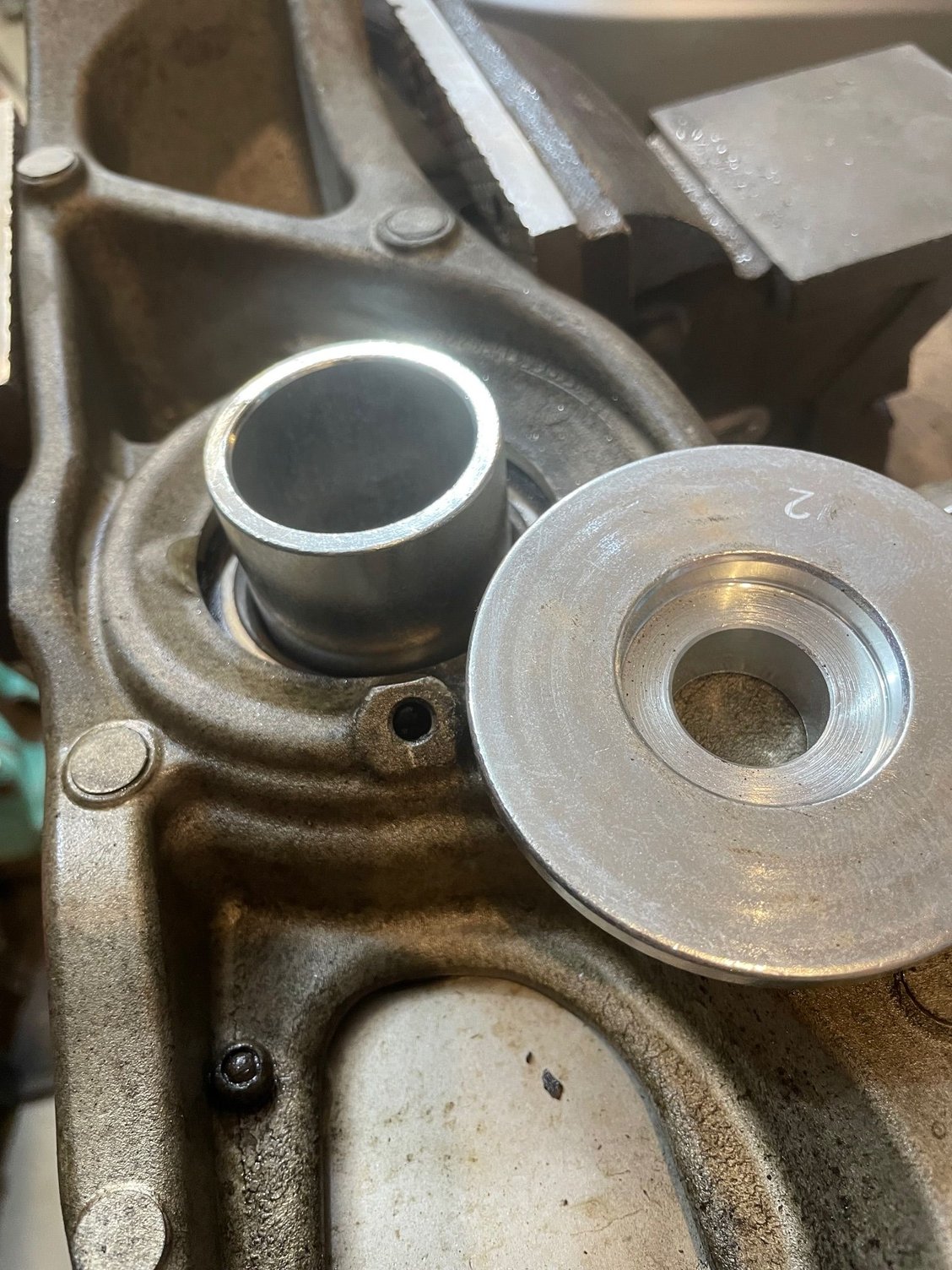

Well, got my hands on some new knuckle assemblies and installed the passenger side. Had a few nail-biting moments, first finding out that the upper control arm ball joint was played with before as the Allen socket in the stud was a wee bit stripped, lucky I had a reverse extractor. The second crazy situation was the half-shaft acting like the splines were welded to the hub, it took a few hours and a lot of pressure to pop loose. I am now playing with the old knuckle to see how feasible rebuilding will be. Once I get around to doing the driver's side, I'll make a tutorial as I didn't see much out there for guidance on the AWD versions.
Also, pulling the hub would be a must if you ever snapped a lug bolt on one of these AWD front ends.
Popping out the hub is easy, using the bearing kit, I was able to make quick work of it, keeping in mind the bearing splits, pushing the bearing sleeve out after requires a press.
