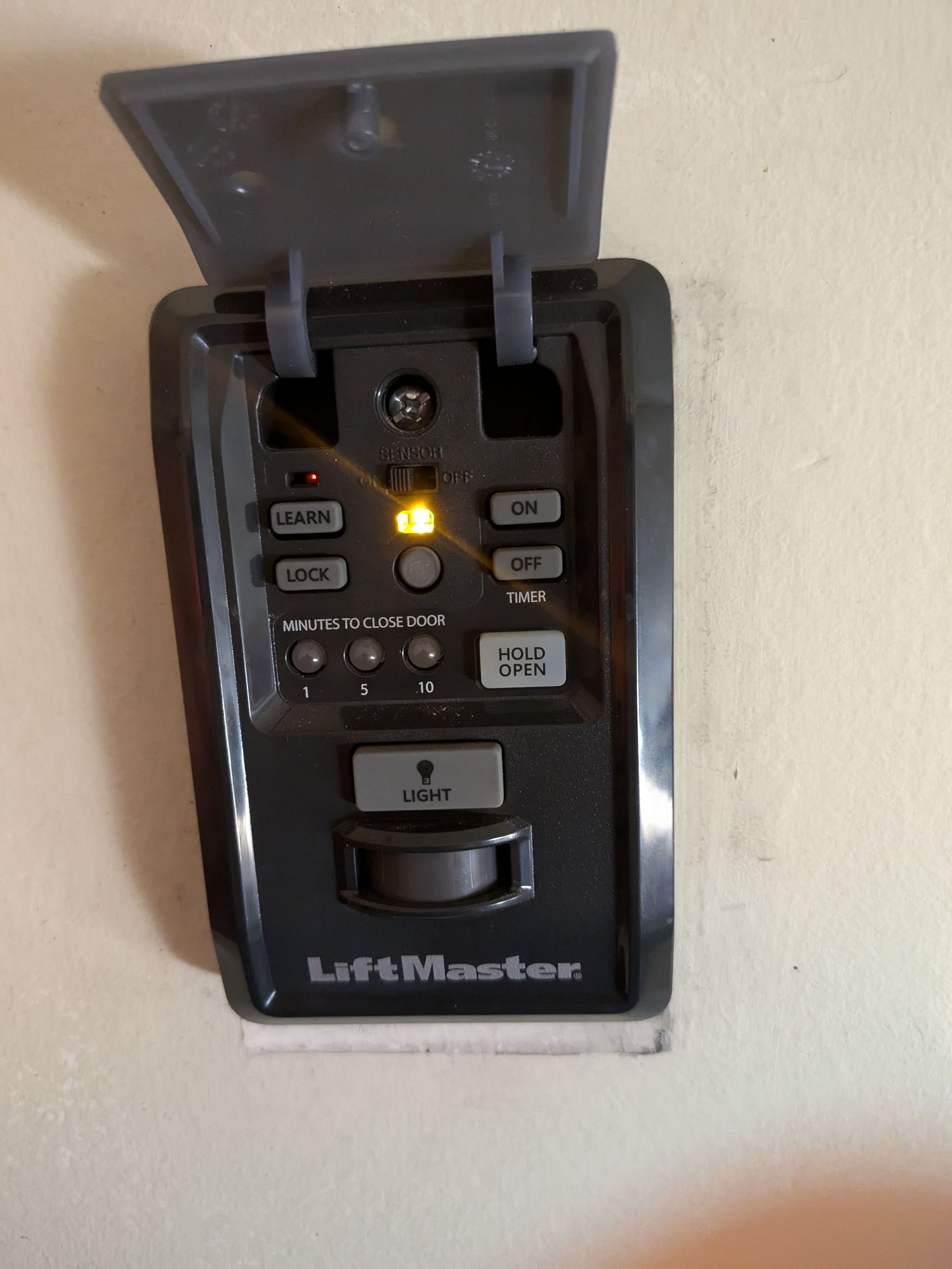

I got the device I today. I was able to get it to flash fast using the home link remote. I clicked the learn button on the opener, but it never connects with the car. I've ordered a replacement just in case the device is bad. If it doesn't work with it, could it there be a problem with the open itself? I have a 2009 SL550 that works with it fine. Not sure if that matters.
I finally was able to get it to program. The issue is my learn button on the garage door opener. I was able to get it to pair up when I used the learn button on my wall control. I still needed the hub connector you suggested in order to complete the first step. Tha k you for your help. It is very much appreciated.
