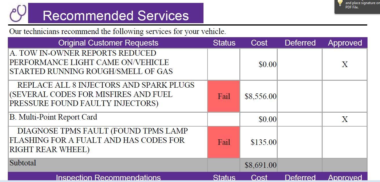

They say that the previous owner must have used cheap gas as I need to replace ALL 8 injectors and plugs. total? $8500 for service.
Eight injectors, plugs + labour does not cost $8500 .
What's the rest of the story?
I can show you the sheet from the dealership if you want.
The Injectors are about 230 - 300 each
the plugs about 4 dollars each.
all-data says the job is 6 hours.
the dealership quoted 8500 US$
And there is no telling what else they would find once they started.
Old Jun 17, 2015 | 10:51 AM
  #34

So lets say the injectors are 300 (I can order them right now for this) and the dealership charges me double for all parts.
600 X 8 = 4800
spark plugs; 4 X 2 X 8 = 64
8500-4864 = 3636
The labor guide says 6 hours. So 3636/6 = 606
So Patrick Jaguar in Naperville IL charges ~$606 an hour for their labor.

8 injectors @ $300= $2400
8 plugs @ $4= $32
6 hours labour @ (say) $150= $900
Total $3332.
Where does the other $5000 go?
