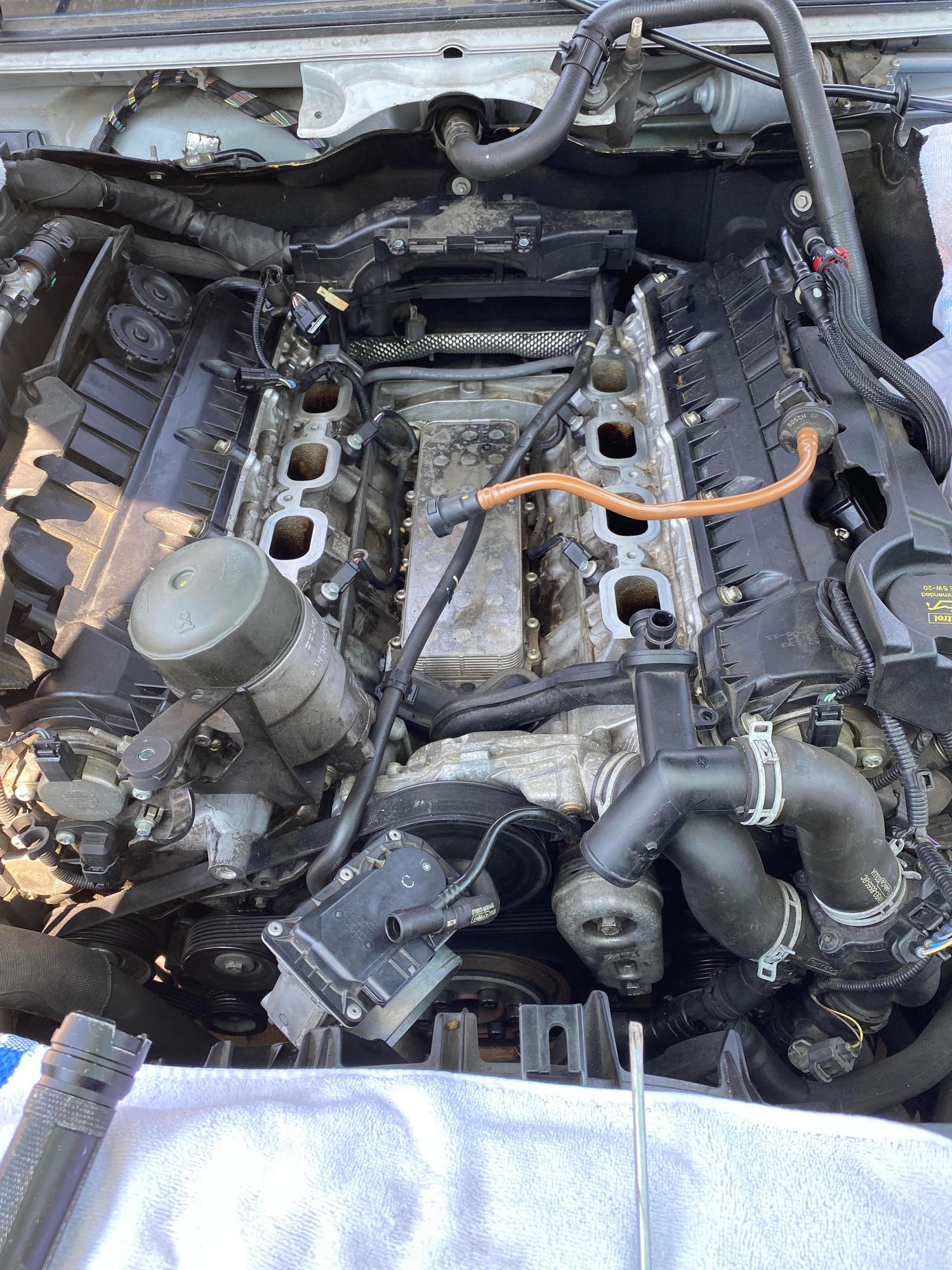

Parts arriving tomorrow, so time to get on with it.
Well, I can see the rear crossover, but it looks OK. I was assuming taht this would be cracked wide open given the coolant peeing out of the back RHS of the motor.
Perhaps I will find something when I get it out (if!) but if I don't, anyone got any ideas where the leak might be coming from?
BTW, the intake valves aren't terrible, but I'll clean them as best I can.

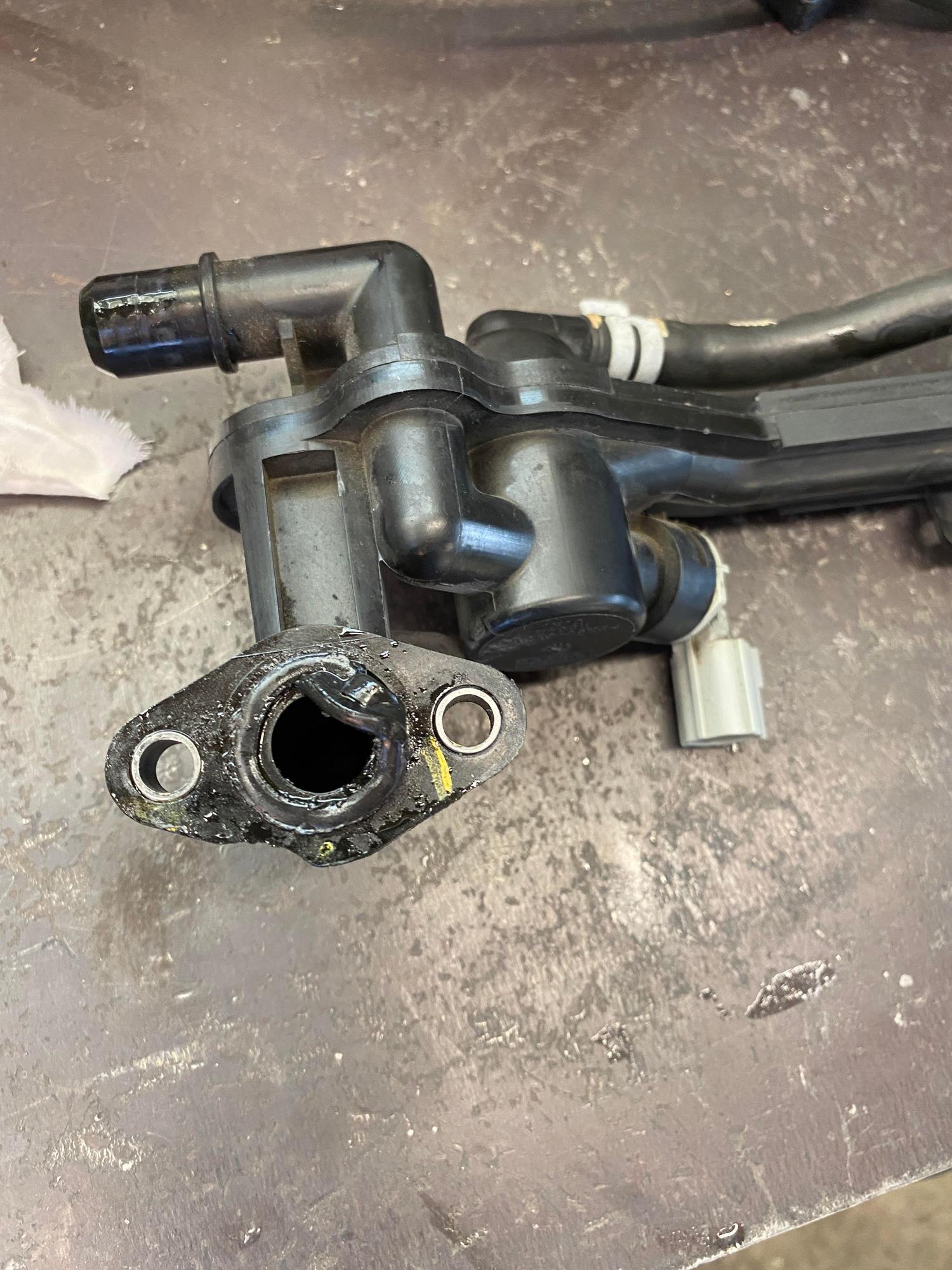

I was hoping to find a big crack in it, since the RHS rear of the motor is where the coolant was peeing out from but all I found was this mangled o-ring. I just don't see how an 0-ring can be perfect for 49k miles then get mangled so I have to believe this happened getting the pipe out. Hope I'm wrong because I also don't know how I possibly could've mangled it like this?

I can believe it was put in wrong, because, you know, Jaguar.
Probably was put in badly (on a Friday after right before happy hour at the local) and finally got old enough to fail
