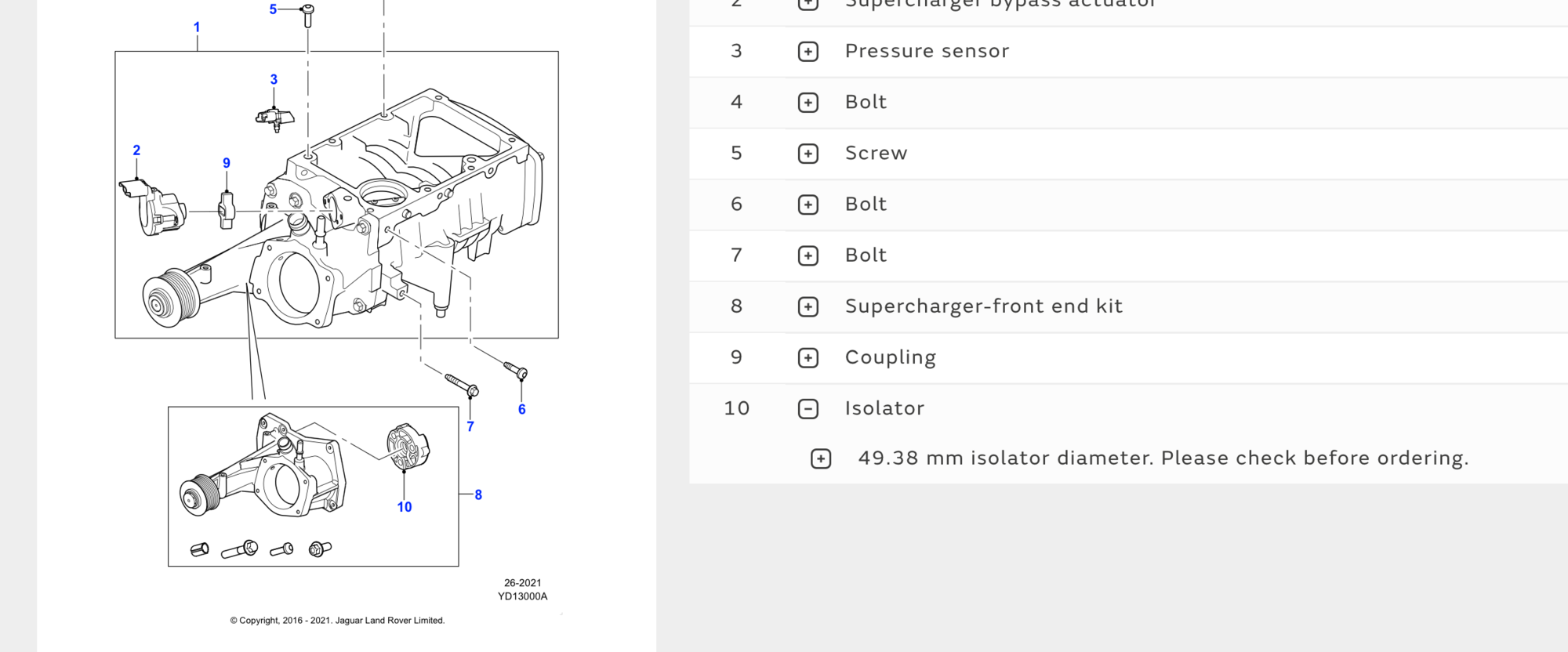

Default TVS 1320
https://parts.jaguarlandroverclassic.../brand/jaguar/
49.38 mm isolator diameter. Please check before ordering. C2D60916
For JLR original. The solid ones you will have to specify, which TVS to the vendor.
