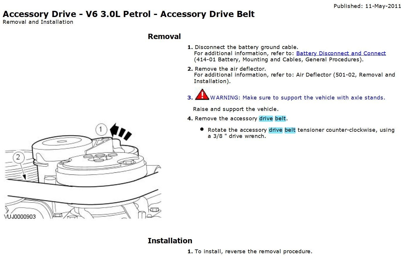

Assuming you mean the rubber accessory belt, then yes you can change this yourself. I changed the one on my 4.2l a few weeks ago, which is harder to work on because there's a lot less space under the hood to mess about in and you have to get the supercharger belt out of the way first.
The main thing you'll need is a serpentine tensioner wrench. On my V8 I needed to use a 1/2" square drive on the supercharger pulley and 3/8" drive on the accessory belt pulley to release the tension. I presume the V6 uses a similar 3/8" socket.
If you remove the air intake ducting from the throttle body you should be able to access most of the front of the engine. I found it was easier to access the tensioner pulley from underneath by propping up the car up on some jacks and dropping the air deflector. You can simply cut off the old belt and feed the new one around the engine from above and below.
The biggest issue I had was not being able to release the tension easily, the wrench I had was straight and there were lots of pipes and other bits of engine in the way which meant whilst I could get the wrench into the socket I didn't have enough space to pull the arm far enough to release the tension. So I cut my wrench head off and welded it back on at an 30 degree angle, which gave me enough leverage room to move it. I don't know if this will be a problem for you as the layout of the engine bay is slightly different and less claustrophobic, the workshop manual doesn't show you needing a special tool to do this for the 3.0l unlike the 4.2.
I would also recommend using a racket strap or similar to hold the tension wrench in place whilst you slip the belt on so you don't have to try and move it and hold the tension off at the same time. You'll find it easier to start by feeding the new belt around the crankshaft, tensioner pulley and A/C at the bottom of the engine first as you have lots of slack to play with and you can move it about easily. As you go around you get less and less slack and it gets more fiddly to get it on so ideally you slip it over the steering pump and then top idler last where you have better access to them (the last one is still a bit tight even when the tension is supposed to be "off").
