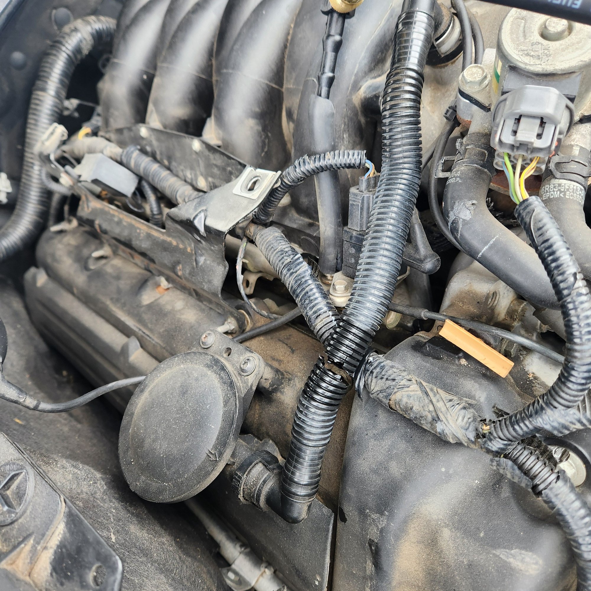

yes doing work myself, part number jag gave me was AJ87977, have had a whole wack of issuse plauge me but I think I'm making head way, just realized my pcv breather hose was cracked, touched it and it pretty much turned to dust. Hoping that is the main cause of my misfire fire issuse.

In case you did not know the FPR is directly behind that damaged hose in your picture. It has the right angle rubber vacuum elbow attached.
Have you swapped that out yet?
Good morning sir! Here are the codes i was facing, misfires were definitely from that pcv hose being cracked as they coincidence all on the same bank, for my low fuel pressure I did process of elimination by cutting fuel rail and putting gauge in between to monitor pressure, all of them seem to coincidence with FPR and etc sensor. I have replaced both and car seems to be running quite smooth again. I did make another post though concerning fuel trims as after driving and getting engine up to temp I noticed at idle at the end of my journey, ltft bank one was sitting at 8.4 percent roughly and bank 2 at 9.2 now I understand that there is a plus minus window for trims and when driving they seem to hover around zero.

Can you post a picture of how you fixed the PCV hose?
had to order one from jag dealership, the one they sent me is mu h better quality then the factory original but it could also be the source of my vacuum leak again as I'm seeing pretty high ltft at idles.
