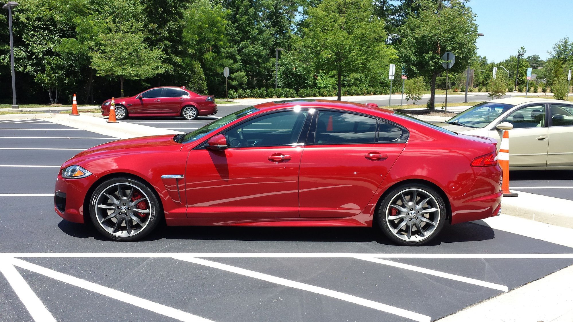

I sill own my 2012 XFR. Bought it brand new and it currently has 90k miles on it. Still a dream to drive and true sleeper!! Outside of regular and scheduled maintenance items the following were parts that have been replaced.
12/4/12 Jaguar XFR Purchase
12/14/12 Replace Left Front Shock (Warranty)
12/14/12 Replace both front doors seals
12/14/12 Replace roof light console
7/23/15 Front Driver Side Shock/Mount/Warranty
10/8/15 Engine Block Oil Leak/Seal
5/12/16 Water Pump Labor: $308.87
5/12/16 Water Pump $223.00
5/12/16 Coolant 2 x $66.00
5/12/16 Water Pump Gasket 2 x $23.56
5/12/16 Air Intake Tube $237.00
5/12/16 Rear Main Seal Labor: $750.10
5/12/16 Rear Main Seal $99.00
9/23/16 F/L Control Arm Labor: $330.93
9/23/16 F/L Control Arms: $1100.00
9/23/16 Front Shock Passenger Side: $459.00
9/23/16 Front Upper Mount: $83.50
9/23/16 Shock/Mount Labor: $165.46
9/23/16 Warranty Deductible (F/L Control Arms)
2/6/17 Control Arm (C2Z29117) $580
2/6/17 Spring Labor $219
2/9/17 Mounting Spring (XR858419) $83.50
2/9/17 Isolator Spring (C2Z15891) $24.50
10/18/17 New Battery (Top Line Jaguar)
9/15/18 Trans Mount -R (C2D 38505) $197.50 Warranty
9/15/18 2 x Bushing (C2Z 5119) $109
11/14/19 Trans Mount -R (C2D 38505) Warranty TopLine
11/14/19 Engine Mounts Warranty Top Line
3/18/22 AC Condenser XR8 56373
3/18/22 Front Control Arms C2Z10052
3/18/22 AC Compressor Warranty LR0 56364
3/18/22 Coolant
3/18/22 Radiator Expansion Hose C2Z 14540
3/8/23 Hood Latch (T4K11208)
4/28/23 Fuel Pump C2D 25079
4/28/23 Fuel Pump Tank Seal C2Z 7361
4/28/23 Fuel Filter C2D 25076
11/1/23 New Engine Mounts x 2 C2D 2745
11/1/23 New Transmission Mounts
6/29/24 Supercharger Cone C2D58056
6/29/24 Intake Plenum Gasket AJ8 11948
11/19/24 Brake Pump LR082226H
12/19/24 2 x Struts C2Z11484 (Bilstein)
12/19/24 2 x Mount XR858419
12/19/24 2x Bellow C2P3211
12/19/24 2 x Bump Stops C2Z15891
12/19/24 2 x Packer MJA2162AA
12/19/24 2 x Sway Bar Link Pec 700-33170
12/19/24 1 x MAF Sensor LR0 87236
12/19/24 2 x Engine Hood Struts C2Z 3481

Very good looking XFR!!
