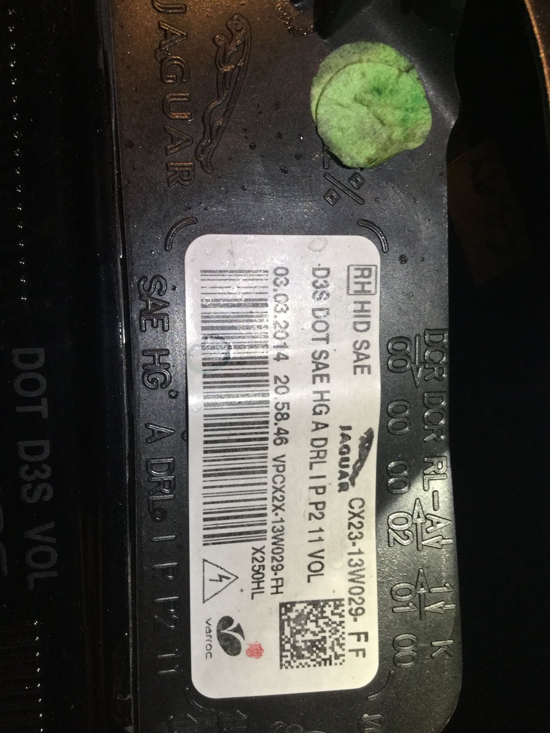

I may be able to help you out with this. I have a 2014 XF, and did a lot of research on this. This should be the same for your car. Look at your headlights, and look for a label. You need to be sure if you have adaptive HID or not. Here are the 4 different types with numbers. Do not let the section that says without HID bother you, because they all are HID. bulbs
Composite Assembly C2Z31431 Headlamp Assembly, Right XF. Right. With hid. 2012-15, with adaptive
Composite Assembly C2Z31432 Headlamp Assembly, Right XF. Right. Without hid. All. 2012-15, without adaptive.
Composite Assembly C2Z31435 Headlamp Assembly, Left XF. Left. With hid. 2012-15, with adaptive.
Composite Assembly C2Z31436 Headlamp Assembly, Left XF. Left. Without hid. All. 2012-15, without adaptive.
Here is a picture of my that does not have adaptive HID, but has HID bulbs. Hope this helps
