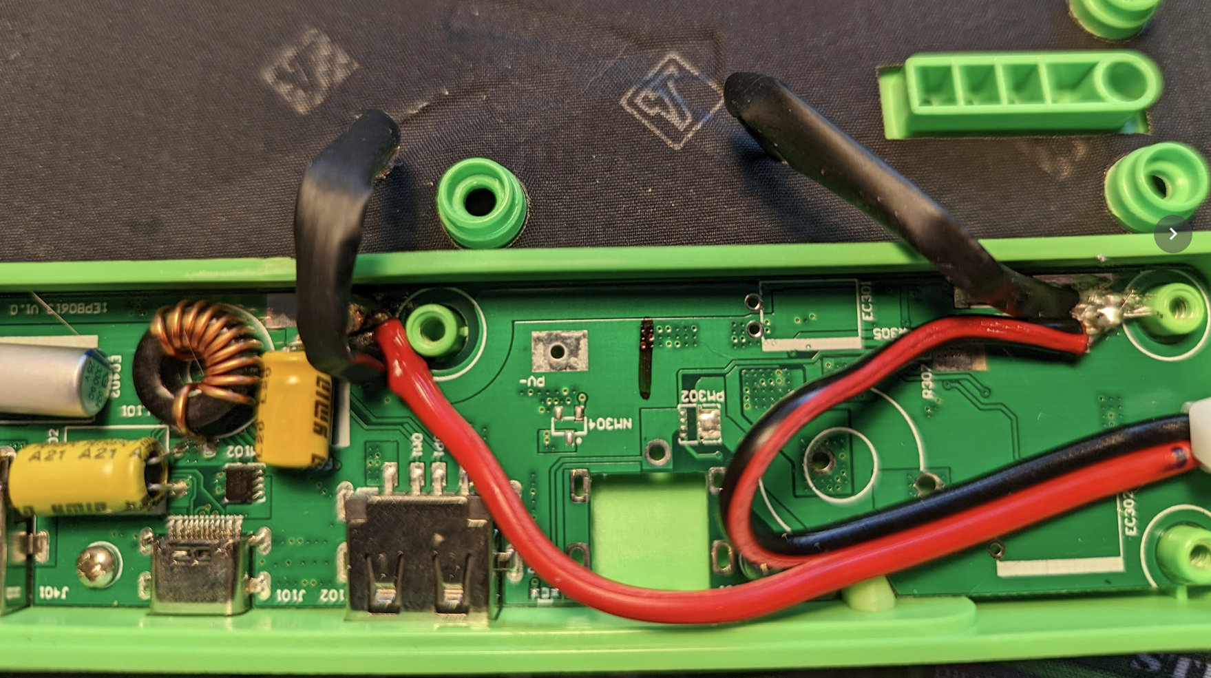

The charger needs 16V-25V for the solar input, but the panel only has USB and 14.4V output. It was easy enough to open up and solder a power-connector pigtail right onto the panel inputs. Poof, 25V right there. First two battery pics below.

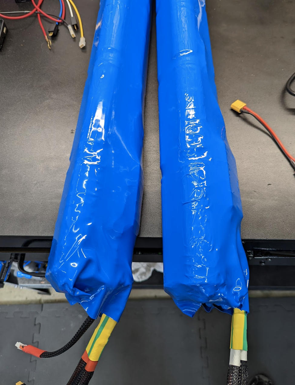

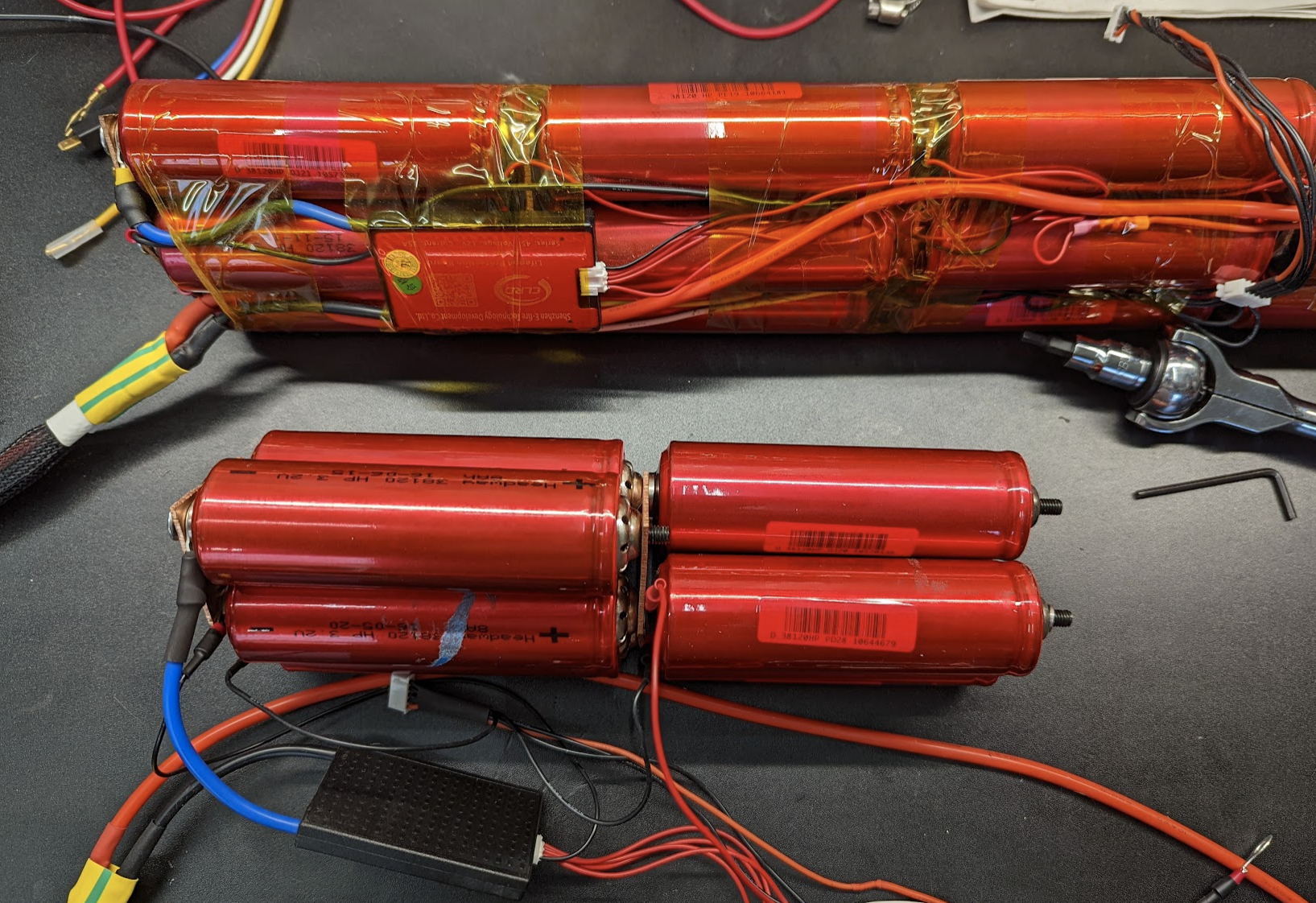

Batteries under construction
Batteries complete
Solar panel mod - access to direct panel 25V output
