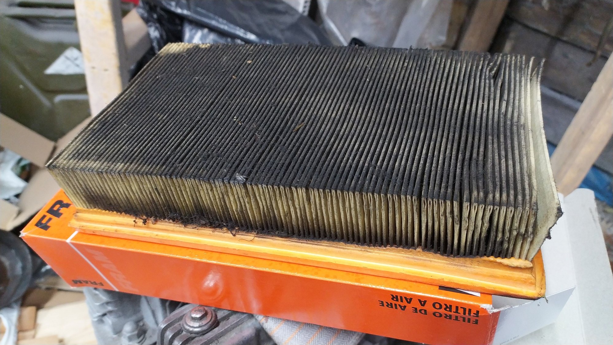

Got back and got stuck in. Thought I'd start with the easy bit first, air filter....................
Now then, according to the service history, this car was serviced at 45142 miles. It now has a smidge over 49000 miles on it, so lets call it 4000 miles difference.
Yeah, right, this is a 4000 mile air filter..........................more like a 40,000 mile air filter............changed on the last service my ****................

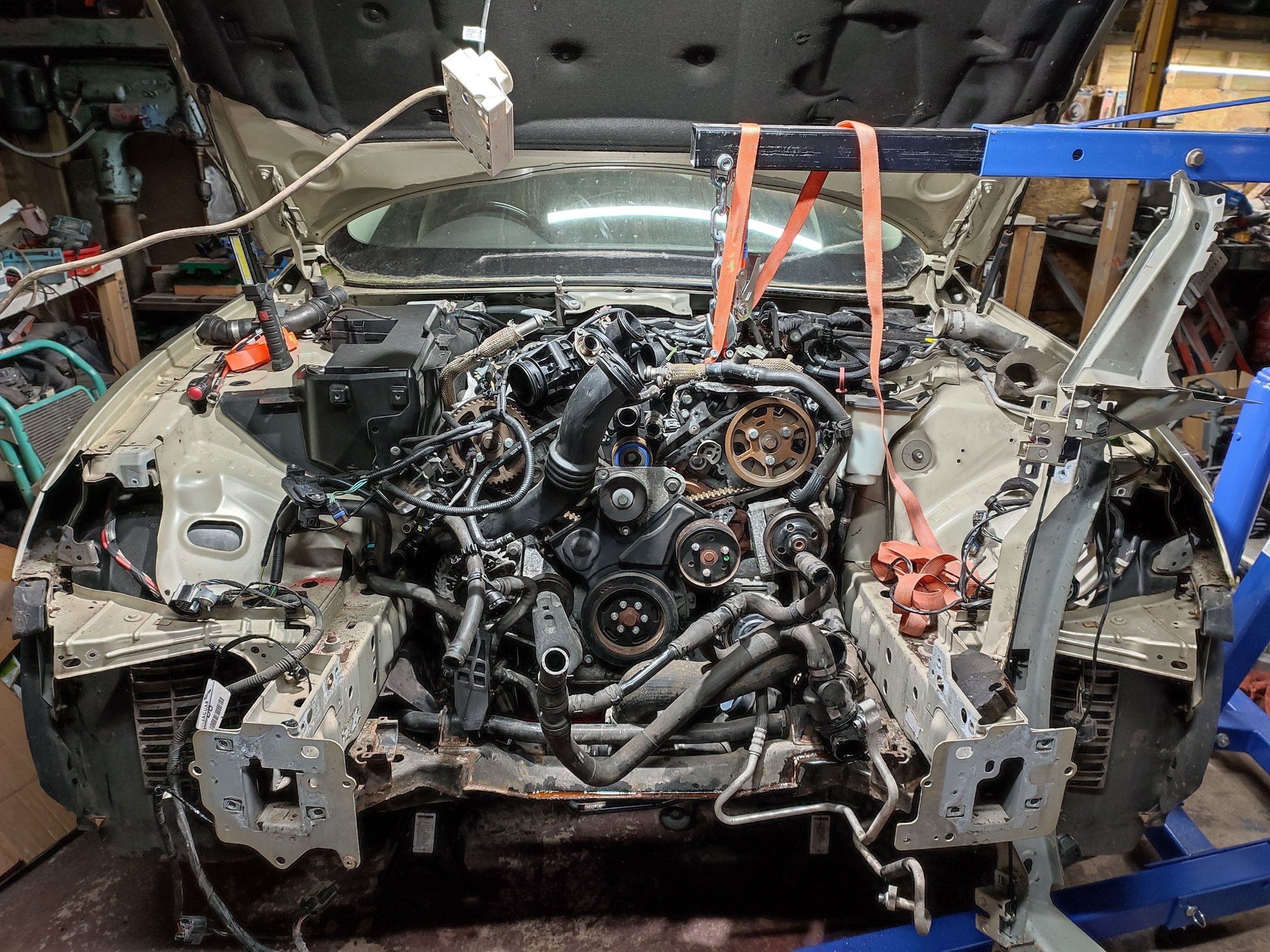

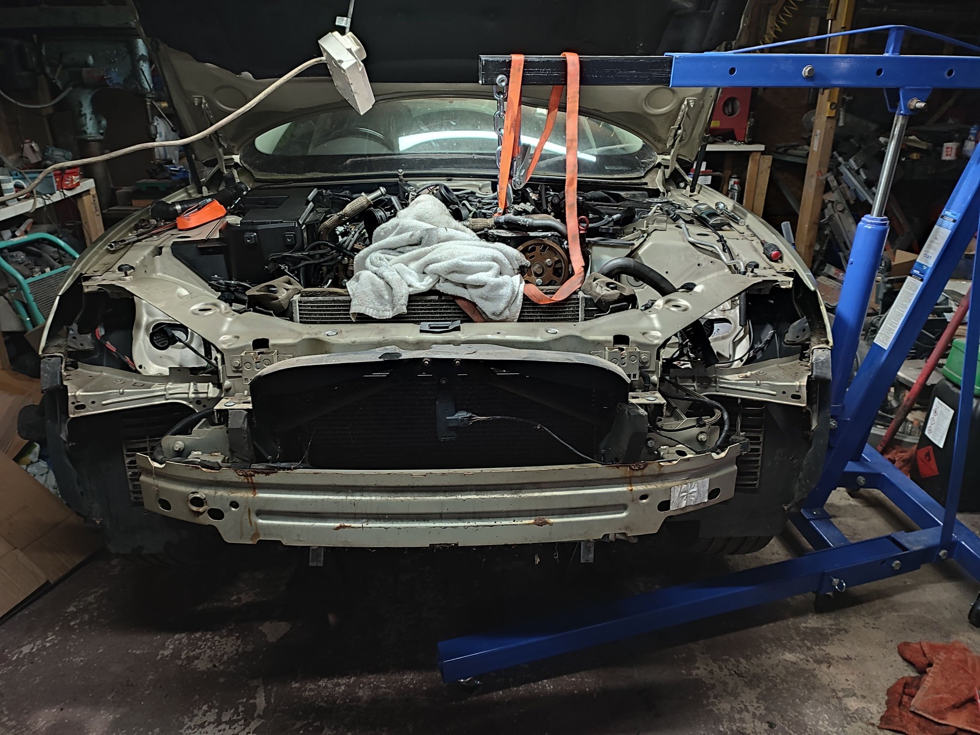

Well now, nearly 12 months ago I bought this car, and I'm only now getting around to working on it.
I changed the injectors, but that only made a slight difference. The knock was still there although the smoke out the pipes had reduced somewhat.
After finding that there were a lot of loose nuts and bolts around the engine, especially at the rear of the engine along the firewall, I took the decision to eventually get the car into my garage and do the full engine out and strip job.
Yes, it's took this long to get my garage clear of all the crap to get the car in..............
Finally got the bugger in and started on it. I was wondering how heavy the engine was before I bolt it to my engine stand when I found a cracking video, quite by accident of the TDI V6 diesel in these and Land Rover vehicles that was really interesting, explained why these are prone to the crank bearing failing.
Here's the link:
And here is the beast so far, I'll post more as it progresses.
The engine will be out and on the stand for this weekend so I can start on the full strip down. I'll post videos on my UTube channel as I get round to it and put the links here for others to have a look at.

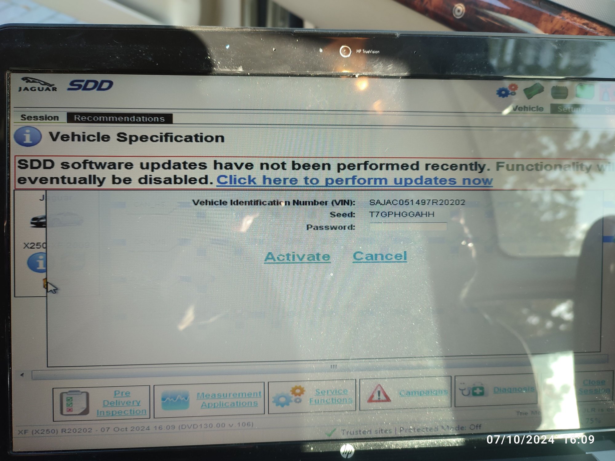

I've got a replacement PCM from a 2009 model that has installed fine, I've used SDD to reprogram it and all that is fine. The issues that were being thrown by the other one have all disappeared, however I need to reprogram the instrument cluster so it talks to the PCM and lets go of the security side of things and allows it to start. I should then be able to reprogram the fobs as well.
What I'm asking is does SDD allow the programming of the instrument cluster? I'm using version 130 of SDD.
If so where is it in the program options please? I can't find it, or I'm missing it completely. I've got something that says instrument something or other but it doesn't do a program reset thingy type thing that I need it to do.
I also need help with this in the photo below. It's a coded access but it asks for a password that I don't think I have already.
If anyone could assist here it would be wonderful
