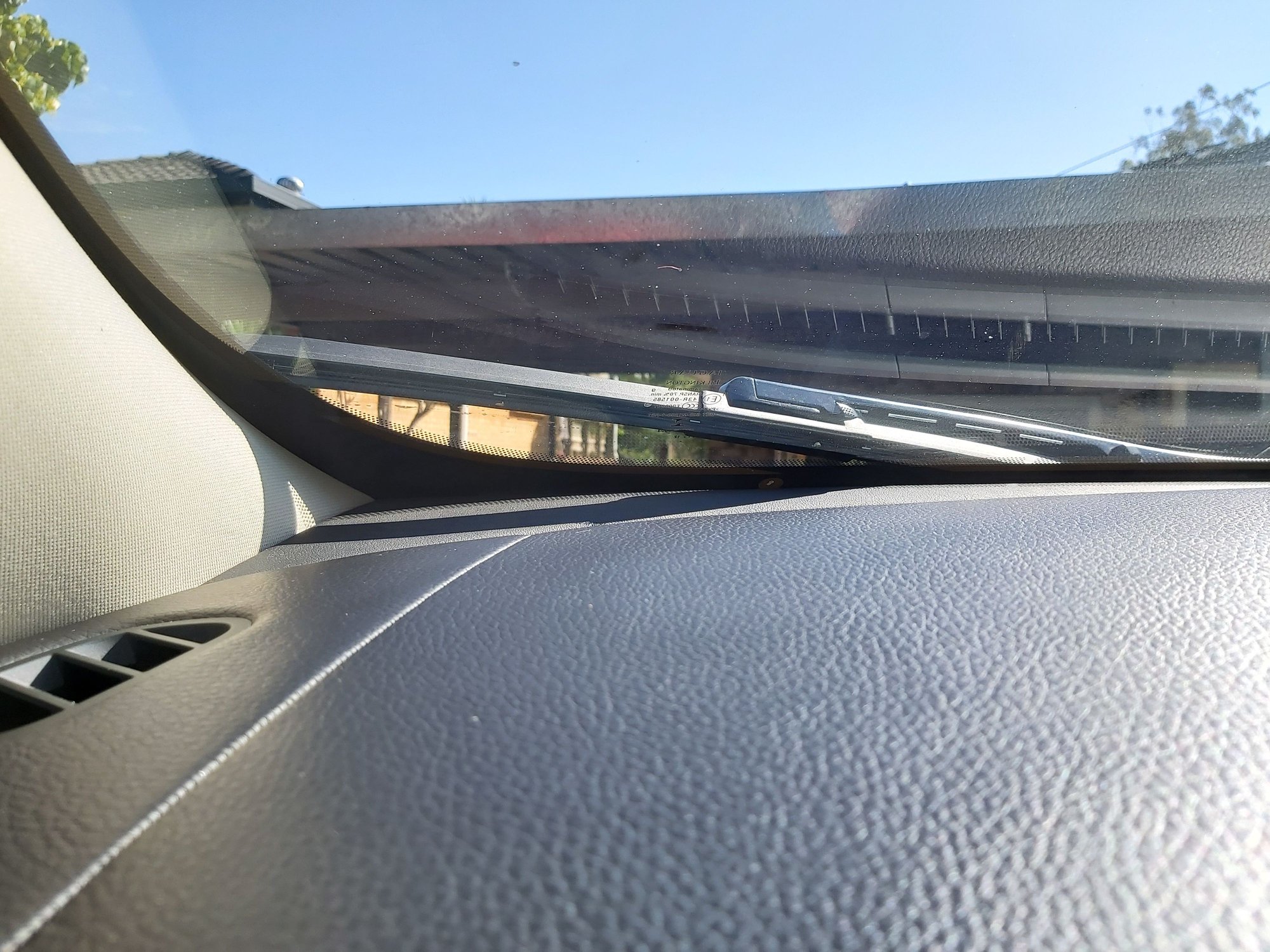

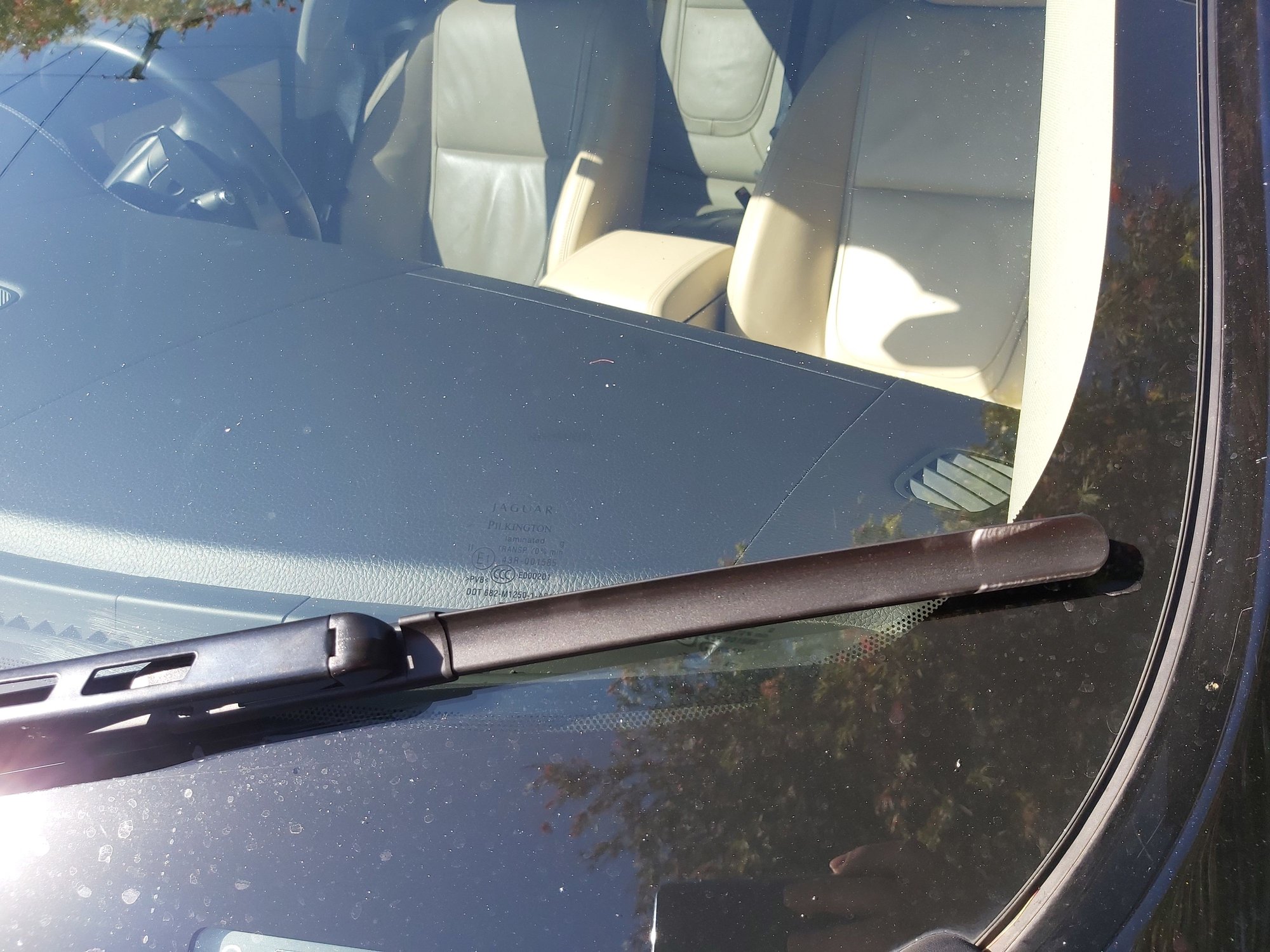

Hi Gents, Wanted to check with you if any of you had faced this issue? My pax wiper blade resting position is quite high on the glass. I can see half of the blade sitting on the glass when driving. Tried pushing it down or using the wiper but to no avail.
Any suggestions?
Thanks.

There is a tiny dot on the black surround of the glass where the tip of the wiper blade should stop

Thanks for that. Mine stops way on top of the black dot. I measured the blades and they are 24 inch and 19 inch. Any idea how to reset the positions? Thanks.

Looks about right!
if you do want to alter it, you’ve got to take the wiper arm off and move it on the splines of the connection. You’ve got to be careful though because when the wipers are at full pelt, it might hit the window frame. I would just leave it personally
