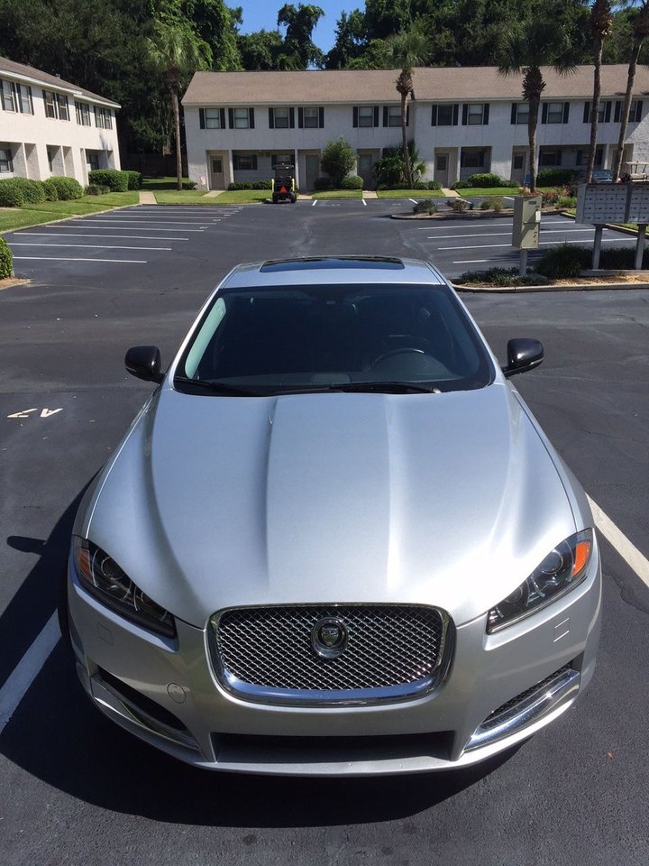

I sold my 2008 BMW 135i this past weekend and pulled the trigger on purchasing a 2012 CPO XF Base with 25,000 miles on it. Silver with black interior. I've owned it just over 24 hours and I'm loving it already.
I have noticed that, coming from BMW forums, the mod bug is quite a bit less prevalent with Jaguar owners. What I have planned is:
  • Powdercoat grill black
  • Powdercoat all chrome on exterior (except rear bar on trunk)
  • upgrade to lighter (possibly larger) wheels
  • possibly an exhaust depending on what the general forum consensus is about their quality
I would really like to go with a staggered setup for the wheels. Something that has a little more of a lip than the fronts do. Does anyone have any wheel suggestions for something like that?
In regards to the exhaust, I had a pretty pricey setup on my BMW and it still droned at highway speeds between 70-75mph. Is this just something that is a problem with almost all exhaust systems? I would love to have something just a little more throaty and guttural than the current stock setup. I live in an area with no emissions testing so that's not anything I have to worry about.
Anyway, I'm glad to be apart of the forum and look forward to reading many more informative posts for all you experts in the future.

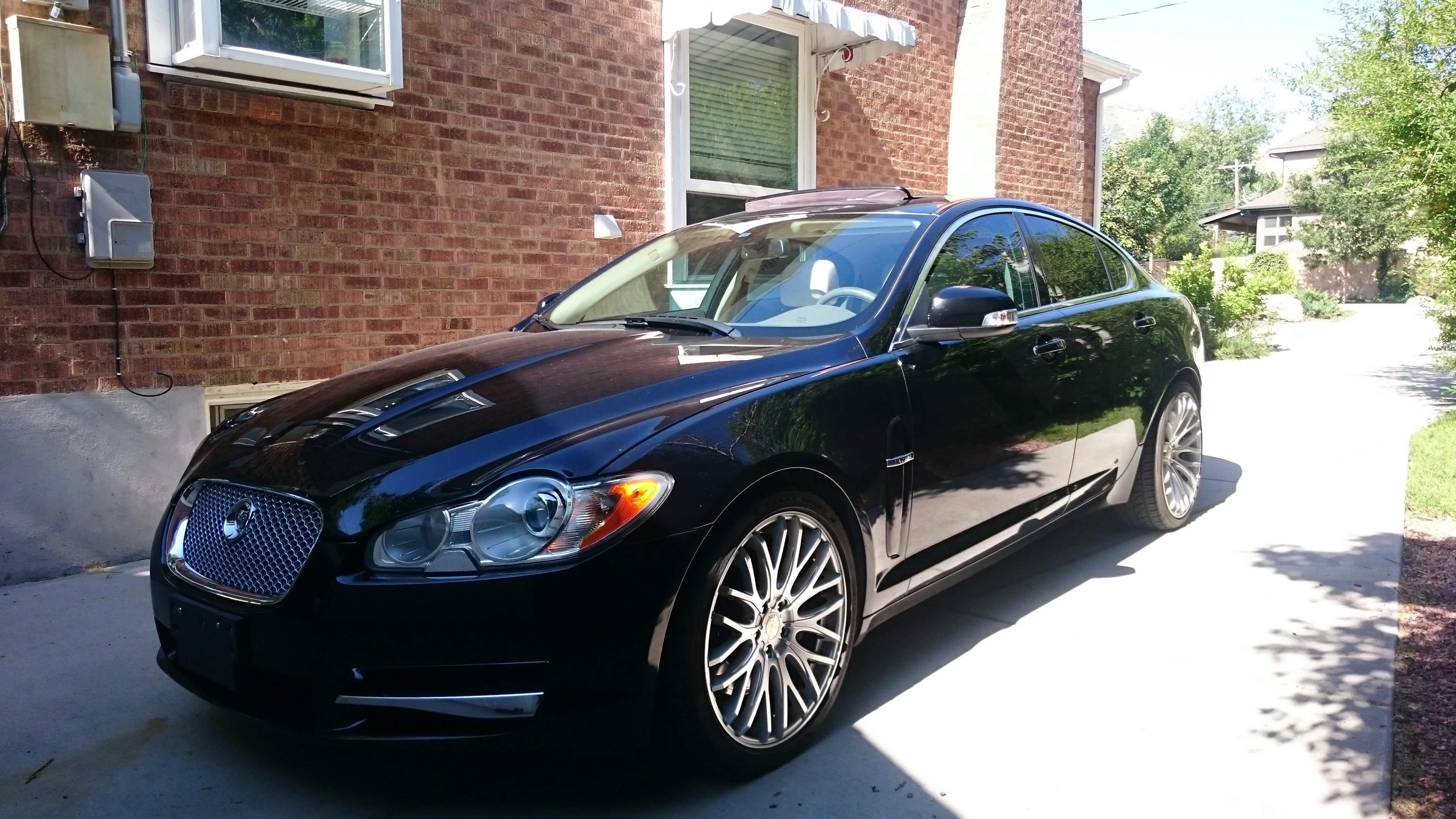

Welcome fellow Bimmer convert. I got mine recently too.
Mine is an s/c, but was still way too quiet. I've removed the engine cover and cut the resonators on the intakes and it gives me way more growl (and supercharger whine) without any speed drone. May be a quick, easy (and free!) way to get a little more sound while you consider your exhaust options.
For wheels, I have some 20" TiS DC537s that the prior owner put on them. They're absolutely gorgeous, but they stick out far enough that the wife just curbed one yesterday (now I've gotta figure out if it can be fixed).

Probably worth saying mine are staggered as well.

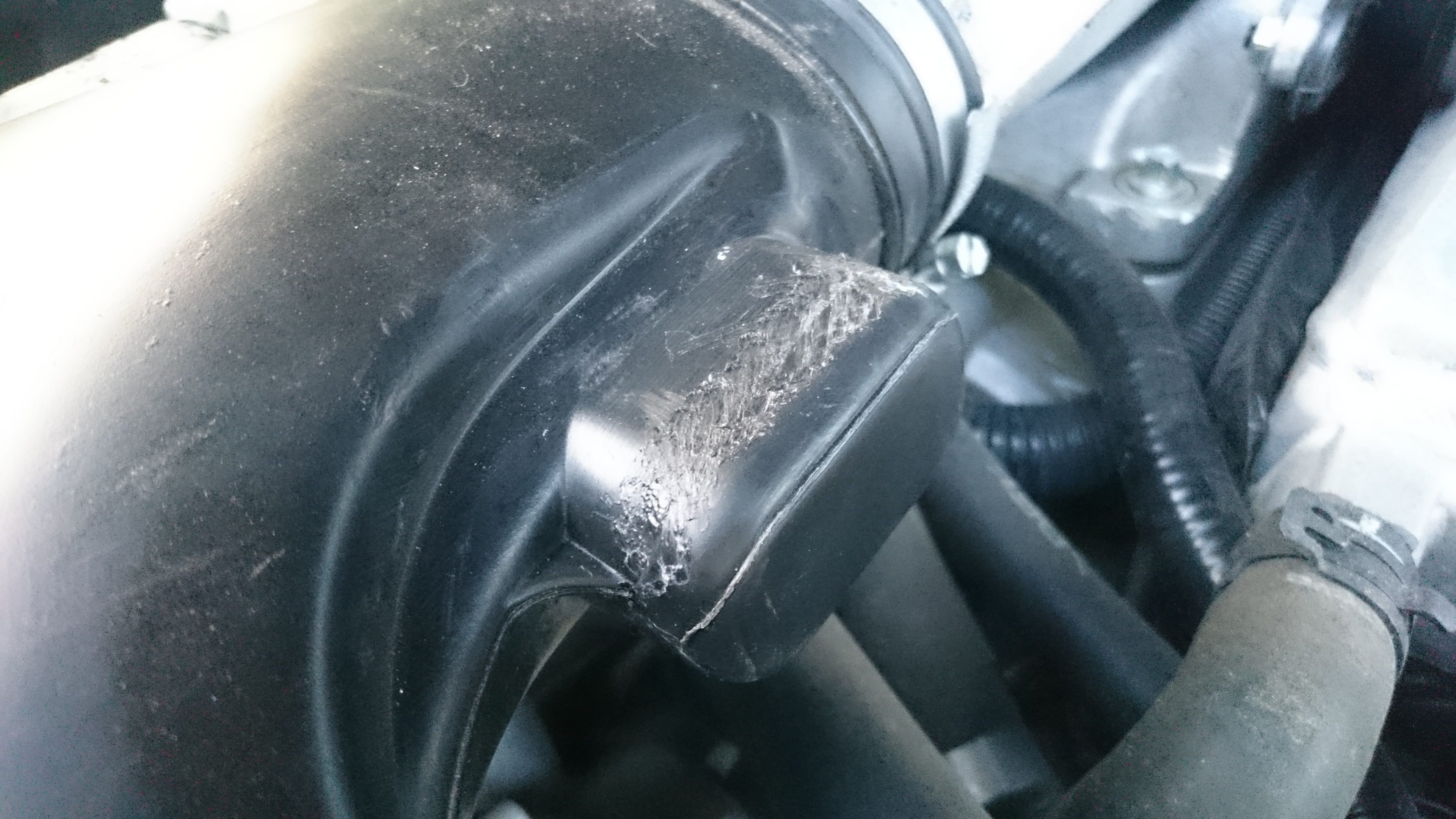

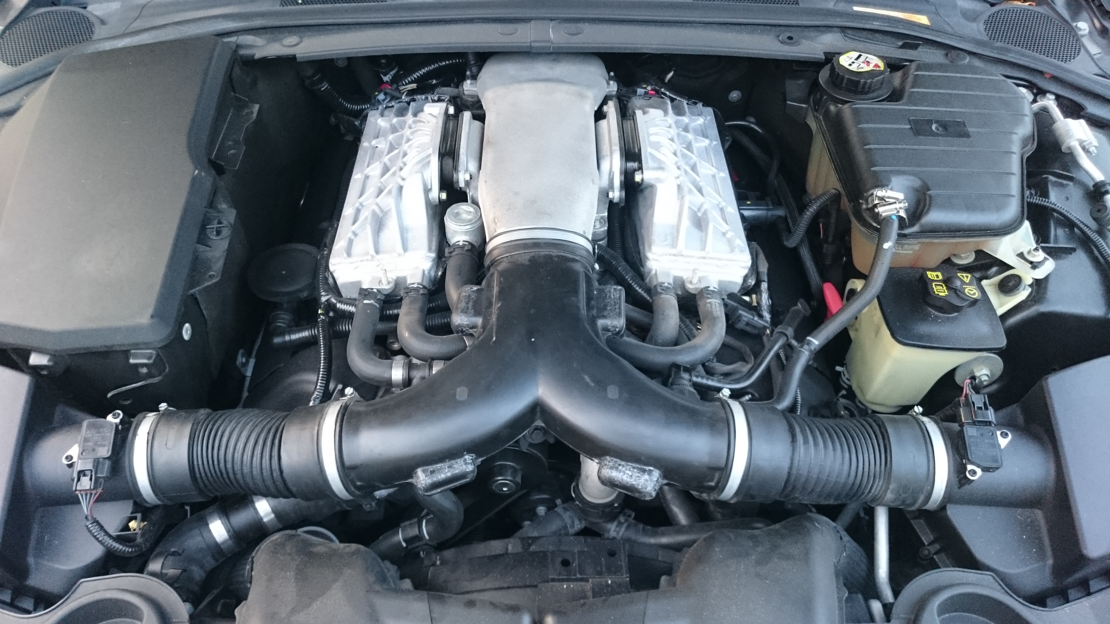

Originally Posted by danke
Can you tell me more about cutting the resonators? Maybe a picture or two?
Thanks!
I tried finding the post I saw it on, but no luck so far. Basically, all you do is take off the intake tubes and you'll see the pipes that come off them but go nowhere. Those are the resonators. They're just there to make the intake quiet.
I took a jigsaw and cut them off, then cut the ends off them to use as plugs. Then I used my soldering iron to plastic weld (fancy term for melting) the plug onto the intake pipe. I didn't take pics through the process, since there was already another post, but I've attached pics of my intake from above and a closeup. I haven't gotten around to sanding the plastic to make it pretty yet. Mine is a 4.2 SC, so yours will look a bit different.
Attached Thumbnails Proud new XF owner-2015-08-21-20.01.12.jpg   Proud new XF owner-2015-08-21-20.01.33.jpg

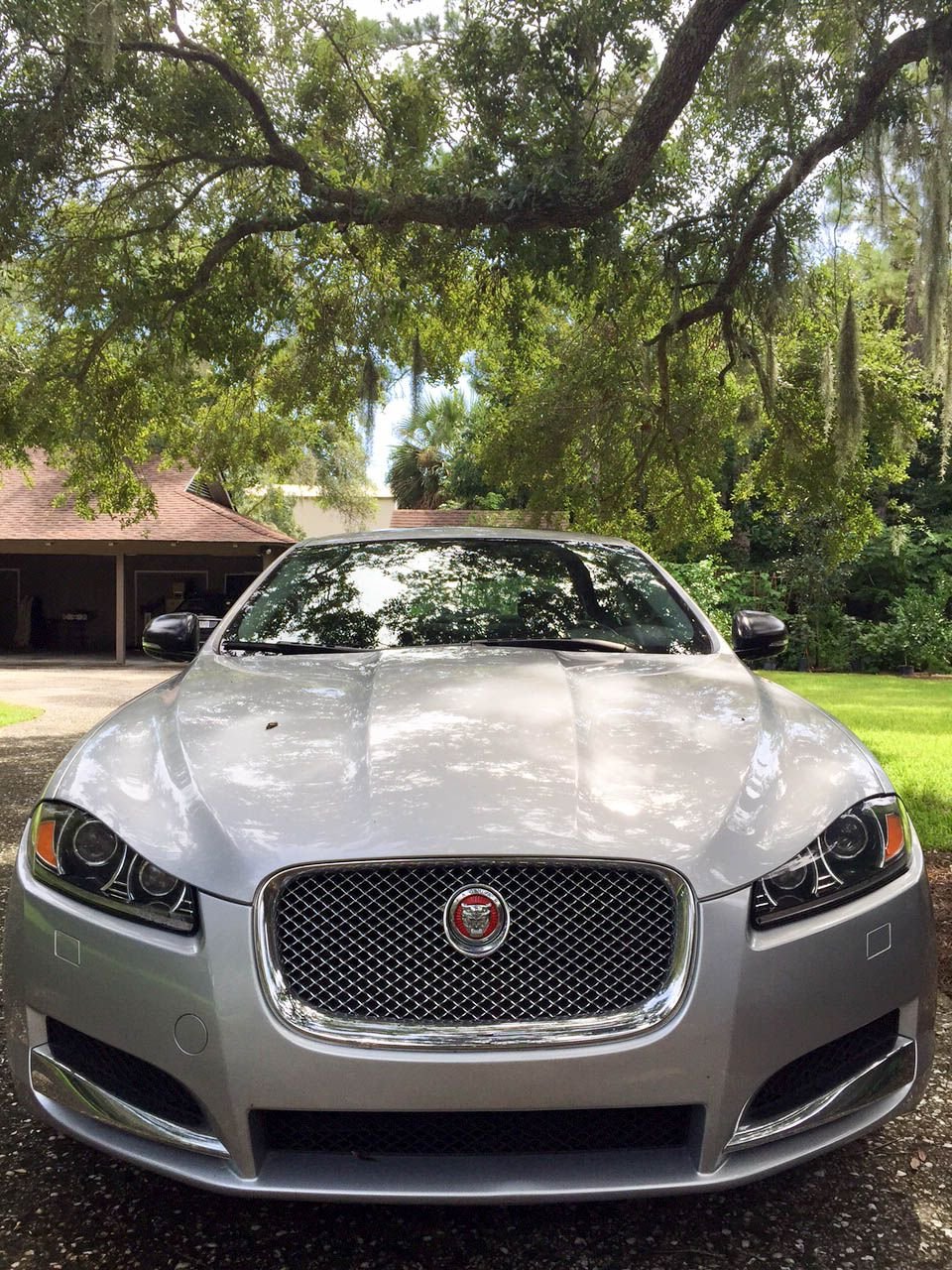

I've already made a few subtle changes...
I've painted the ugly chrome mirror caps gloss black:
Then I took apart the grill badge and painted the grooved background red:
I am very happy with the progress so far. This weekend I will be removing the front bumper so that I can paint the chrome grille and two chrome front bumper inserts.
