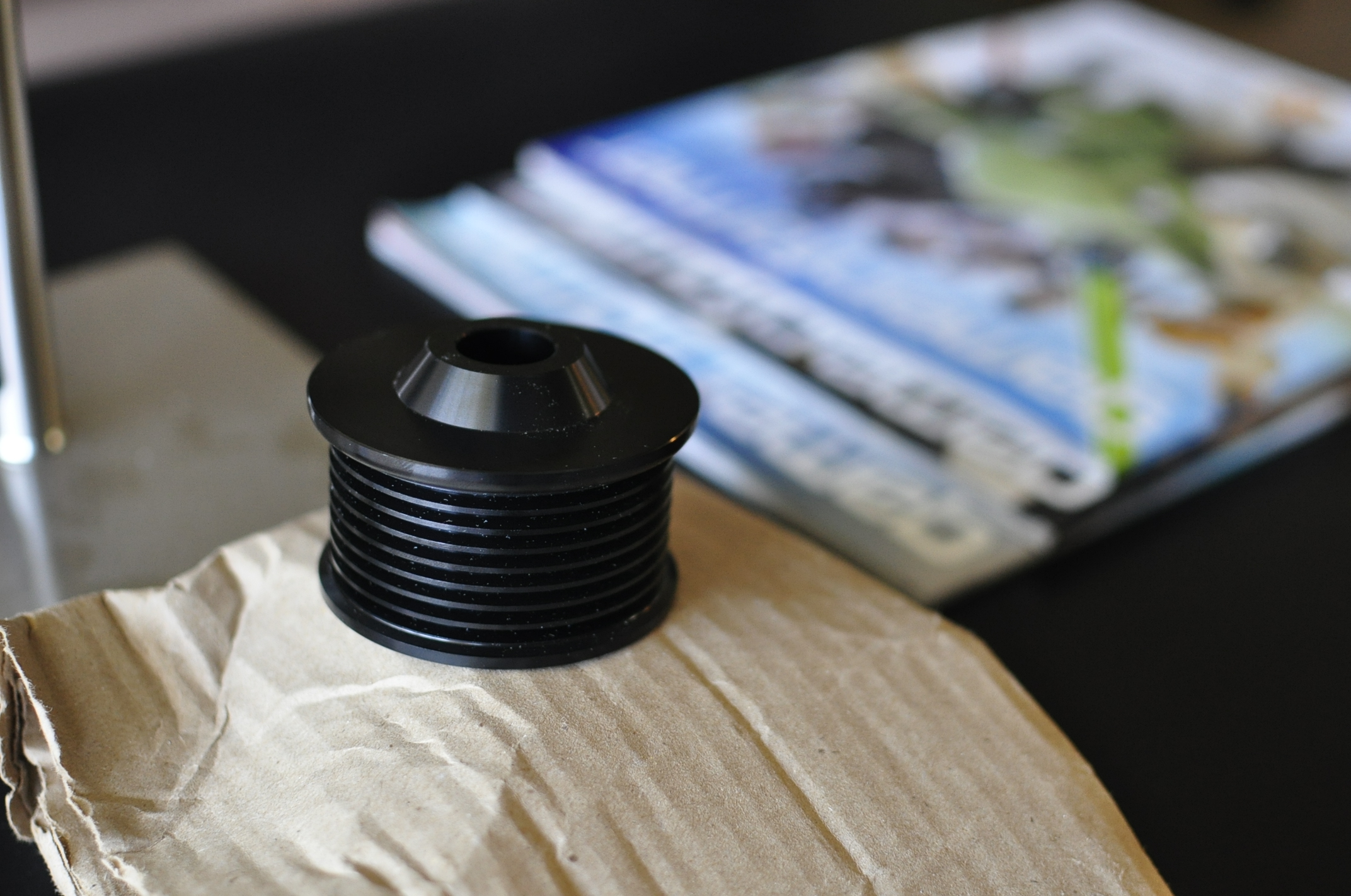

Also, I couldn't help but notice that your pulley and the pulley currently installed on Kyanite's car are both gold in color. Somehow I got a black one!
That's just in the way I heated mine first in the oven but it started out black. If you want it gold just bake it at 400 for an hour or so.

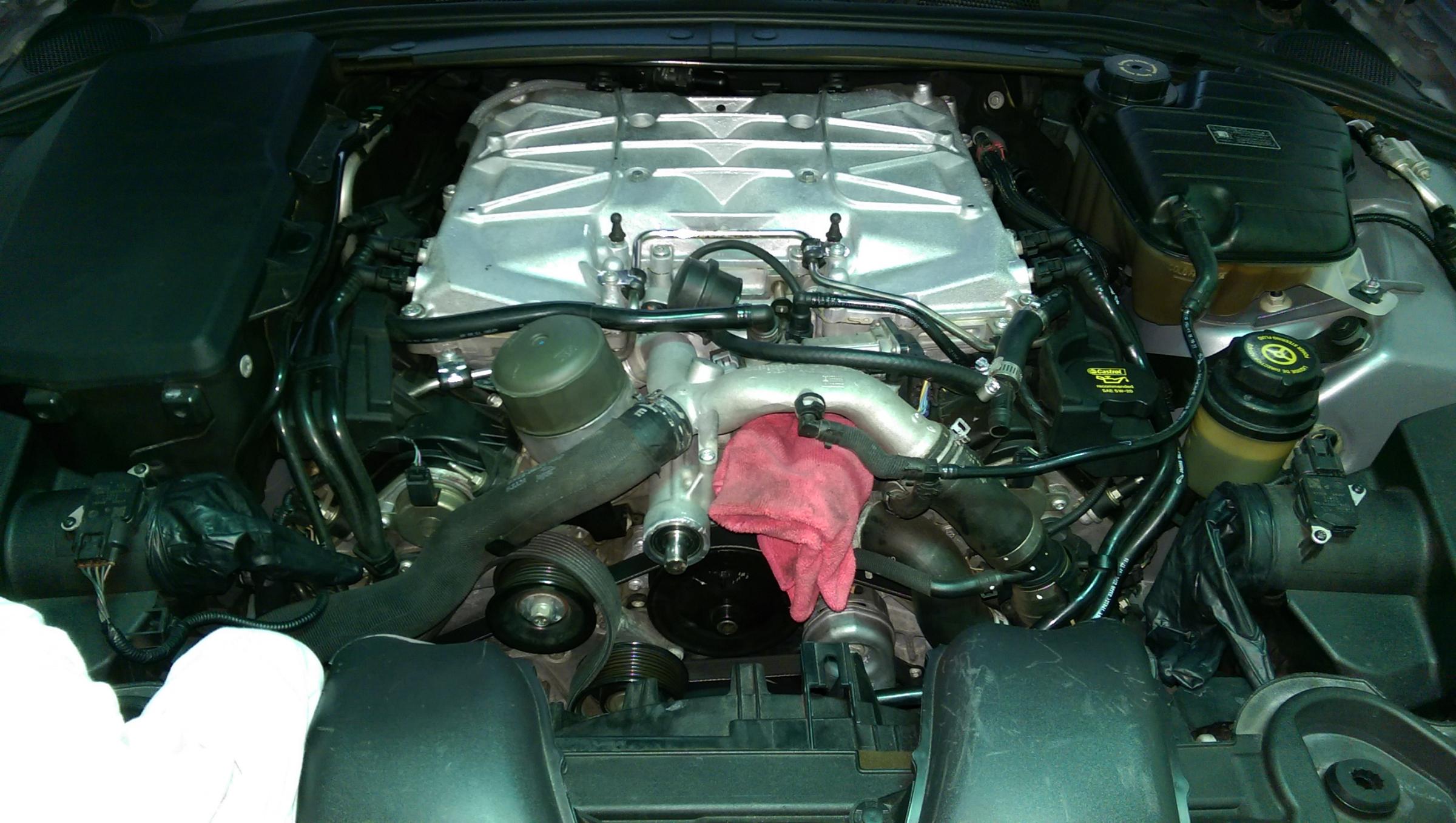

Did you find that baking at 400 worked well to just slip it on?
Doing this next week....
Old Jun 3, 2015 | 09:23 AM
Blackcoog's Avatar
Joined: May 2011
Posts: 1,099
Likes: 204
Yup, I swapped one on for a 5L guy a few months ago. Baking it works great. You have to make sure you get it on there quickly before it cools off. It has to be all the way on so the end is flush with the shaft end.
I also cut it off with an angle grinder. Be careful not to cut into the snout of the supercharger. Only the end of the pulley is attached to the shaft so if you cut too far in on the pulley you can cut into the end of the supercharger snout/bearing. Take it easy when you get toward the shaft. You don't want to cut into the shaft. You'll likely nick it no matter what. Use some fine sand paper to clean off the shaft before installing the new one.

My recent work....
