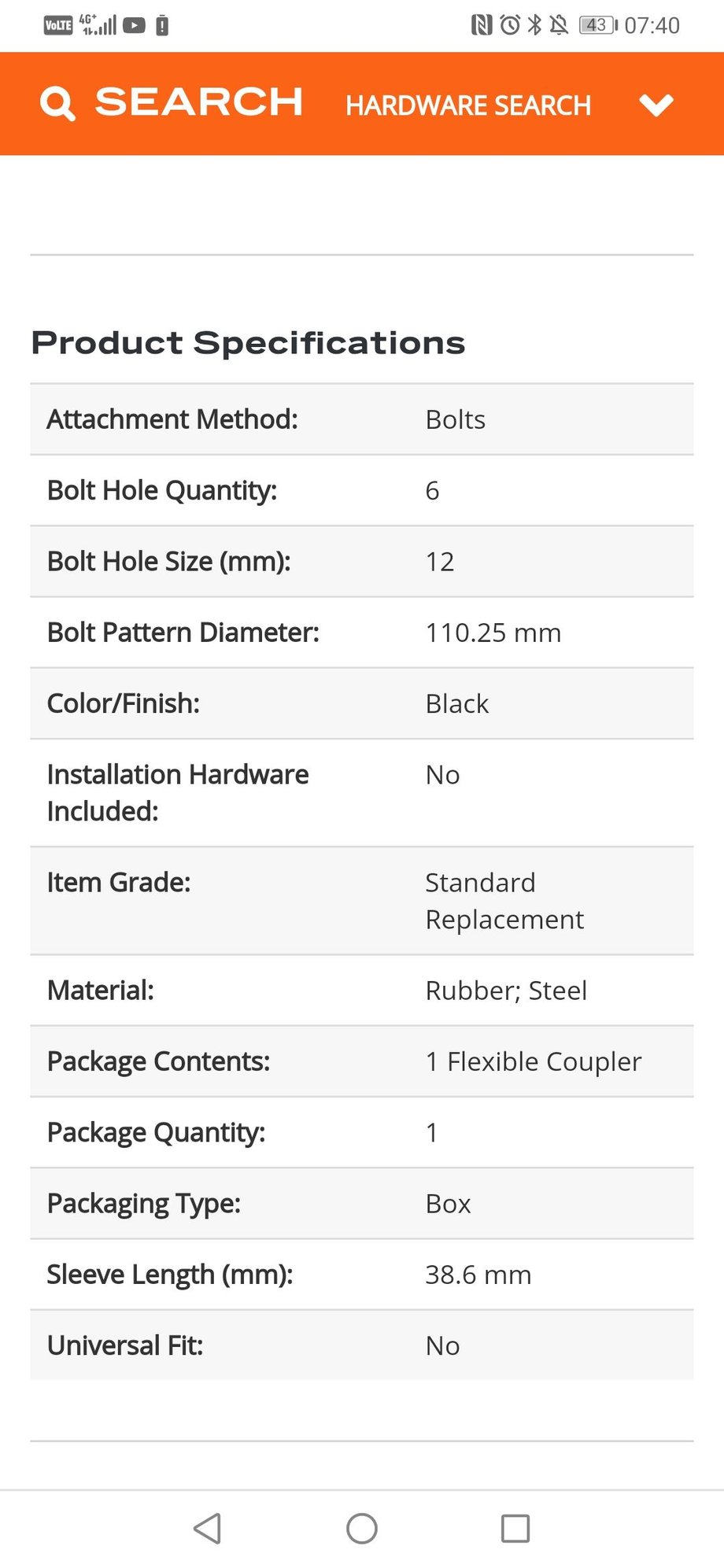

I found another brand (Dorman) with almost the same dimensions and fits most Cayenne's as listed.
Dorman 935-107
6 Hole
Bolt Circle 110.25mm
Bolt Hole 12mm
Bolt Hole Length 38.6mm
Question is, will I get lucky with this?

OK I have a positive update which confirms my research worked!
So I searched high and low for part numbers SGF GAP01-003 and then later GRA 003110. I only found old sites, overseas companies which no longer had stock etc.
So after confirming the measurements of the Dorman 935-107 part which was available on amazon, I took the plunge.
The package just arrived and I'm presented with this.
SGF part GAP01-003 after all!
So for anyone now on the hunt for one of these parts, I can happily recommend going for the Dorman 935-107
