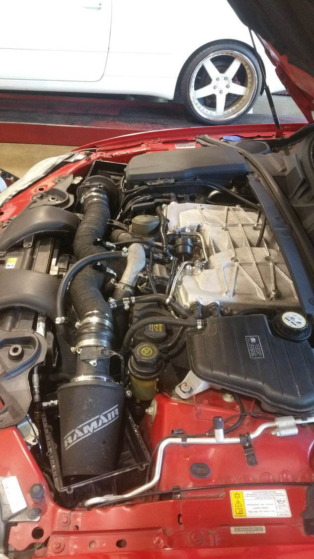

I decided to remove the metal intake pipe as it added no real benefit and potentially some deficit.

Have you had any issues, eg check engine with those pods on? I will be ordering the same intake but didn't think in removing the f/boxes! The sound is amazing on your car!

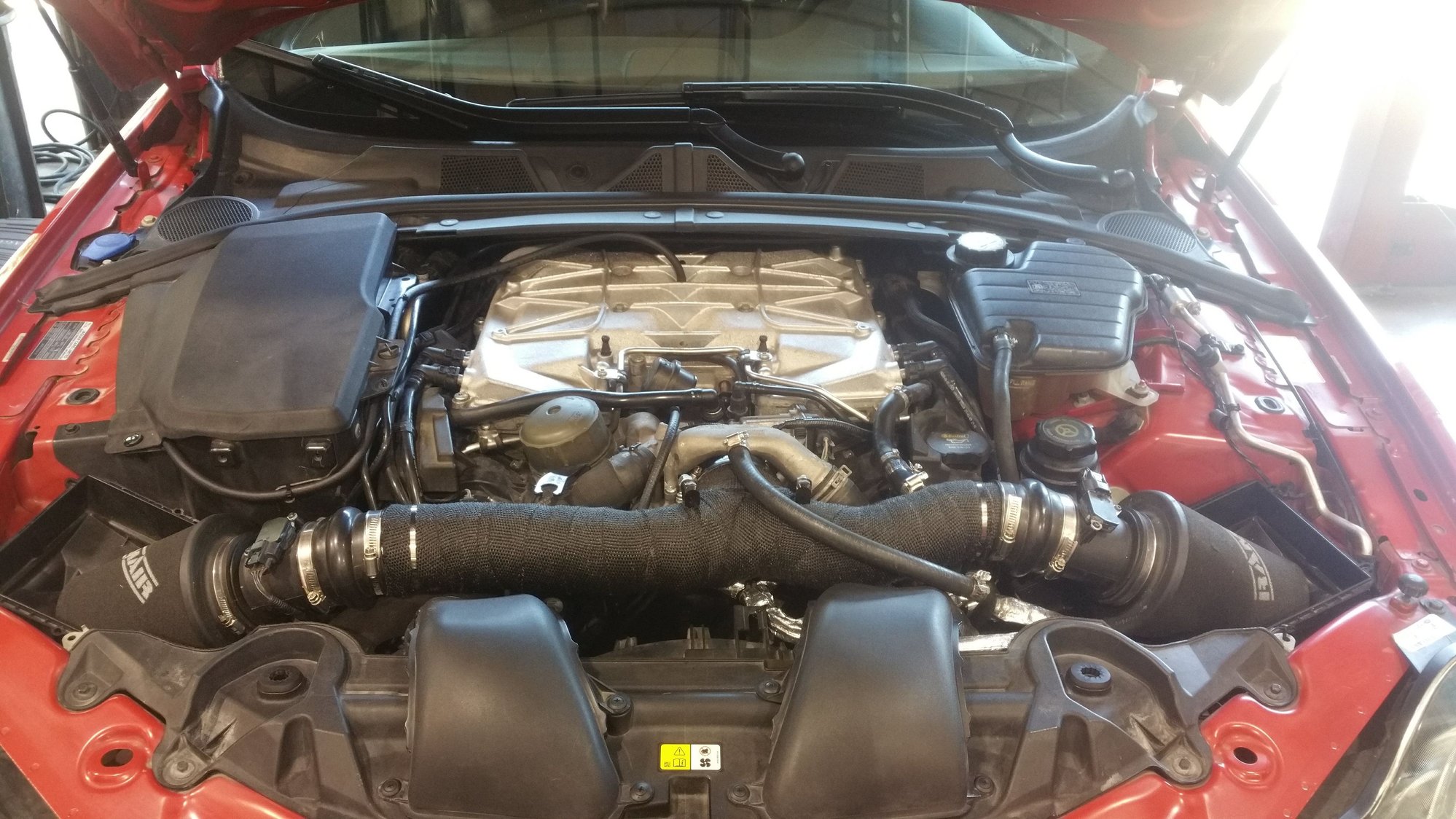

Funny you should ask, I've been working on an intake for the older MAFs that my car has.
These MAF adaptors pipes off eBay, combined with some M4x8mm screws, fit the older MAF sensors perfectly. And yes, the supercharger HOWLS with them on.
Next job is to fab up some heat shields and improve piping, along with additional Cold Air Feeds that I'm working on. I'd love it if someone could make a Carbon Fiber version of the Mina Gallery intake.

This This
is the Y-Pipe I used. I'm considering getting it plus the MAF adaptors ceramic coated to try and reduce heat soak but ideally I'd like the whole pipe in carbon fiber.

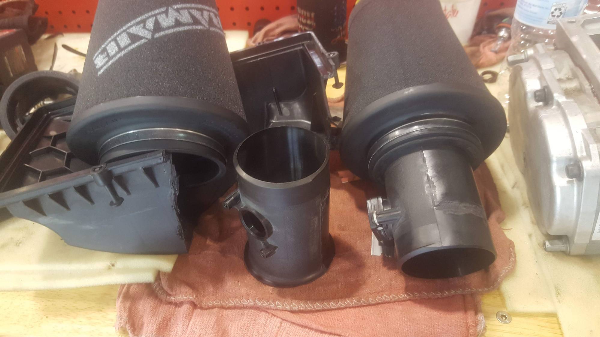

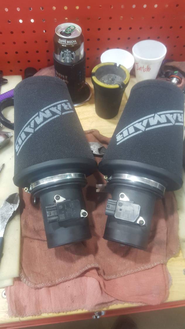

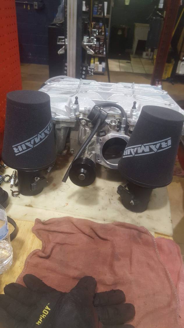

You can also just cut and modify the factory air box. This is more work and irreversible, but free at least.

Nice work! I considered doing this, but didn't really fancy the plastic welding (?) required in your 4th pic but mainly because being in California I needed to retain the original airboxes to swap back every two years for smog visual inspection Spares can be had off eBay but they're generally more expensive than the MAF adaptors.

No plastic weld, those were just the edges from where the original air box top was on the now separate MAF's. Are you not allowed to run different air filters or boxes in California even if they are approved?
