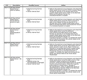

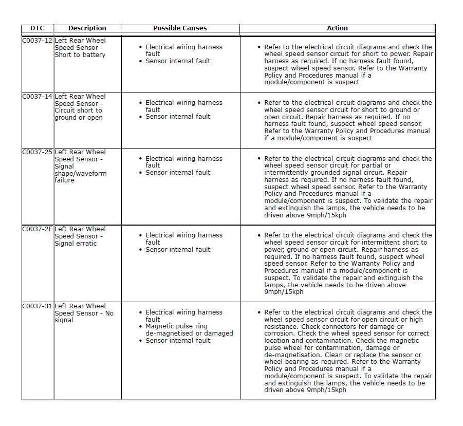

Modern Jaguars use extended codes and it requires dealer level Jaguar SDD (Symptom Driven Diagnostics) or equivalent to read them.
For example, C0037 is a Left Rear Wheel Speed Sensor fault but the extended codes give more information:
(double click on the image to enlarge it)
The 12, 14, 25, 2F or 31 help to isolate a harness fault from a sensor failure.
