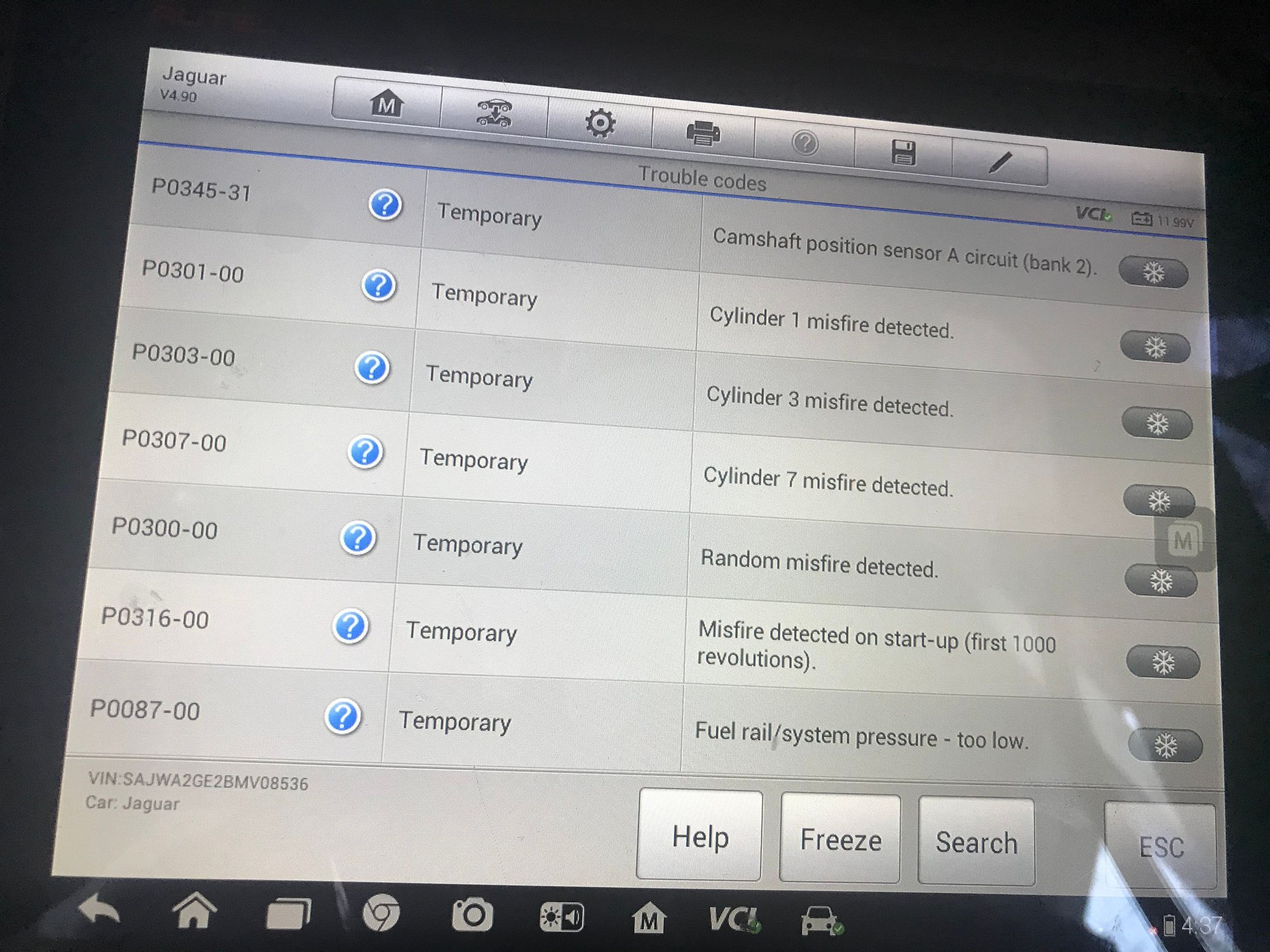

ok I’ll look there but I also have these codes and the car runs rough since it did start before blowing that fuse, I’m not sure if these codes are due to that fuse being blown or what.

Basically, I installed injectors which by the way were said to be refurbished, however the #7 injector failed, and loaded the cylinder full fuel in which hydro locked the engine which caused that 400 amp fuse to blow, so I replaced that injector with another changed plug and replaced the blown fuse and everything is as it should be now
