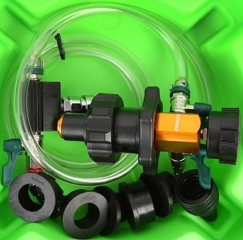

Another vote for vacuum filling. Again I post that I wish I had bought one YEARS ago. They are a superior way to fill and remove air bubbles. Since I got mine my 2014 XJR has not needed any top up and had zero air bubbles. Filling from the top with gravity guarantees you have trapped air.
But the kit shown above is not the one to get? That one depends on having the correct radiator cap and they include 30 or so different ones. Get one like this instead?
Vacuum Filler Vacuum Filler
See there are only 5 or 6 pieces. You need to understand how the filler works? It's pulling a vacuum which is exactly the opposite of what a radiator cap holds which is pressure? So all you need is a tapered fitting into the top of the radiator tank. As you apply vacuum it makes the fillers connection tighter and tighter.
