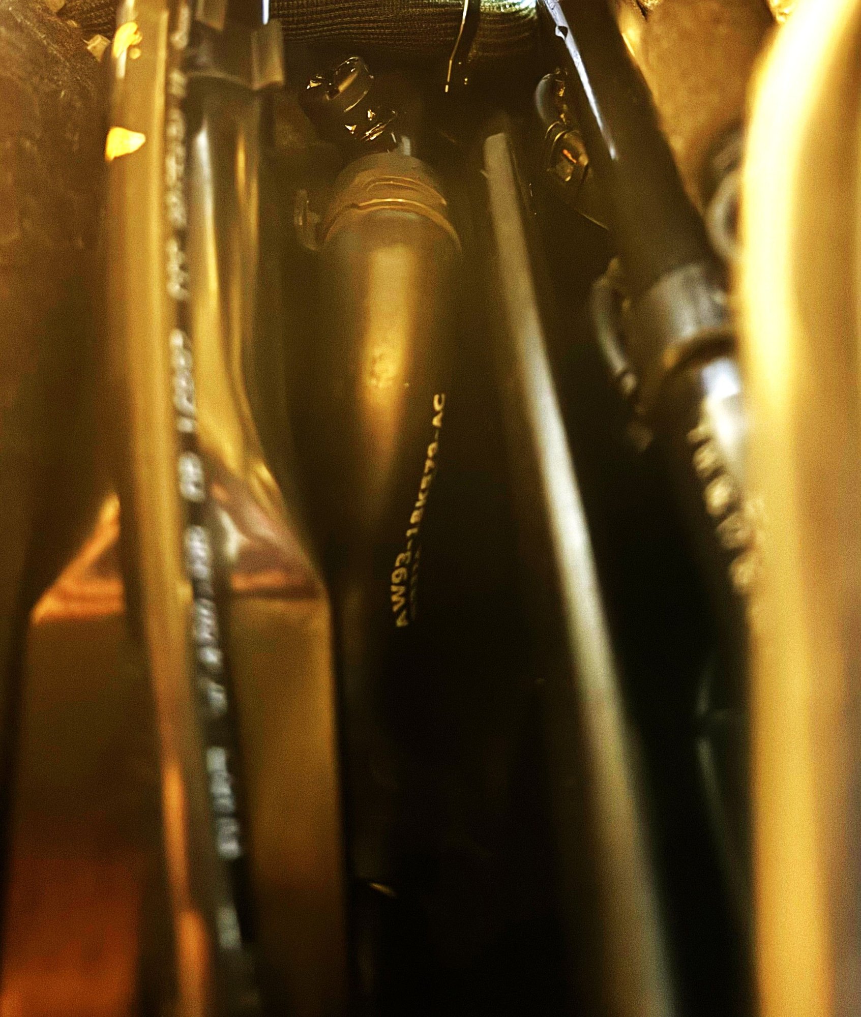

Originally Posted by lotusespritse
I checked my 2019 V8, and it does have a separate bleed circuit from the top of the front crossover pipe back to the expansion tank, so it doesn't need the bleeding of our 2014 RRS. Make sure your car has the bleed circuit to know if you need to bleed it, if you didn't use a vacuum bleeder.
Need to correct my statement above. I did find a coolant bleed screw in my 2019 XJL 5.0L. So you do need to bleed the coolant system using this screw, if you don't use a vacuum filler. I always use a vacuum filler, so no air came out when I doublechecked this bleed screw.
Location of coolant bleed screw on the right side of the engine for a 2019 XJL 5.0L

Great picture of the location of the bleed screw. Since it's black plastic it's easy to overlook.
I am a HUGE fan of my vacuum filler! Until I used one I just had no idea how well they work. Wish I had purchased one years ago too.
If you want to replace another bit of failure prone plastic there are metal versions available for not much money.
Even Jaguar (Well it's a LR part number) has FINALLY seen the light and has released a metal version. There are some different threads out there but it's a real common part that fits a lot of BMW's too. Dozens on Ebay and other places so easy to find.
I recently replaced mine. I was not too worried about it but did find several guys that have had that part blow out and fail. I figured it was cheap and real easy to swap out so I did.
Thanks for posting that new plug. I am going to get one. Although, I switch all my cars to waterless coolant, so there is almost zero pressure in the cooling system, which means no pressure to blow anything out, including the water pump seals. My 2019 XJL has waterless coolant, and it's running great.
