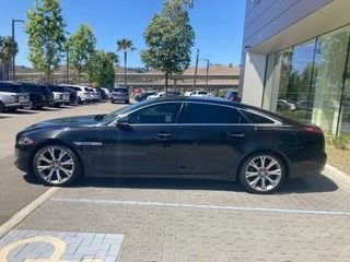

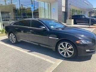

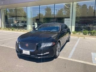

Okay group this is Mike from LA I just bought the X 351L with all wheel drive couldn’t get the supercharged I was trying to get it but I couldn’t find one that had less miles. My question is how can I make it faster and growl louder? Thanks in advance for your help and suggestions!
