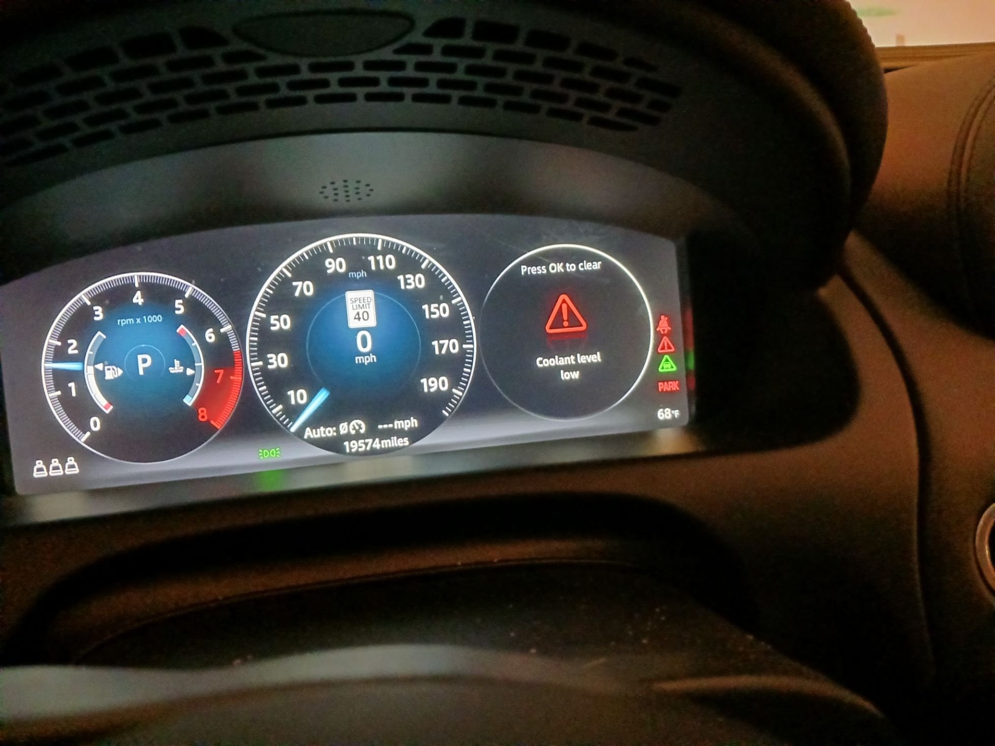

2019 XJL port.
I just got the car shipped from FL to LA less than 2 weeks ago. Every time I start it that warning pops up. I filled the coolant level fluid to the top line when vehicle is cold. The warning still come on. I contacted the sales person and he says drive it for 45 minutes to get the air out of the system and it will go out. I smell BS. I know it's probable the sensor so I think they should pay for it on the 30 day warranty. I'm basically left with the bag, I mean Cat. Any advise?

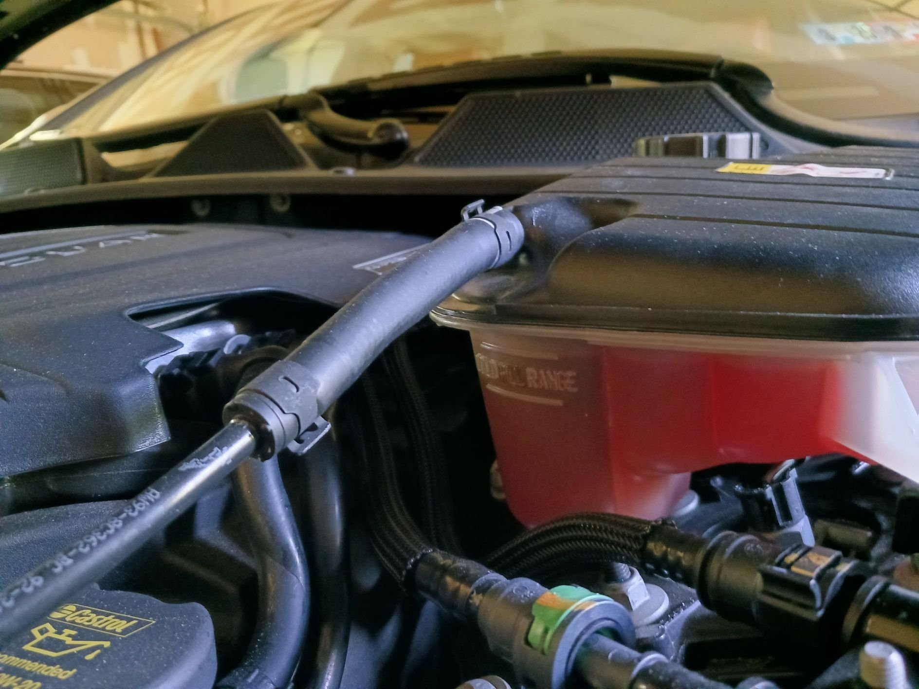

I believe there’s a bleeder on the passenger side of the engine bay back near the firewall (at least there is in my 2015). Wait for the car to be cool, crack that bleeder open or off and top off your tank until coolant comes out the bleeder and then lock the cap down. If it’s still reading low at that point the coolant tank level sensor has likely crapped the bed.

The sensor is definitely in the coolant reservoir (the one with the cap on it), so if the fluid isn't low in the coolant reservoir, but you are getting a low level light, then no amount of burping or bleeding the coolant system is going to fix the low level light. The sensors are a known weak point on these cars. It's not that big of a deal to put on a new coolant reservoir that has a new sensor built in. I am sure you will find plenty of threads on here and youtube videos to show you what is involved.

Yup, I had my tank replaced due to a bad sensor. 2019 with only 20,000 miles at the time.

You think if I get a long bar spoon, stick it into the tank and stir, will make the sensor float? LOL I'm kidding.
Old Mar 8, 2025 | 01:08 PM
Paldi's Avatar
Joined: Oct 2022
Posts: 179
Likes: 35
From: Malvern, Chester County, PA USA
Yes, I was able to lift the float using a stiff wire hook.
