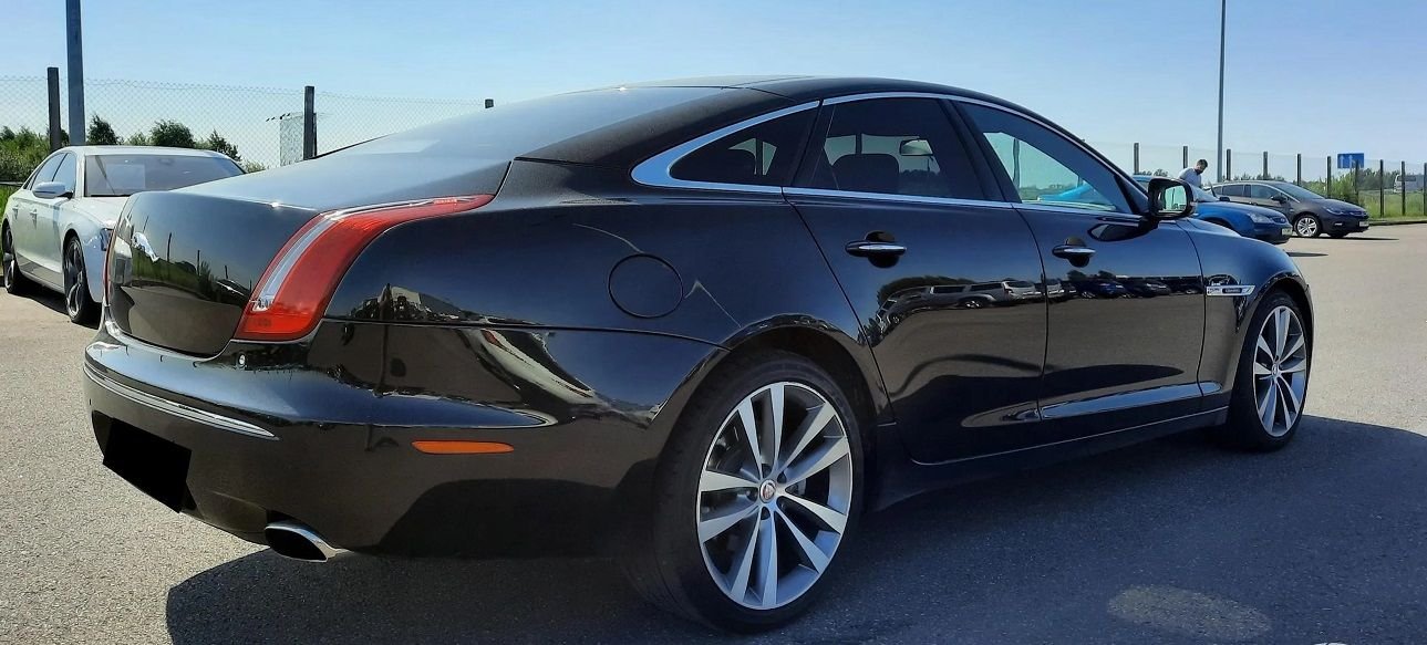

After posting some post i think it's time for a little introduction of my Jag. So instead of postting at the general forum i'm creating a post here, so i could update it from time to time with my X351 experience and problems getting more active responce from you, as this place is best for X351 owners.
So I am from Lithuania (Eastern Europe), always thought of Jaguar as greate car to drive and loving X351 design from the 2009 it was introduced.

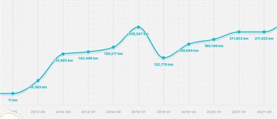

It had some accident in 2016-06, while it looks like many parts damaged, but damage was 1500-3000 eur. And after 1 month after accident 2016-07 it already passed the MOT. So damage shouldn't be big.
Then it looked like mileage has been changed.

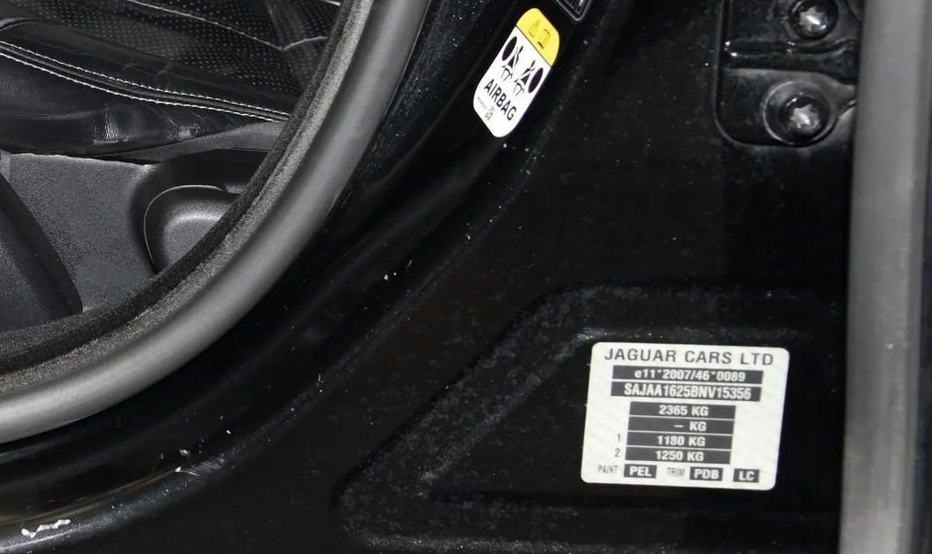

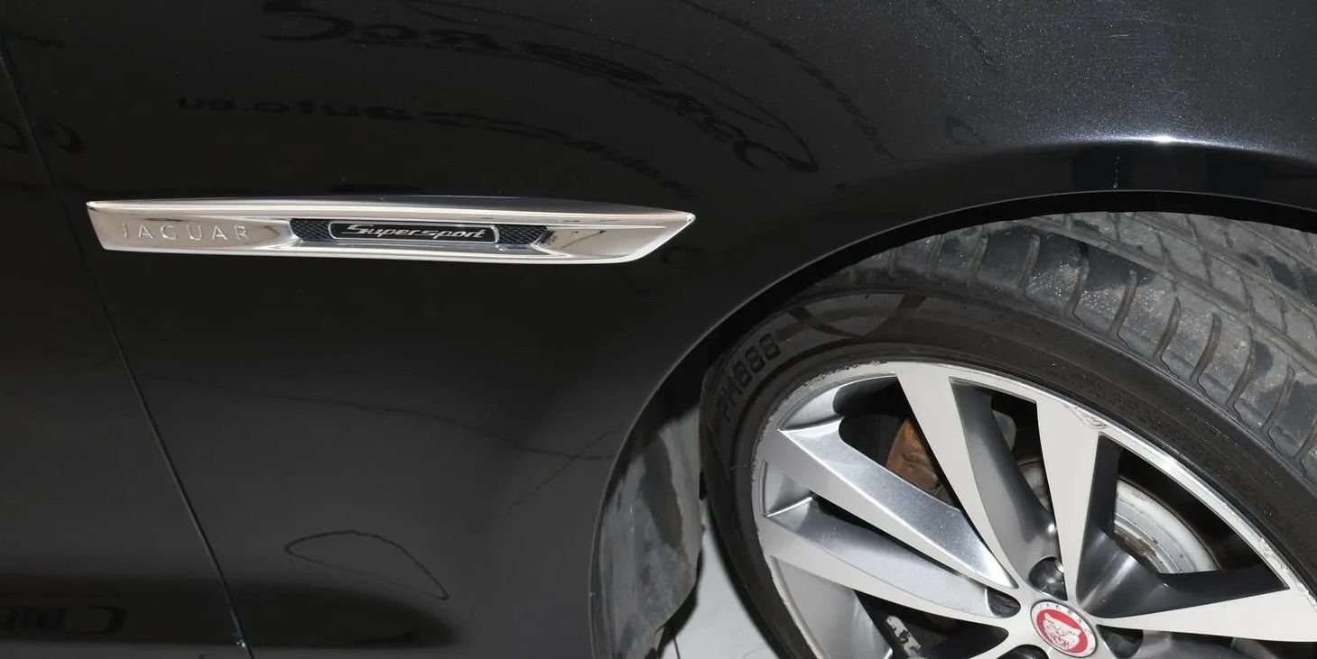

Dealer was selling it as Supersport edition, but i am not sure it is right. Probably fenders have been changed, as from interior trim, rims, interior setup it looks like it is Portfolio. As Supersport were only 5.0l models. Maybe someone could comment on that if i am wrong. And maybe it is possible to find info on how to read VIN code for this model, because as i know it always shows the manufacturer, model, edition, trim information.

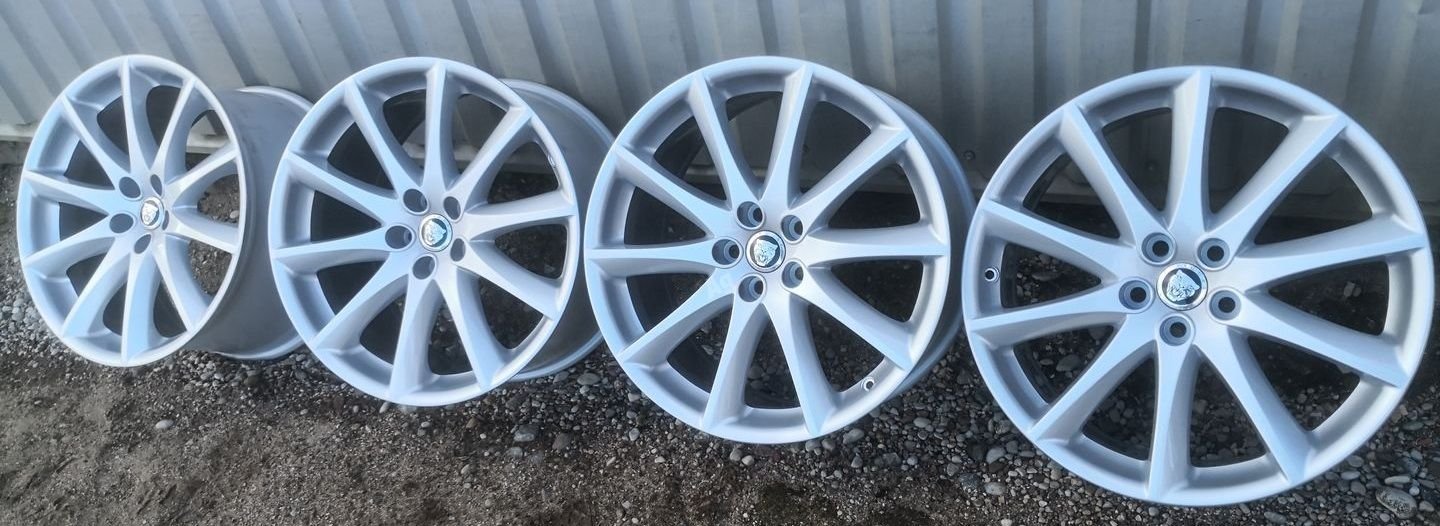

Additionally bought a set of 19" rims and new tyres for winter, chinesse tyre pressure monitor sensors (40 eur set), new key fob (40 eur)

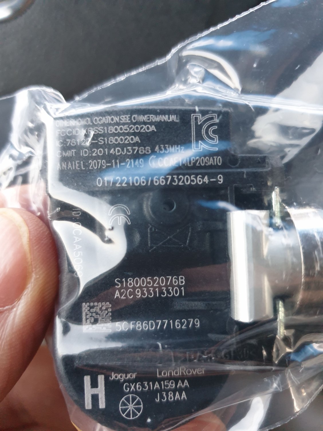

Got more questions about several issues i got with my car:
1. Tyre pressure monitoring system (before 2016). How to check if it exists and works? Should there be any menu options, icons on screen. I put the sensors on tyres, but cant figure out if they are not working, are they wrong model (there were two Hz options), or the system is absent on my model)

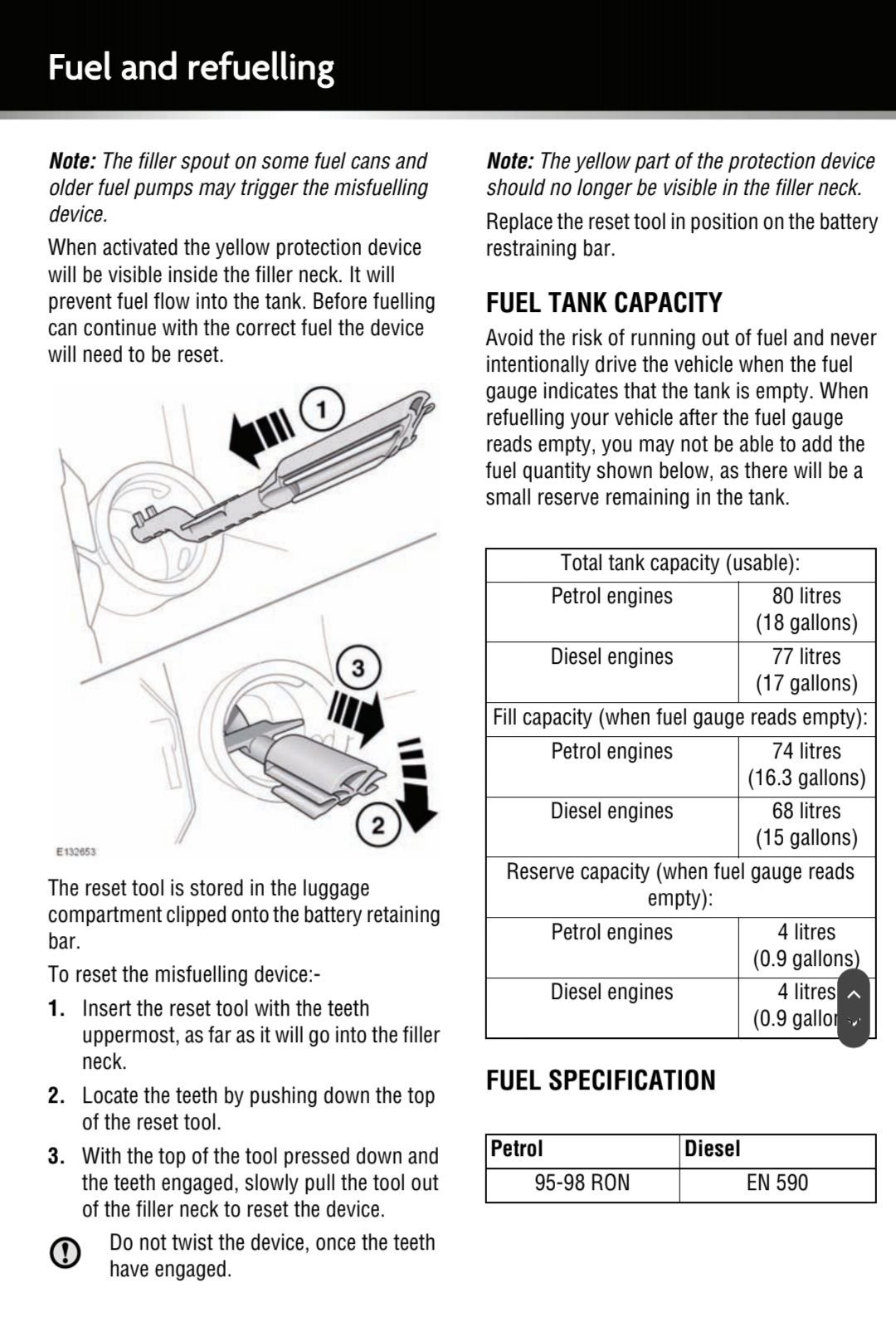

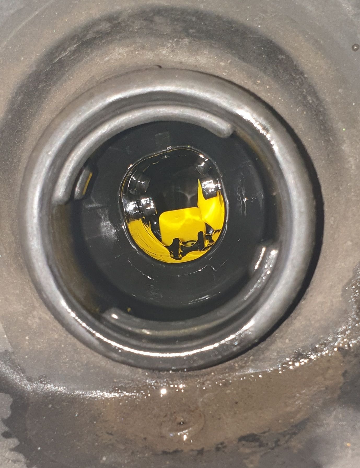

2. Fuel cap safety device. Noticed that i can not put fuelling pistol into it and saw the yellow safety cap.
The fuel is flowimg in though i have to hold pistol all the time.
can it be reseted without special tool shown in manual?
Yes. I had same problem. The solution was to use an old fork - just fit the two prongs of the fork so that they fit into the top holes and push them in.
