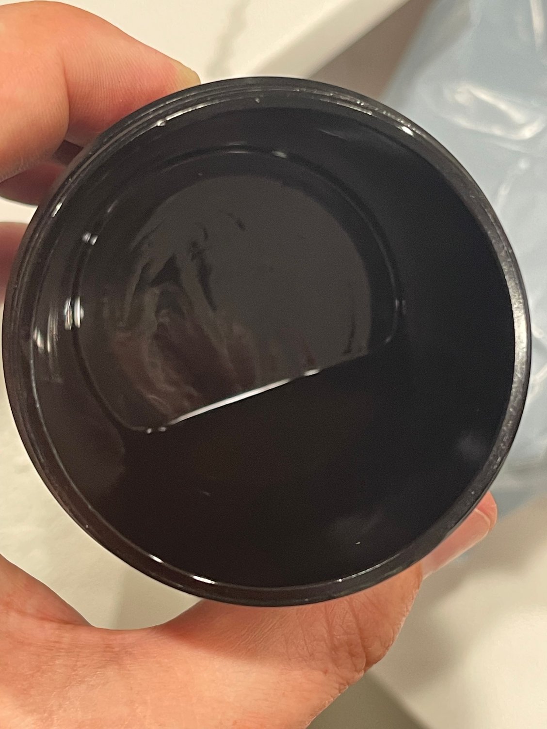

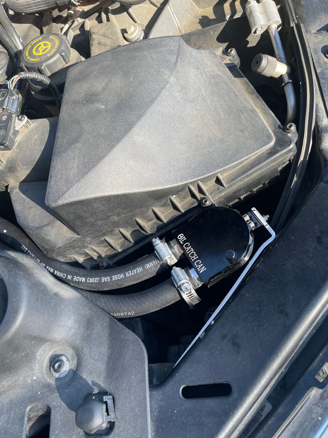

I have installed an oil catch can. I collect ~ 4mL a month.
As far as cleaner, I have used CRC 05319 GDI IVD intake valve and turbo cleaner in the past. It caused a little bit of smoke to come out the tail pipes upon first use. I tried it again ~ 8 months later and got no smoke. So the smoke likely reflects some removable carbon coming off the valves, but hard to be sure.

Images of catch can placement and volume of oil captured.

Thanks for the pic. That's helpful
