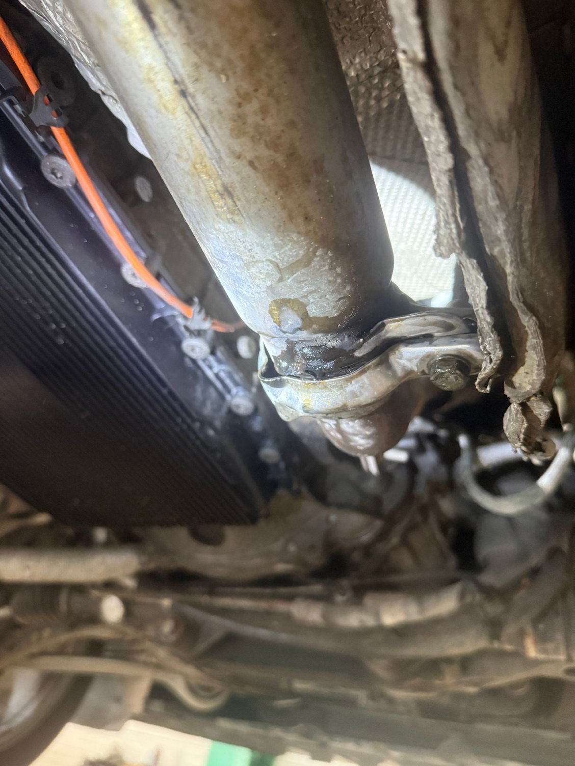

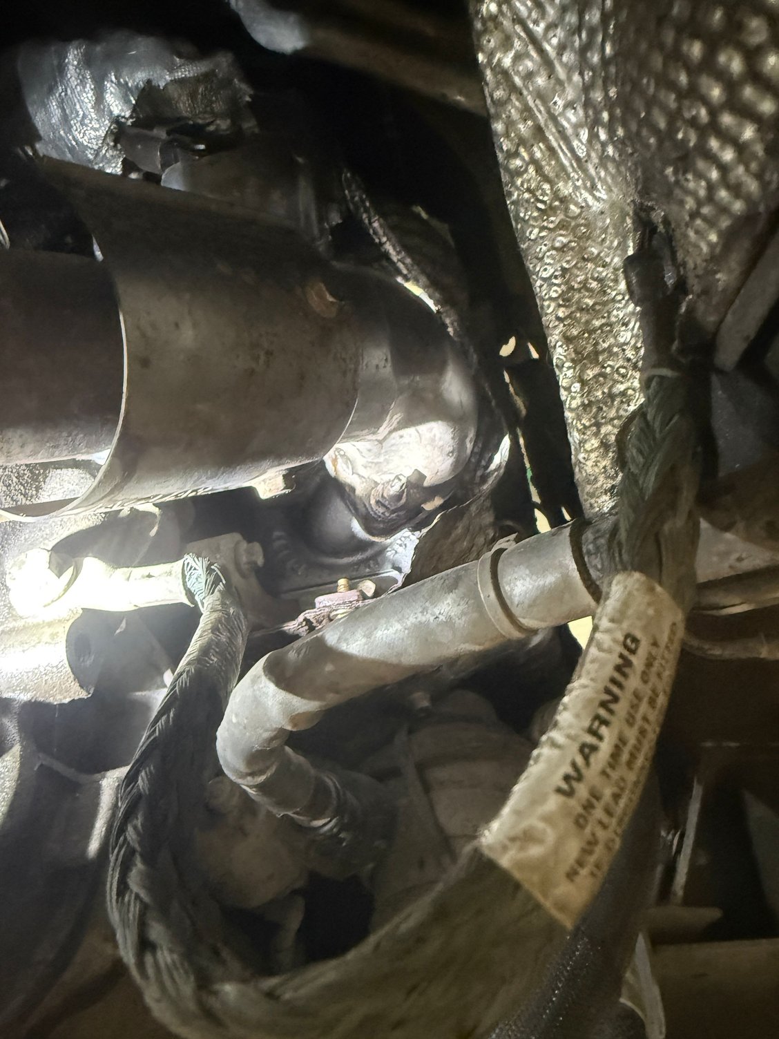

Old Jul 13, 2025 | 07:29 AM
  #50
danu99's Avatar
Joined: Jun 2023
Posts: 322
Likes: 20
From: Bucharest
Originally Posted by danu99
so…. A am going to follow up on my own post.
i got to the bottom of the problem with the smoke unde mu good, just in front of the deiver corner or the engine.
Its not a pipe! Its not the turbo i think . Its not the valve cover
its actually the basket of the valve cover. Febi i think it was, changes brand new in 2024!
could be a bad gasket, could be a “good mechanic”
In the red area, just as the cover stops, starts the oil spill! On the grey shield and down more
And a little bit of oil on the edge of the cover….moist of oil, just the contact surface of the cover with the block.
So…. From that is the white smoke, and weak smell on hot engine.
Curios is that it just sips… maybe bolts not tight enough! And as it sips down it hits something hot and voila…. Smoke!
This s time I used a mirror with light and adjustable!
Oil level is and was consistent the whole period. Spot on.
So…. Yeah!
hello. I just quoted myself.
U der warranty, the shop changed the gasket. Labor and gasket free. So….. Lets hope its ok.
But….
With jagggg there is always a but,
Kind of oily recirculation system. Not that it was squeaky clean before, but it seams it has some.…. Oil sweat inside the pipes???
With the mention that yes, the passenger side turbe is wet on dpf side at the connection with oil. 500-1000 km after refurb.
Just under the turbo, first connection and the second under the car, towards dpf.
I can see a slight change in oil level, one increment level down, but might be oil left up in the engine
So…. 2 questions.
One. Beside bad refurb, what are the reasons why a turbo would get bad that fast. Basically, after refurb? A bad front near the radiators electric egr valve that I changed already and unequal pressure that affected this turbo?
A bad outlet oil pipe…. Not correct shape after instal?
I saw a similar problem on a range v6 diesel, with a bad design out oil pipe from turbo, and they made another one with a different point of access (another designed hole in the engine) that replaces the Standard one! Do you guys know something about that?
Any other reason?
Still.…. No smoke, runs ok, …. Dpf not with any sighns, no errors in the engine area!
The fact being that in.….500 km, the leak from turbo and exhaust linkages stayed.… pretty much the same. Guess…. Being hot side, if had encreesed, smoke would should appear under car or exhaust! At this moment…. Nothing. Did clean it with brake spray…. And will see!
Second one, how much fora refurb complete turbo in uk? A good job refurbing it also! And turbo related, out oil pipe, may not discharge oil in engine because oil level is one increment down from maximum? Could discharge pipe be…. Fighting with pressure from engine level and not free flow??
Anyway, driver side turbo is ok. No leaks no nothing.
Hope you guys can help with advice about why that one is leaking.… or its just a bad refurb turbo.
